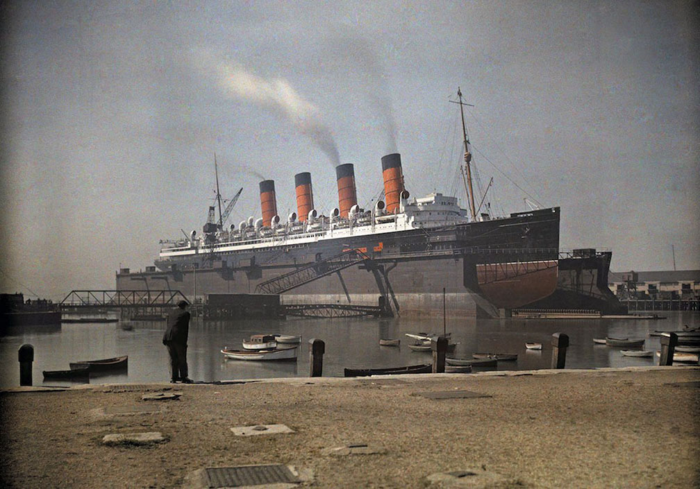

I thought this photo might be of interest here. I found it while surfing one of those way-back type sites. This is a real color photo via the Autochrome process, not colorized, from a National Geographic collection. Note the floating drydock.

Great photo! Haven't come across that one before. Thanks!

Wow - how did I miss this before? What a great photo.

Isn't it, though. I completely forgot about that post until this thread popped up again.
