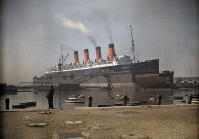

I thought this photo might be of interest here. I found it while surfing one of those way-back type sites. This is a real color photo via the Autochrome process, not colorized, from a National Geographic collection. Note the floating drydock.

Great photo! Haven't come across that one before. Thanks!

Wow - how did I miss this before? What a great photo.

Isn't it, though. I completely forgot about that post until this thread popped up again.

This photograph is taken in Canada Dock in Liverpool, 1909.
The gentleman in uniform is “Mauretania’s” first Chief Engineer, John Currie.
RMS Mauretania was one of the most famous ships ever built on Tyneside.

Interesting picture, eh? The two outboard propellers have already been replaced by four-blade inward turning screws, the two inboard propellers still have the original three-bladers turning outward! These would be replaced later by four-bladers as well (also turning outward).
