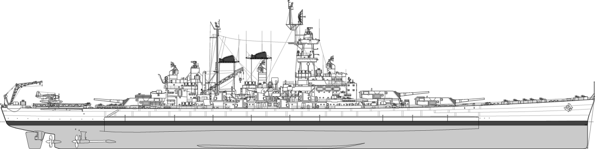

Unless you can come up with some better data! It gets a little interesting when painting a model to incorporate the taper! I had to wedge the bow and stern variously a little when scribing the lines for the boot top.

In the original plans, the boot topping is 17" above and and 5'6-1/2" below the design waterline at the bow and 17" and 12-1/2" below at the stern.
The waterline is 34'7-1/4" above the baseline (34'9-1/4" above the bottom).
I know I found some later diagrams showing the boot topping at a later date but they are somewhere in my massive sorting stacks.
The center of buoyancy is aft of the center of the ship so there is more movement at the bow.

Fliger747 wrote:Somewhere in this thread, in a time long long ago, this subject was discussed in some detail. As a note, I believe that the boot topping on the Iowa's (Which has moved around a bit, especially at present) tapers toward the stern and is not as wide there. The apparent reason for this is that there are much more "consumables" loaded forward and the bow will tend to rise more than the stern at a light loading. This is probably an intentional design as the hull has little volume aft below the waterline due to the tapering and shaft tunnel between the skegs.
Good luck!
One reason why the draft at the front of Iowa changes much more than at the back is because of the hull form. How much draft changes when weight is added or removed is proportional to the area of the waterplane. US fast battleships had highly assymmetrical waterplane shale, with extremely blunt and fat aft section with a lot of waterplane area , and long tapering bow entrance with little waterplane Area. This is probably a major reason why Iowa class has much more variable draft in the front than in the rear.

Hellochuck wrote:Fliger747 wrote:Somewhere in this thread, in a time long long ago, this subject was discussed in some detail. As a note, I believe that the boot topping on the Iowa's (Which has moved around a bit, especially at present) tapers toward the stern and is not as wide there. The apparent reason for this is that there are much more "consumables" loaded forward and the bow will tend to rise more than the stern at a light loading. This is probably an intentional design as the hull has little volume aft below the waterline due to the tapering and shaft tunnel between the skegs.
Good luck!
I am working also in the other two classes. Is the boot topping also tapered?

I checked out the drawings in Garzke and Dulin and no taper is shown. But... The drawing for the Iowa's does not show a taper either.
