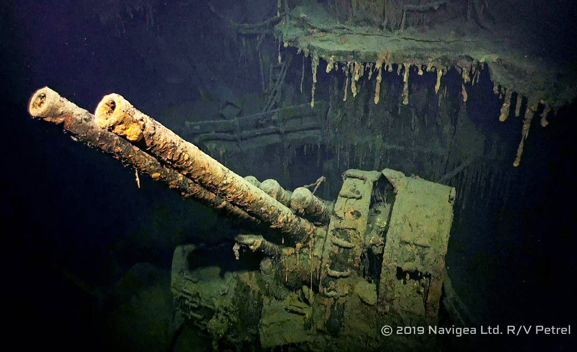

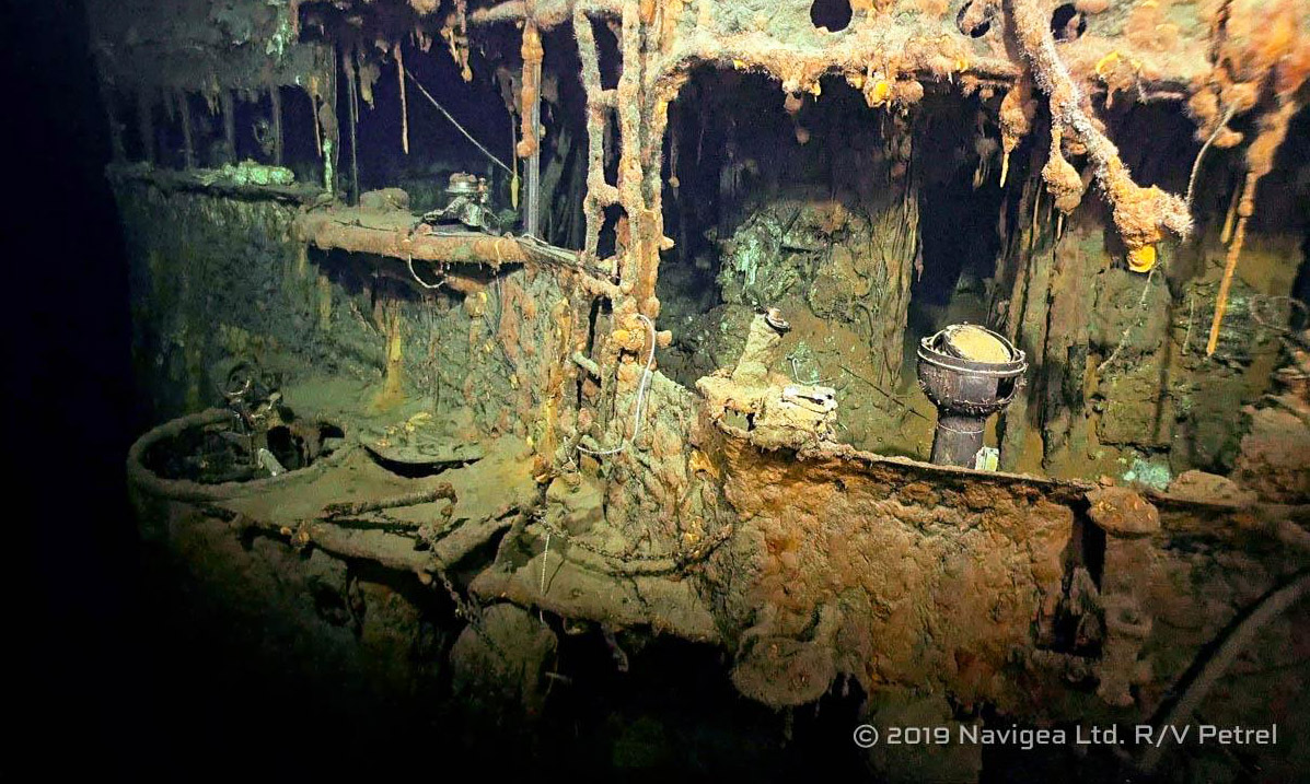

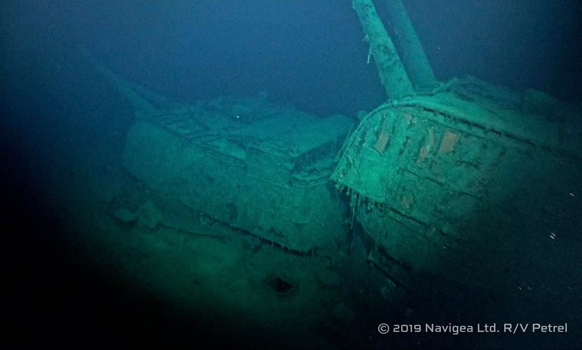

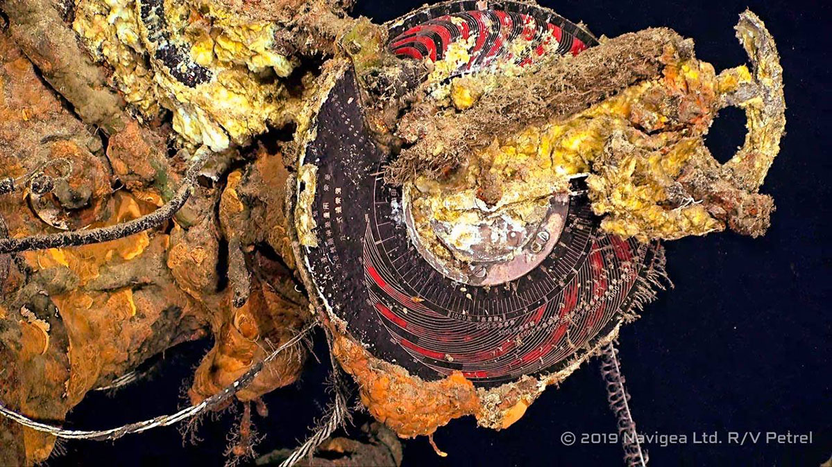

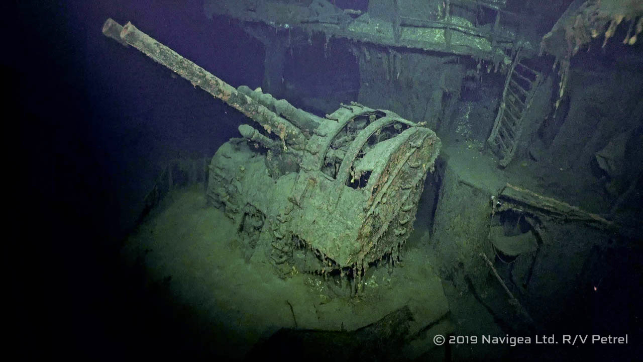

M/V Petrel found Maya off Palawan on April 19, 2019 about 1850m deep. Pics posted today. These views have been slightly cropped and lightened.

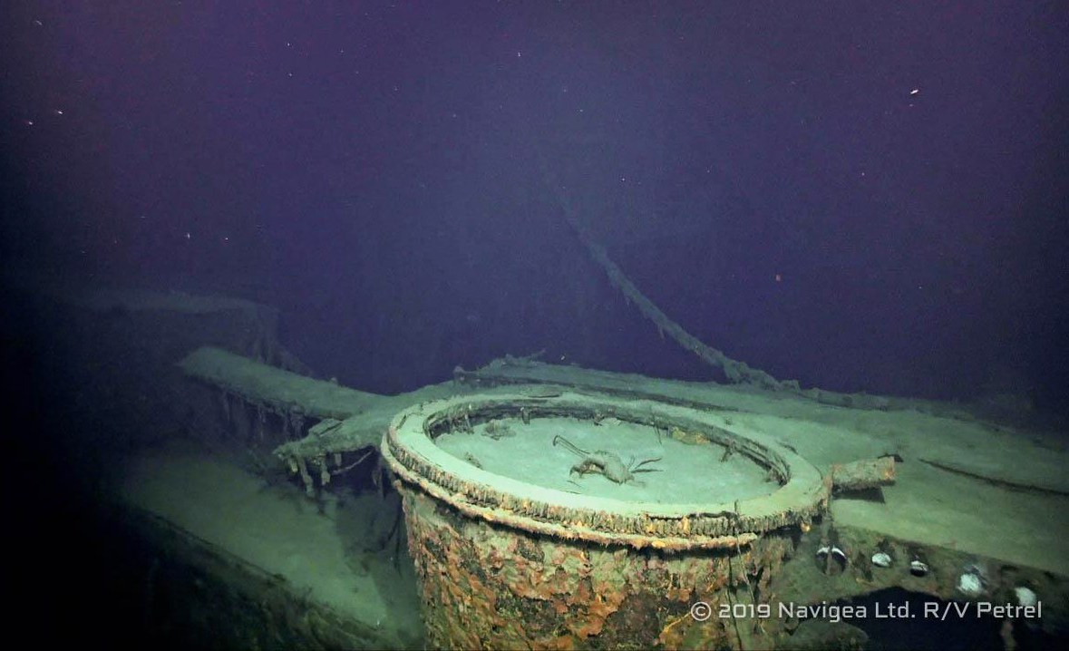

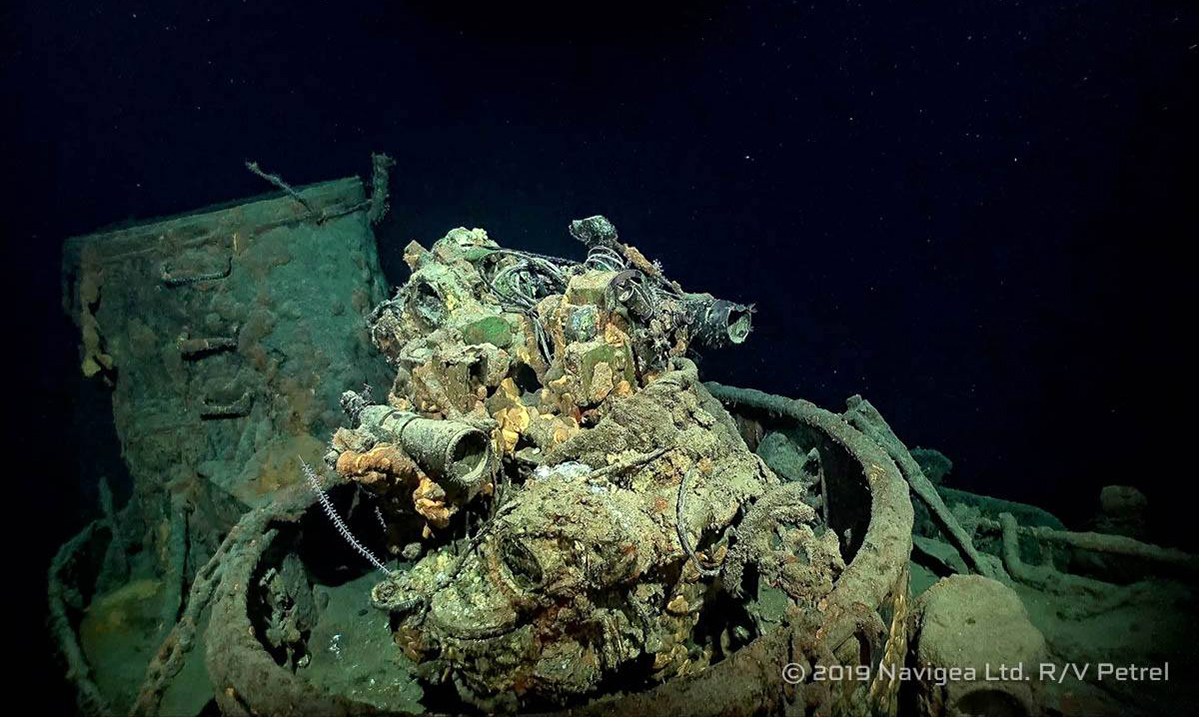

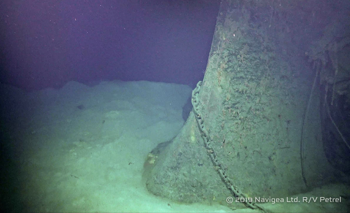

Based on what I see at the stern, and possibly the bow, I see no trace of a degaussing cable.
Maya, triple 25mm mount, starboard side, with anchor chain draping.jpg [ 315.3 KiB | Viewed 5363 times ]
Maya, catapult base and sponson, likely port side.jpg [ 330.67 KiB | Viewed 5363 times ]

No degaussing cable, shaved number 1# turret's rangefinder and no training aiming devices on top of turrets. We where right all along... :thumbs_up_1:

It appears that #5 turret may also have had its rangefinder arms clipped.
I'm pretty sure that the catapult base and sponson are from the port side, and that we can see the edge of the aircraft handling deck on the right.

The range finder hood of nr.1 gun turret was shortened after the finder was removed for all 4 sisterships, starting from March ,1942.
Wish someone had hawkeyes, then you´d be able to see remains of degaussing cable stoppers---at stern
Truly the portside cat mount here..
It is most probable that they were keeping on training 3 days before the start of unloading flammable materials and training gears to be stored ashore. Until then ships were considered to be fully loaded with those things, incl. gun sigting training gear and it´s container boxes.
I´m not sure if there was range finder on nr.5 gun turret from the commisioning and thereafter.... I rather suppose nr.4 gun turret shares the range information with nr.5.

the hull around turret 5 seems to have collapsed, leaving turret 5's barbette standing by itself.

Full video posted on the Petrel FB page. She's in amazing shape, considering:

Those 8 minutes are not enough.. dang it. It's fascinating to see her bridge standing and even the main mast still there. I think one of the most impressive things that we get to see now is her new AA structure that replaced the damaged turret, something that was only seen in 2 pictures i believe. I also find fascinating how the main and DP guns are aiming up. Was this caused by the decent of the ship?

Probably not...the ships were steaming into combat, so the guns were probably loaded and ready for action. More than likely loaded with AA shells, hence aimed upward.
You´re absoluely right about it. IJN had alert phases 1 & 2 where AA guns and main guns must be ready to fire at any moment if enemy appears suddenly. We call it "Tossa-shageki" ⁼咄嗟射撃。For this half of them be ready to fire, the other half at standby position(incl crews taking rest etc)
