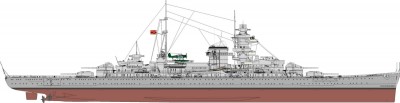

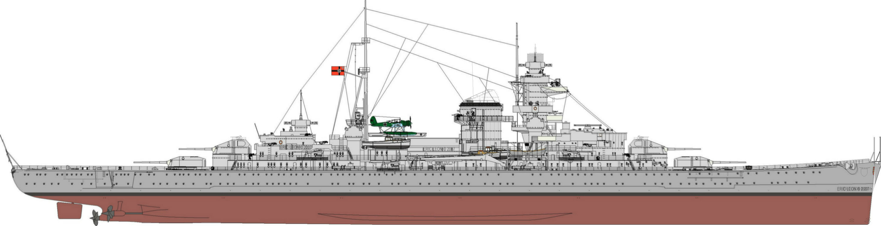

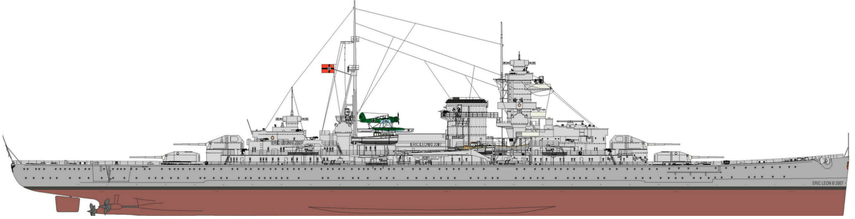

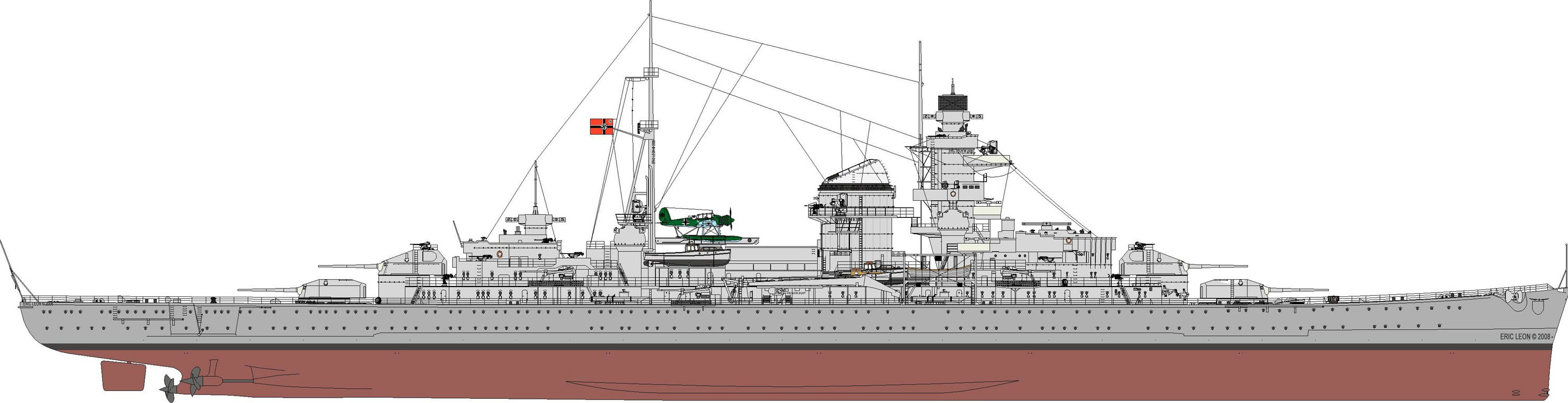

As for backdating Hipper to 1939 from 1940, my very crude fast first research shows that I need to chop of the nose for the profile ( no need to lower the deck). See pics attached from Eric Leon, they are scaled as closely to each other as I could do on laptop, but shows fairly small difference (same anchor positions etc).
As for the flare I don't know. Probably there is SOME difference but is it enough for 1/700 scale to be worth the hassle of making changes to the deck and hull? Smth tells me this was just an addition of the bow like on Lutzow exDeutschland with minimum flare, sort of version 1.0, where there was not huge amount of new flare. And to continue this example, the Prinz Eugen and Blucher bows were similar to the bow on Admiral Scheer post refit (a full rebuilt with significantly more flare etc). Makes sense? ... How would you go about removing the stem tip and flare yourself, assuming the capstan and anchor positions remain?...
And then just remove the funnel cap and some radars and AA guns, voila a nicer looking (IMHO) cruiser with beautiful straight stem.

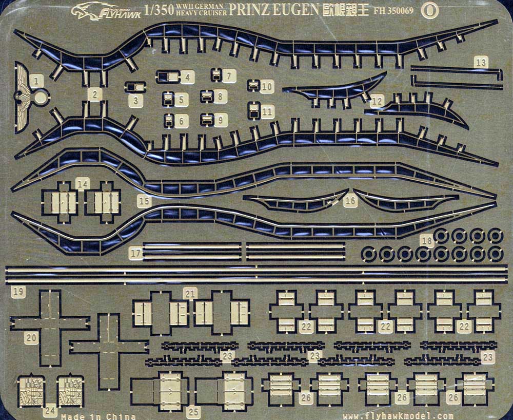

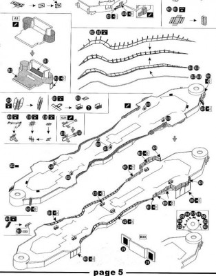

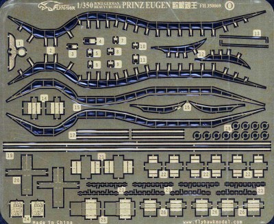

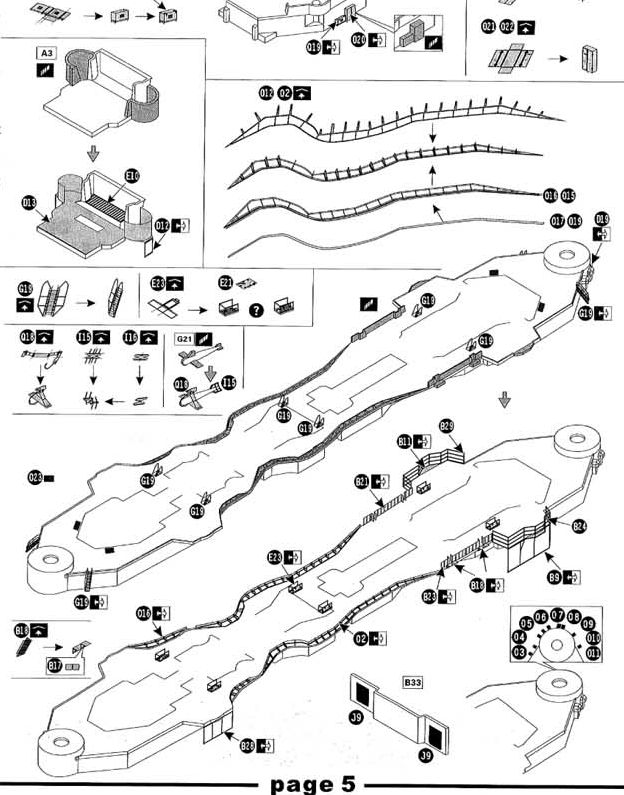

Ive just started my 1:350 trumpeter Prinz Eugen with the Flyhawk PE kit and im having some issues interpreting Flyhawks instructions.
Is someone able to explain how the torpedo reload tracks are to be fitted?
the Instructions show parts 17 & 19 as curved, yet they are straight on the fret, do these need to be bent? and i cant for the life of me work out how the assembly is then attached to the deck itself (after removing the existing molded track)

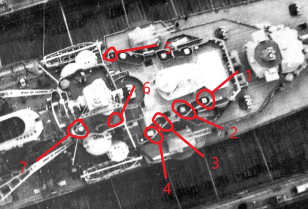

To start with, I would like know what these are. I have some sources telling the following:
1. Torpedo directing unit
2. Zielsaule C/38 night director
3. ?
4. ?
5. ?
6. in Trumpeters model looks like here should be binoculars
7. Looks like ZAG flak director
