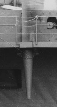

Four ant. on port side. They look as if they must fold over to clear flight ops. Trying to find photos showing details of the fold mech. where they are hinged into the catwalk.
Any takers on this one ?
Thank you,
Keith
Thank you,
Keith
Tracy White
- Posts: 10628
- Location: EG48
Re: Calling all USS Independence class (CVL) fans
Hinged just under the catwalk with a counterweight. Small section of the catwalk turns with it and is replaced with another section mounted to the antenna side.

keith t bender
Tracy you are the man, thank you. I would imagine the lower part, cone, is if not solid then very close to it to act like a counter weight.
Keith
