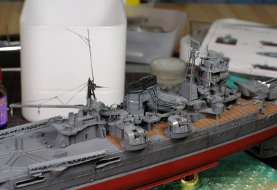

Actually, Tamiya erred with its 1/700 kit, yet corrected properly with its 1/350 kit. The linoleum extends aft to where the mainmast and aft boat storage begins. You can just make it out in the attached image of the 1/350 model.

I see, i always thought that part of ships is wood, i need more research into ships. Any idea how to fix/remake it?

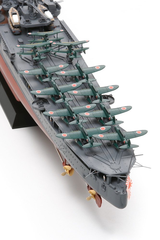

Well, I would carefully mark the dividing point between the end of the linoleum covered area and the start of the treaded steel. Then, I would scrape off all the treading from the linoleum covered area, probably lightly sand it as well. Then decide whether or not you want to depict the brass tie-down strips. Truthfully, these are always over scale in 1/700 (the real ones were barely an inch wide and a 1/4" high). Then paint with linoleum colored paint (Tamiya Acrylic XF-79 Linoleum Deck Brown is an excellent match).
Here are two pics to help show the delineation between the two surfaces. The model is from a Japanese modeler's site: http://d.hatena.ne.jp/hakurai/20120603

Thanks for the tip and the reference! It will hard to scrape it with details around the deck and i've already glued the AA and boats, but will try anyway.
