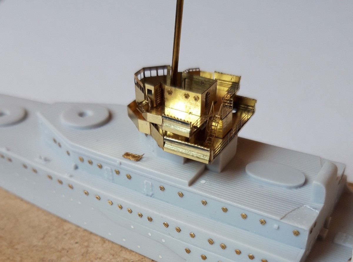

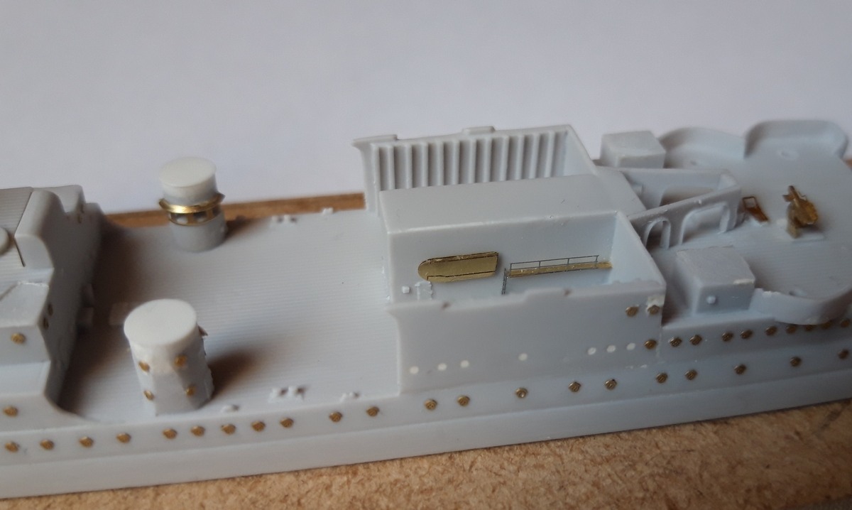

After some testing of my PE parts I came to a conclusion they needed a second attempt. I needed to adjust positions of holes for both tripod masts (it was not a good idea to rely on Profile Morskie plans in this very respect � although I admit they were quite fine in general). I created a simple 3D model for this purpose in the end. I also wanted to add some more details and I had some more findings in the meantime (like about hangar doors discussed in the CASF Northampton class thread).
While waiting for the second version to be etched I worked on adding portholes to the hull and hatches to the deck. I scratchbuilt two large mushroom vents on the stern and used Rainbow brass parts for the smaller ones.
Only after I modified both catapult towers with correct windows and brims above them from my PE set I realized the towers were about 1mm too short for PE catapults to be used upon them! I had to add plastic sheets on top of them to compensate for the height of the original resin parts. Unfortunately it was already too late to reposition the windows higher as appropriate so they had to stay. I also dremelled out two small recesses on the extended forecastle under front ends of both catapults to allow clearance for them.
I want to show one of the two hangars open with a SOC-3 with folded wings inside so I built some internal detail and provided for the PE folded wings.
I drilled out both funnels and readied them for adding PE dividers into them. I also realized that � contrary to the resin part � tubs for 1.1in Chicago pianos aft of #2 funnel should be lower than the upper 5in deck, so I cut them off and removed about 0.8mm height from their bases. I removed all 5in ammo boxes that will later be replaced with my PE parts in their correct positions according to photos.
When the second version of my PE sheet arrived earlier this week I turned to building the main bridge. I started with positioning the forward foremast pole that forms the centrepiece of the bridge. I kept on adding bridge levels while documenting the advance. I designed the front face of the bridge in one piece without separating it into two parts horizontally. Adding the compass bridge floor was a bit tricky but it turned out good in the end. I really like how the wind baffles look like.

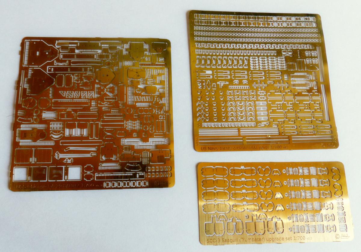

First of all I forgot to add a photo of my PE sheets version 2. I separated them into three sheets: USS Chicago 1942 specific parts to the left, Miscellaneous USN Treaty Cruisers parts (early WW2) to the right and SOC-3 parts (upgrade to Trumpy) bottom right. BTW I think they might be useful for modifying the Tamiya USS Indianapolis kit into Chicago, too (provided you won�t mind the 3m difference in hull length):

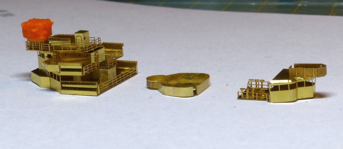

Next came the aft bridge. While dry-fitting PE parts onto the resin hull I realized the bottom part (molded on the resin hull) was approx. 1.6 mm too tall. This was apparently noticeable when viewed from the side � the bridge overhang aft should be just above the aft main gun turret according to photos but there was a large gap there. So I had to cut the upmost layer of the resin part. I continued by gluing the aft mast pole into its place and constructing the aft bridge.
While designing the second version of my PE parts I noticed one interesting detail � contrary to pre-war photos Chicago had a new position for flag bags aft extending out of the crane platform as on the photo below. So my part is now hopefully another step closer to the original.
