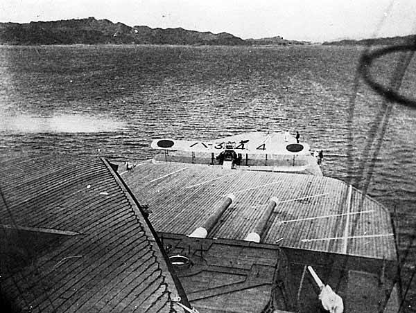

I have a question about Akagi and Kaga in their 3-deck configuration. It looks like the navigation bridge is directly under the forward end of the upper flight deck, between the 8" twin mounts. Does this block aircraft access from the upper hangar to the middle flight deck? I know the middle flight deck was short and of limited use, but was it made inaccessible by design or was this bridge built later? Or does the bridge move or open in some way?
Vlad
- Posts: 9037
Re: Calling all IJN Akagi and Kaga fans
In that configuration, up forward, there is a lower flight deck, a bridge deck, and an upper flight deck. The upper hangar deck is the same level as the bridge deck. So, no flight ops off that deck. The forward lift divides the space between the bridge and the hangar deck.
- Vlad
- Posts: 1559
- Location: England
So was there never a configuration where the middle flight deck was usable for flight ops? Did they decide it wouldn't be useful while the ships were still under construction?
Vlad
- Posts: 9037
No, never such a configuration. I think it would have been unworkable, given the need for a sizable bridge and the heavy turret armament.
