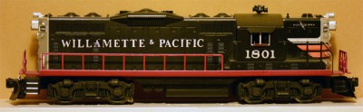

I have never used stick-ons that had a surround material. All I have used are the type with individual peel-off letters and numbers on a wax paper/plastic backing.
I first came up with this idea in desperation on a model railroad project. No one made decals for the Willamette and Pacific short line in O scale. I needed a particular "Condensed Railroad Gothic" lettering in silver, and all I could find was adhesive lettering and decals in every color of the rainbow except silver.
So I painted the side of the engine silver, applied the stick-ons and then sprayed over with black. After the paint had dried 24 hours I used masking tape to lift off the stick-ons. You can see the results in the picture (although very poor resolution to meet the forum restrictions). The "WILLAMETTE & PACIFIC" and "1801" letters were done this way. It worked especially well, with the "A" in "WILLAMETTE" flowing nicely over the contours of the vent. The letters are essentially zero thickness - just as if they had been painted on with stencils (except the paint doesn't flow under the edges of the stick-ons). And there is none of the shiny clear background you can get with decals.
I also did the "1801" numbers on the end lights this way - applied stick-ons to the clear plastic lens, sprayed over with black and then removed the stick-ons to get lighted numbers.
When I get around to building my 1:96 USS Oklahoma City CLG-5 model I'll try to find the appropriate stick-ons for the stern lettering and hull numbers. This technique will work nicely over uneven surfaces such as hull plating edges.

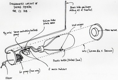

With the external detail just about complete, and the hull fitted out internally, the next task is to return to the WTC (water tight compartment) and install and test the equipment that will hopefully make the model function.
Just to refresh everyone's memory (including me) here is a diagrammatic sketch of how the actual diving system will function. I think the correct description is a "vented semi dynamic system". There will be no pressurized tanks and no pressure build up in the WTC
This means that the ballast tank when filled will (should) take the submarine down from surface running (waterline) to a point where just the top of the conning tower remains above water level. The vessel will therefore retain a slight positive buoyancy. This will be the safety margin. Forward motion and moving the diving planes to dive will hopefully submerge the vessel. Underwater stability will then be controlled by an automatic stability control unit connected to the forward diving plane servo.

PICKETBOAT wrote:
Hi Phil and Mick and anyone else.
Thanks for following and for the encouraging noises.
Put that angle-keeper on the stern planes.

I may be mistaken as to what you meant by 'automatic stability control unit' -- I assume this is an angle-keeper, not a depth-keeper. They work on different principles:
The angle-keeper senses the gravity line, using that as the sensors reference plane. The angle-keeper circuit directs the servo to work the horizontal control surface(s) to maintain the boats longitudinal center line perpendicular with the gravity line. The angle-keeper is best employed to tend the stern planes as they tend to have the greater effect on the boats pitch than bow or sail planes -- hence the use of the stern planes as the force element of the control loop for control of boat pitch angle.
However, a depth-keeper senses the pressure of the surrounding water; water pressure a direct function of depth. The depth-keeper works those horizontal control surfaces best suited to effect a vertical force to the submarine -- typically bow or sail planes.
An r/c submarine absolutely requires the use of an angle-keeper or you'll porpoise all over the place -- no fun at all! However, the depth-keeper is a lazy-mans, show-off luxury (why not just hire a kid to drive your sub?)
This show's the typical angle-keeper size -- this unit the excellent KMC ADF-2 (combined angle-keeper and fail-safe) device as installed in one of my smaller WTC's. These things used to be big, klunky things as the next shot illustrates
The ugly fellow atop is a modified helicopter rate-gyro converted to a gravity sensor. The solid state units below it employed liquid based sensors -- this is old-school stuff used in a time when the earths crust was still warm. Fortunately today'sangle-keepers are small enough to work in boats of just about any size.
The recommended ADF2 pictured below. Again: these are angle-keepers. They not only automatically tend the stern planes, they also allow you in the control loop as well. This device is a MUST HAVE aboard your r/c submarine.
So, all that school-housing out of the way: what 'automatic stability control unit' are we using here?

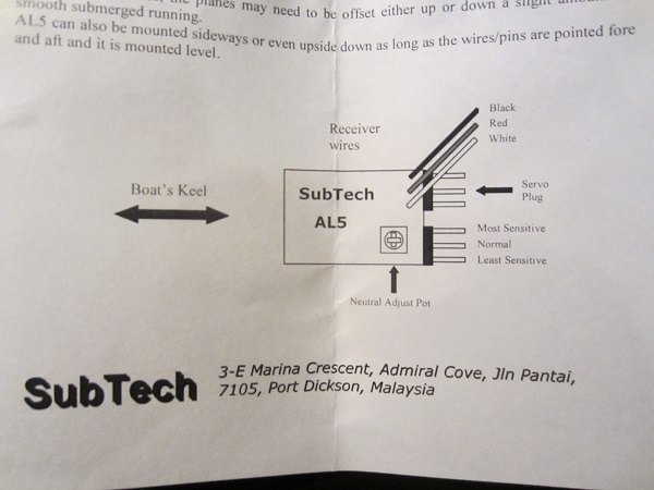

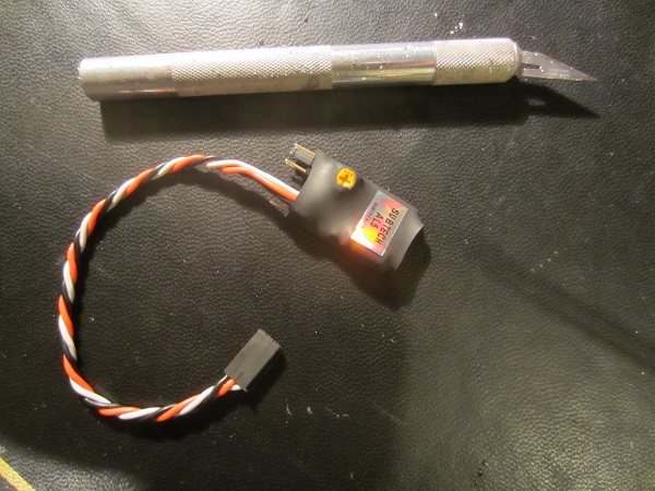

Guess what. I went and looked carefully at the instructions for the Auto Levelling device. Yes it does say connect it to the aft diving planes! I would have checked when I came to the installation, but having only given the paperwork a cursory glance I had got it wrong in my head. :doh_1:
The pictures show this little AL5 unit (which I am assured will cure any tendency towards porpoising) supplies by Subtech. The other picture shown the little 1amp speed controller (stripped of its case to save space) supplied by Action Electronics and destined to control the main motor.
I really rate these little speed controllers. Very compact, durable and have fantastic slow speed control.

Hey, only the weak read the instructions! (anyway, not till you botch things up and read them only as the last resort). In Torpedoman school the first thing they taught us was, R.T.F.M. Applies here too.
The SubTech unit is a nice product. You'll do fine with it, sir.

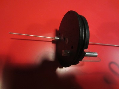

The WTC end bungs needed to be fitted with seals for the rudder and diving plane connecting rods. These seals or waterproof glands were made up from thin walled aluminium tube. Aluminium plugs were turned up for each end of each tube. These plugs were drilled to take the rods. After push fitting one end plug the tubes were one third filled with RTV silicon rubber, the stainless steel connecting rod previously had been sprayed with release agent. When the silicon rubber had set the remainder of the tube was packed with waterproof grease before push fitting the other end plug.
I’m pretty confident that this will provide a watertight seal yet not restrict the movement of the connecting rod.

LOL. Yeah, those things are funnier if you're made to work for it. Dear God, tell me you didn't tell her what you were laughing at.
Anyway ...
With your seal hydrostatic force will eventually shove the grease and water into the dry space -- stuffing tubes went out with the buggy-whip. How about some of my seals? Suitable for 1/16" or 1/8" pushrod diameters. If so, send me your address and I'll fix you up. dmeriman@aol.com
Those seals have a body diameter of 1/4" and the length is about 1/2". They'll last forever and only require the occasional drop of silicon oil on the pushrod.
