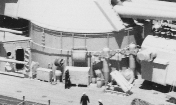

Rick E Davis wrote:
I have to wonder if there still weren't two-three paravanes onboard, they just are being stowed in a different, difficult to see location. The King Board Mods required several rearrangements.
You would have to believe if there was more than 1 paravane, then logically they would have to be stowed somewhere on the forward deck if not on the #2 barbette. There is not a whole lot of places on the forward deck other than the #2 barbette to put them. The April 1st film gives us great views of the forward deck both port and starboard and there is no paravanes to be seen other than the one on the port side #2 barbette. The boat deck was very crowded with splinter shields and 5" guns. Unless they were stowed by the stack, the boat deck doesn't seem a possibility.
Here is a still of her in 1939 with a paravane on either side of Barbette #2.
April 1, 1941, no paravane on the starboard side barbette:
Port side:
I wonder if there was enough room on the front side of barbette #2 to stow a paravane? I don't know what kind of clearance there was behind turret #1.

My reasoning for a relocation of stowage of the paravanes onboard USS ARIZONA is based on several factors;
1) At least two paravanes were needed to perform a "standard" sweep operation (a third would likely be a backup/replacement if one was lost in operation and wouldn't need to be stowed close by).
2) In the 8 November 1941 photo of USS ARIZONA in drydock at PHNY, the image isn't the greatest and the paravanes can't be seen, but it is clear that at least on the starboard side of turret #2, two nested life rafts have been located where her paravane(s) use to be located on the barrette.
3) In photos of her sister, USS PENNSYLVANIA, during the 1930's into WWII, she stowed her paravanes on the FRONT of turret #2's barrette.
Cropped view from a photo dated August 1935
Cropped view from photo dated 6 December 1943
I have no idea IF USS ARIZONA relocated stowage of her paravanes to forward of turret #2 on the barrette, or perhaps somewhere else onboard the ship. I'm just about certain she had two or three of them onboard as part of her standard equipment. I don't have many images of USS ARIZONA immediately prior to the Attack on 7 December 1941. A general lack of photos of her and much of the USN Pacific Fleet in the Summer-Fall of 1941 (due to restrictions on photography in general) that causes these questions.
