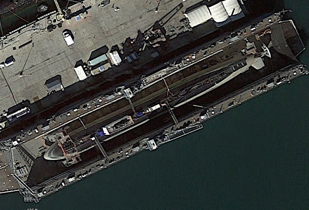

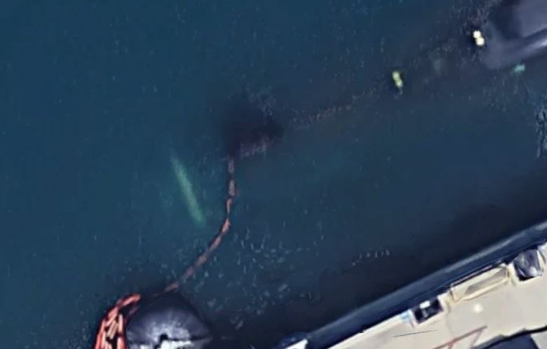

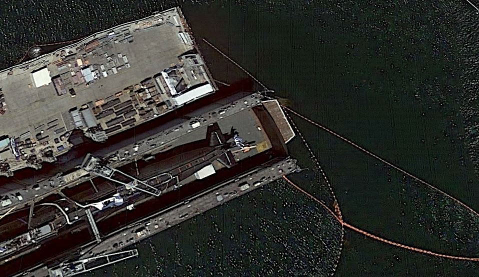

Hey all, just thought I would post up some things I came across while playing on Google Earth. These are screen cuts, so not the best quality but you can infer some info from them.
Pictures #1&2 were taken in August of 2018 and show a Flight II LA boat in the floating dry dock in San Diego. If you look at the screw, you can really see how much sweep back the blades have. Also, the screw almost has a chrome like finish, not sure if this is just for when in dry dock or if they are using a new material on the screws.
Pictures #3&4 were from Google Maps at an unspecified date, showing a 688i boat, specifically the sun shining in the water shows that the outer ring on the screw is bronze colored to match the rest of the screw.
Picture #5 is from January 2008, showing another 688i boat. The sun also shows the screw outer ring as a bronze finish.
Picture #6 is from October 2012 and shows either a Flight II or 688i boat, showing what is possibly the black/gray paint scheme. This may not be trustworthy as the boat is in dry dock and may be partially painted.
Obviously these pictures cannot be traced back to specific boats unless we find somebody with access to the logs of which boat was were and when, not likely to happen. But hopefully these can help with other more general questions that some of us have.

Nice photos! You can see the shadow of the boss cap vortex attenuator on the second photo. I would guess the silvery appearance of the screw is just due to light surface oxidation that can give bronze a grey cast. And the appearance of the 688I with gray below the waterline is almost certainly due to marine growth or oxidation of anti-fouling paint.

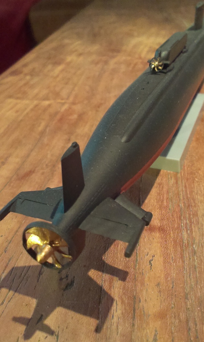

I have modified one of my props with this feature... note also the shadow below. Nice extra: I also added a ring to the prop of the ASDS. Maybe I should paint these rings in bronze as well?

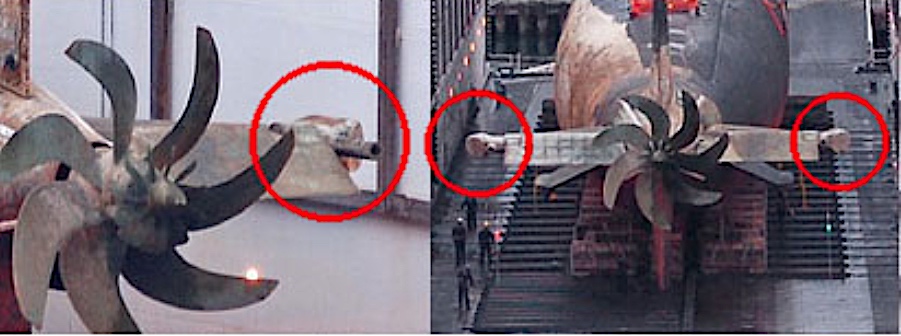

]Umm, if you mean the Vortex Attenuator, I don't see it. If you mean the ring propeller, yes.
The Vortex Attenuators look like this on the propeller hub:
(the circled areas are towed array dispensers)
LA Vortex Attenuator on propeller
The other thing you might want to do is paint (or add as thin white strips) the four sacrificial zincs at the stern. They are prominent on the stern; see this link for the one of the zincs on USS Greenville in dry dock:

aah, now I see! Thanks mate. I was only thinking of the Coke bottle hub cover.
And yes, you're fully right about the zincs, on most of my other boats I painted them in the appropriate color.

Maarten,
If there's a fairing for the towed array along the starboard side (the long blister that runs from bow to stern), there will always be a towed array tube on the port stabilizer. This is the TB-16 ("fat-line") towed array. The array itself was thick and inflexible ("fat"), thus it had to be kept relatively straight inside that fairing on the starboard side. It was streamed out of the tube on the port stabilizer on a much longer cable that was stored in the forward ballast tanks (because the tow cable was thinner and more flexible, it could be wrapped around a winch). A few of the early 688s were launched without towed arrays, but they were added soon after the submarine was commissioned. By about 1980, all 688s had TB-16 towed arrays. To reiterate, if the long blister on the starboard side is there, there must be a tube on the port stabilizer. Having neither the blister or port-side tube is only correct for a few boats in a limited time period.
Before the TB-23 was introduced, the starboard stabilizer was bare, like you described. The TB-23 ("thin-line") was longer, thinner, and more flexible than the TB-16, thus it could be wrapped around a winch with its tow cable. The array and cable were stored in the aft ballast tank and the array was streamed out of a tube on the starboard stabilizer. The TB-23 was developed in the mid '80s, and my impression is that they were fitted to the new 688Is before they were retrofitted to the early 688s. The TB-29 was another type of thin-line array that was developed in the mid '90s, and the tube on the starboard stabilizer was almost certainly unchanged for boats that got the TB-29.
Here is a photo of the Columbia which shows both arrays,
as does this youtube video of the La Jolla,
https://www.youtube.com/watch?v=tfcNIAEDsPM
