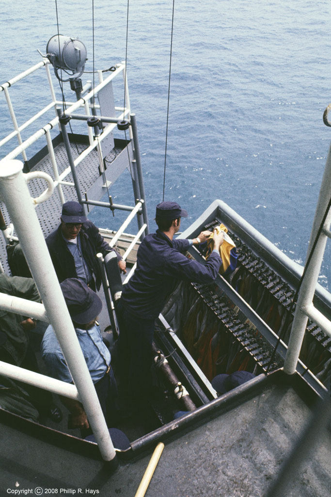

Your halyard rigging and foot ropes look OK. The photos from the Manchester show the signal halyard rigging pretty clearly.
Here is a photo of the flag bag on the OK City CLG-5:
https://www.okieboat.com/Copyright%20im ... 24%20C.jpg
I thought it might have been the WWII version just carried over to the CLG modification, but it appears to be smaller. But you can see the bar in front of it they tied off the halyards to while attaching flags. I don't know if they did this during WWII - something to watch for.
