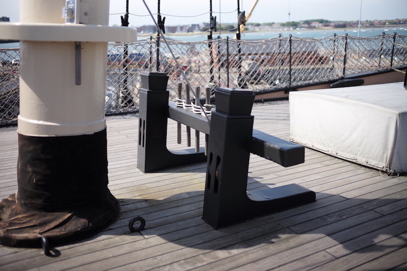

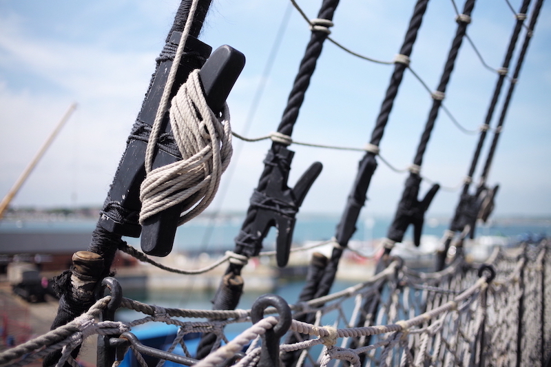

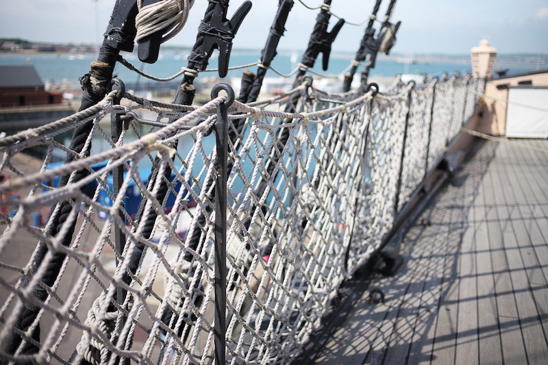

I have attached a couple of photos of the netting from Victory from my trip this summer. Hope they are of interest...
As usual, your attention to detail astounds me! Congratulations!
