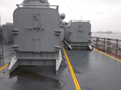

I think I have finally remedied the lack of references on the ABLs. I climbed over ABLs and filled two notebooks with measurements. There are a few caveats.
1) The feet at the ends vary in length. They are not even the same on each ABLs.
2) There are two variants. The one shown has a ladder on one side. The six aft-most ABLs on the NJ are like this. The two forward-most ABLs have rungs welded to the ABL on both sides.
3) There is 2-1/2" of blast shielding under the back ends. The ABLs are cut upwards over the shielding. Not shown here.

PostPosted: Mon Sep 23, 2019 1:48 pm
Posts: 3125
Location: Mocksville, NC
jim,
Thanks for posting your very fine ABL 3D rendition! As you & I have been discussing, the ABLs were not all the same and making a "master" unit that would fit all models is probably not realistic. Esp. from your own findings on NEW JERSEY. In contrast, I have included the photo I took last week on WISCONSIN of her port angled ABLS:
