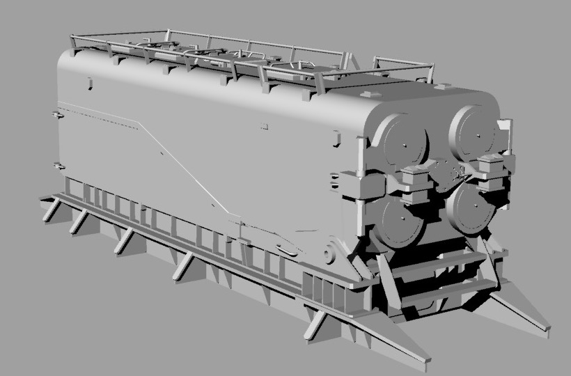

I think I have finally remedied the lack of references on the ABLs. I climbed over ABLs and filled two notebooks with measurements. There are a few caveats.
1) The feet at the ends vary in length. They are not even the same on each ABLs.
2) There are two variants. The one shown has a ladder on one side. The six aft-most ABLs on the NJ are like this. The two forward-most ABLs have rungs welded to the ABL on both sides.
3) There is 2-1/2" of blast shielding under the back ends. The ABLs are cut upwards over the shielding. Not shown here.

jim,
Thanks for posting your very fine ABL 3D rendition! As you & I have been discussing, the ABLs were not all the same and making a "master" unit that would fit all models is probably not realistic. Esp. from your own findings on NEW JERSEY. In contrast, I have included the photo I took last week on WISCONSIN of her port angled ABLS: and one of her amidships ABL in raised position:

Well geez, I think all of us are gong to have to tear apart and re do our fire control towers! Rather interesting bit of micro geometry, wonder why they did it that way? All of my Box launchers are the same on my model, but I had only the four midships ones to look at on Missouri.
Good info!

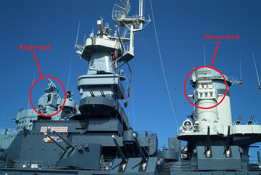

Regarding New Jersey's original fire control directors, here's New Jersey in June, 1945. At the time of this photo, she still has her original 6-sided Mk.38 directors and angle-back Mk.37 directors.
Iowa originally had the 6-sided Mk.38s and "angle-back" Mk.37s, too, as did the preceding North Carolina and South Dakota classes. Missouri and Wisconsin were built with the enlarged 7-sided Mk.38 directors and "square-back" Mk.37 directors. So, too, were the Alaskas.
Interestingly, after a deadly friendly-fire incident involving a 5" round destroying USS North Carolina's port-side, angle-back Mk.37 director, the destroyed director was removed and replaced with an enlarged "square-back". To this day, she retains three "angle-back" Mk.37 directors and one "square-back".

At least the Iowa still has the 6 sided Mk 38 directors today. The Mk 37 directors have been modified so the shape of the housing is substantially different now.

Regarding the IOWA Class Battleship Main Battery Rangefinders:
The Mk. 38 Optical Rangefinder has NOT been replaced on these ships. What has been changed is the RADAR that is mounted on top of the rangefinder. Originally, each ship had (2) Mk. 8, Mod. 3 RADAR units which was replaced late in the war with the Mk. 13, Mod. 0 which is still in place today on all 4 ships.
NORTH CAROLINA, ALABAMA, and MASSECHEUSETTS retain one each of the two different RADAR units.
One other note - NEW JERSEY retains the original Mk. 37 Secondary Battery Director Enclosure with modifications eliminating the open cupola on the front (as built). MISSOURI retains her original Mk. 37 Directors including the open cupola (as built). IOWA and WISCONSIN received the newer Mk. 37 Director enclosure with the straight walled upper part including the open cupola. This is the version that these two ships retain today.
Hope this clarified things a bit.
