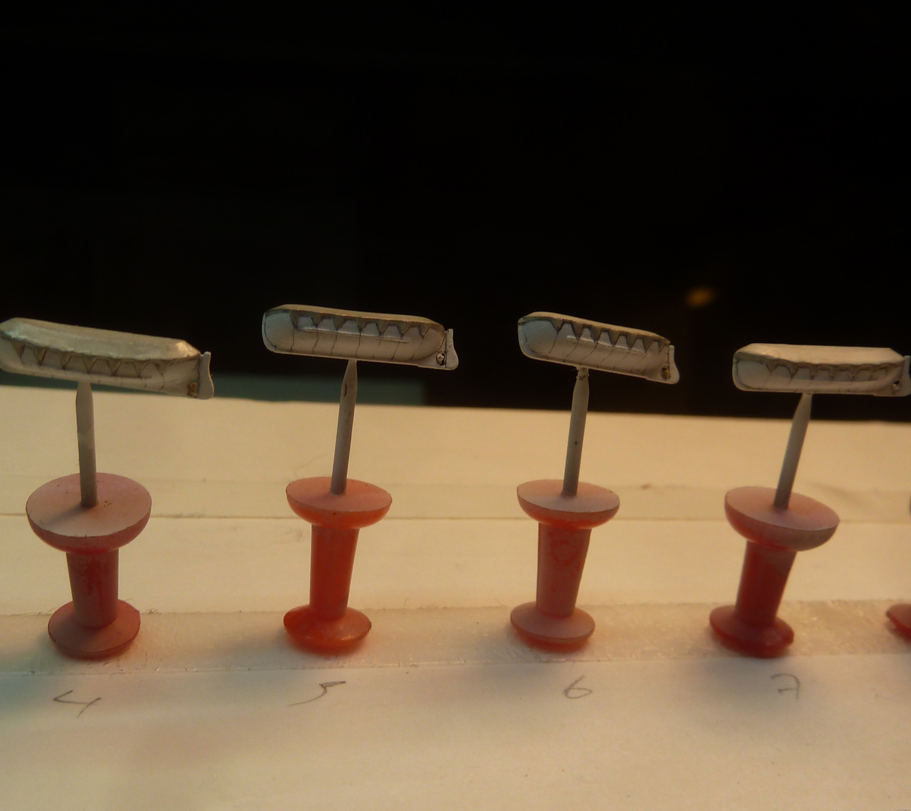

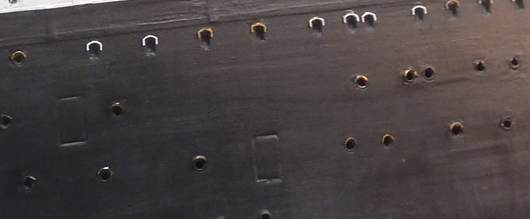

I have now completed ALL the eyebrows =
= about 1100 or more all told -with the round and square topped variants.
and add some much needed texture to the models otherwise very bland hull surface.
In oblique angled photos of the real ship they are distinctly visible
and a distinctive relief feature

Placing the eyebrows in the black area I found that simply seeing the square topped ones to align-- pretty hard--
so gave them a light airbrush dusting of white to assist alignment.

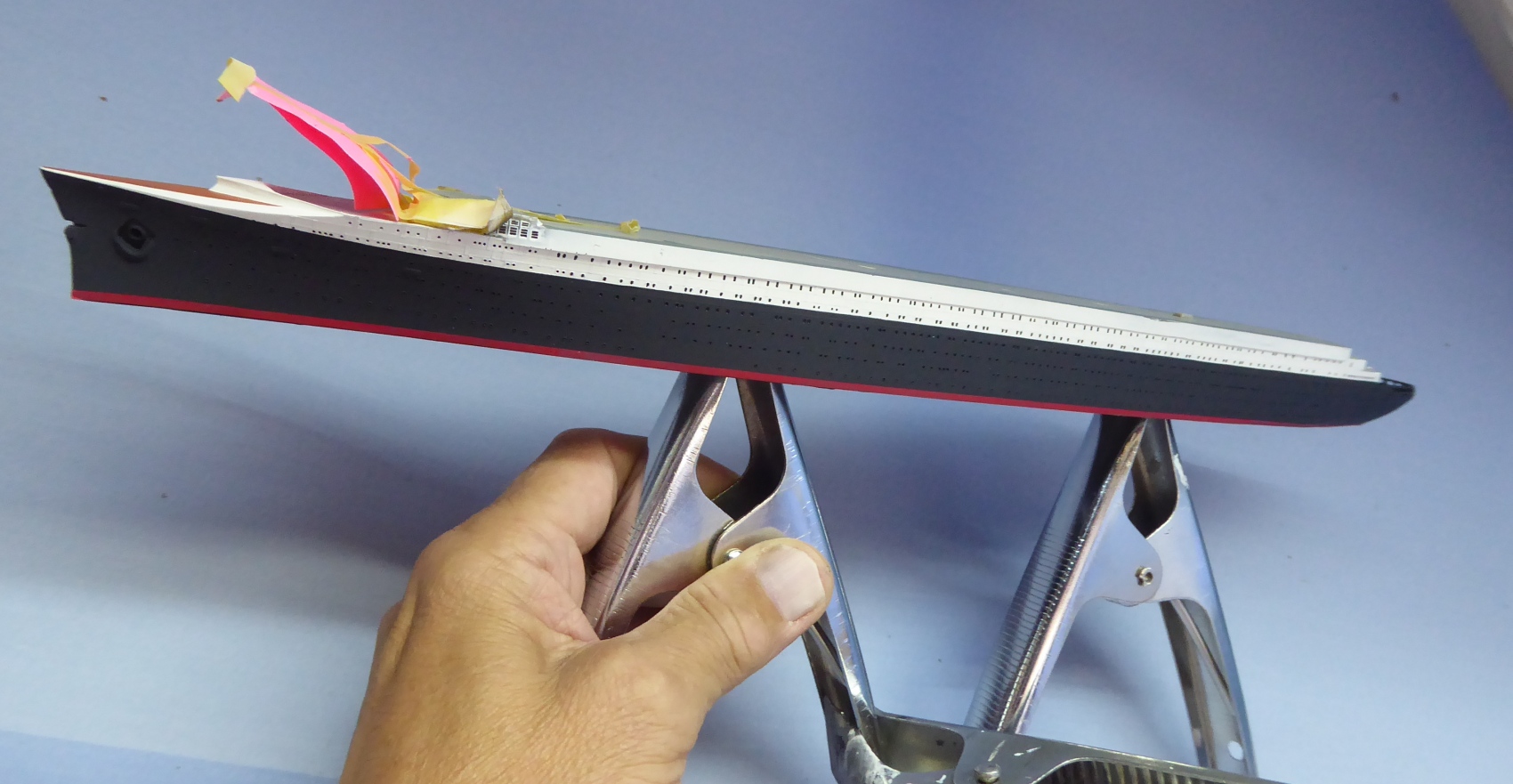

The waterline was applied as a red tape, then toned down with a wash of a duller red enamel paint and a second wash of grey watercolour
( so as to NOT allow the layer washes to attack each other!)
to simulate the " chalking " by the salt

Well-- the weather in the UK is now cold
so the hull and its promenade deck overlays are experiencing the full gamut of
( very !) warm central heated evenings , pleasant daytime heating
and stone cold nights ( heating goes off at 11:30 pm and comes on at 8am)
modelroom has large windows and is not well insulated-
-so when heating goes off temperature falls drops very effectively to around 10 -12 deg C deg
I have studied the hull when cold at night ( with some trepidation in case of ' snaking')
and in the very warm evenings in the modelroom et al
amd I can report no sign of differential movement that is visible.

after clean up they were impaled on pushpins red and green...
The pin hole will not be visible ( on the inboard under side ) on the installed boat in the davits ( at least not without and endoscope and a mirror!!¬)
I prepared double the required number so as to be able to pick and choose the best ones
( some of them had small printing defects which needed filling )

its a process of whittling the finalists down...
18 port-side boats that were deemed good enough actually need 13 per side
The processing was as follows, using a pencil ( H 3 pencil sanded to a chisel point on 2000 grit sandpaper)
Draw on on cover tie lines with pencil, accentuate the stem/keel/stern post deadwood with a fine pencil line
Draw on the hinge twixt rudder and sternpost, outline the screw aperture with pencil
Outline the cover tie down triangular gussets with pencil ( simulates the "stand off " shadow ( I reckon anyhow! :big_grin: )
Paint the gussets and the top of the covers.
When dry--
with pencil dust on brush outline the shape of the cover over the nested smaller boat .
Then wipe with thinners on brush to soften the outlines and add a bit of colour variance
with a white paint-and-thinners wash tone down the cover ties and outlines etc
Discard the less happy lifeboats !
Still to do....
paint the screws a dull dark beige to simulate lightly tarnished brass
and touch up where needed.
Oh... and repeat the whole process for the starboard side ... ! :Mad_6:
