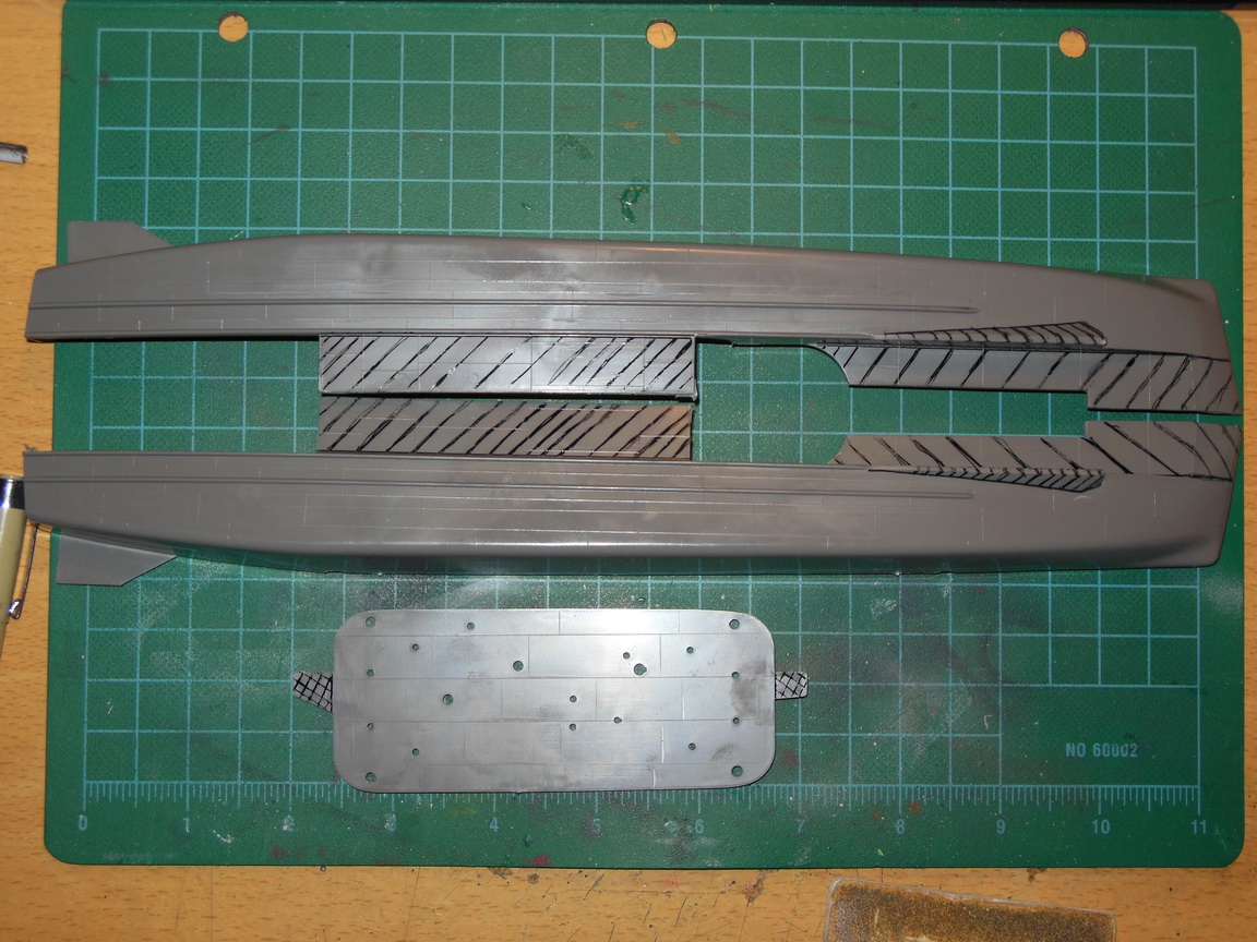

File comment: The hull halves marked for parts to be removed

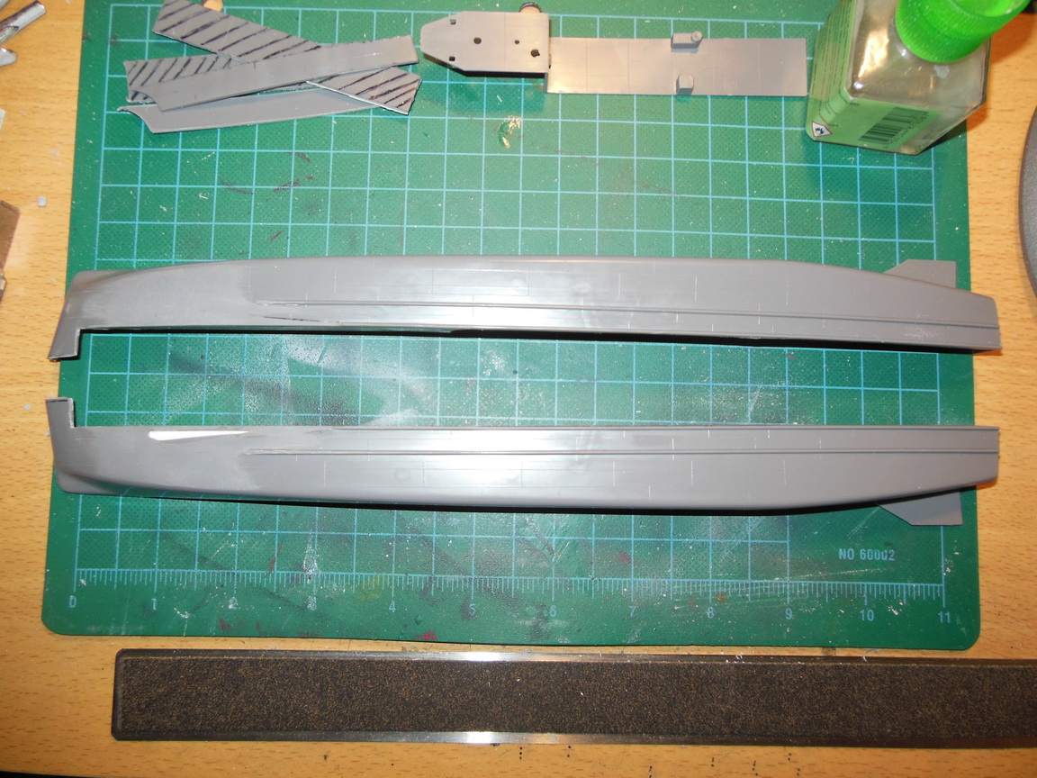

File comment: The hull with the deckhouse and ramp extensions removed

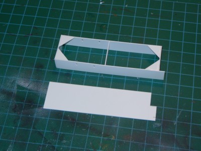

File comment: The base structure of the deck house...

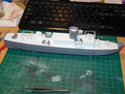

File comment: Test lay out once I started getting in the guns and fittings from Shapeways

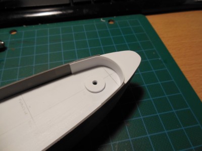

File comment: The modified bow with the raised pedestal for the 3"-50 cal deck gun
