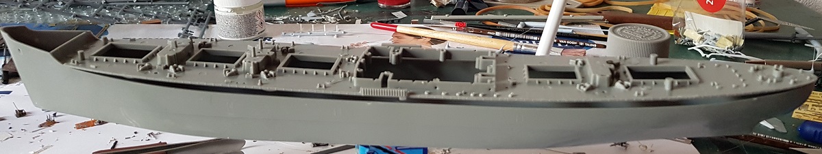

ok...molded railings all been cut of main deck...that was a pain doing...and I've broken my record in how many times of cutting myself...in 1 day

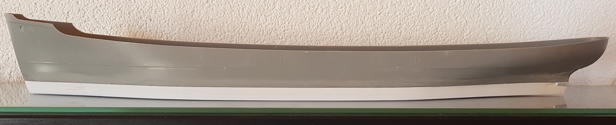

going for full hull

a few more cut ...2 levels to go

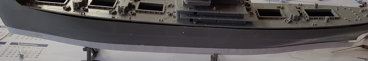

some more done...mainly also hull ...painfull job and not finished...added 8mm ..would be 3.2m in reality.....looks good to me
fully loaded she had a draft of 8m....

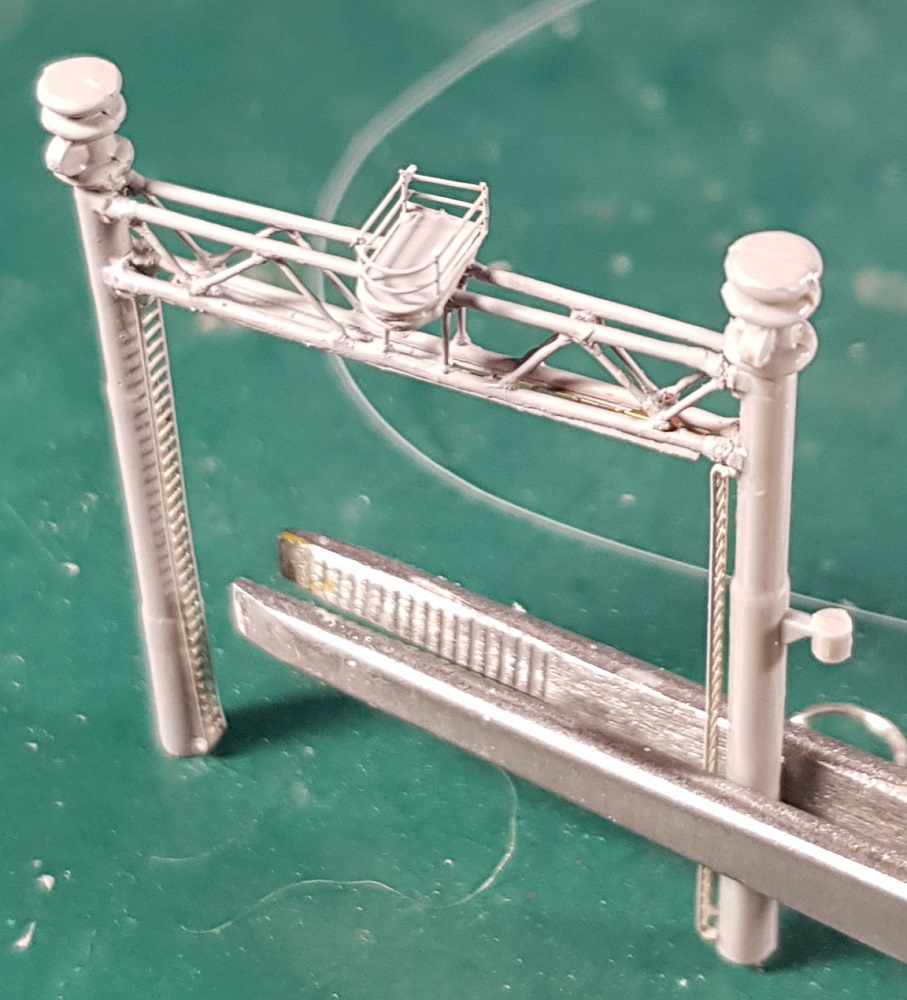

had seen this...and wasn't quite ok with kit one...so I tried something out making it scratch...there's only one like it...so wanted to do something more refined
Triumph68
Posts: 1125
Re: Revell 1/380 USS Burleigh
Post by Triumph68 »
wasn't totaly convinced...so re-used the kits mast and re-build...what do you all think...better?

getting close on hull...a little more fine tuning...some putty....more fine tuning...yes...I'll get there
need that hull finished to fix deck on...this is needed before I ad the new structures....as deck isn't flat but follows the curbed line of hull....the structures must also follow that curbe ...at least first level
