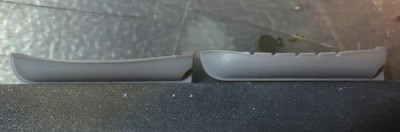

I have been working on the row boats and Admirals Pinnaces. Trumpeter provides like a dozen row boats in the kit, but as far as I can see, only two were in use at the time around the Battle of the River Plate. There is not much you can do tot he plastic row boats, I only added the notches for the rows on each side (5 per side),then painted them Light gray and Wood. I will add the PE rows later.

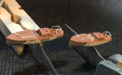

The Admirals Pinnaces were something different. First thing was, usual detergent washing of the Shapeways 3D pinnaces does not work to get rid of the oily coat the have. I learned it the hard way when the primer would not stick at all. I had to rinse them in Lacquer Thinner to get rid of the stuff. Second thing was that the surface seems to have mini/scratches all ofer the hull and upper structure. I managed to smoothen most of it by sanding.

File comment: To the left, a boat without the row notches, to the right one modified.

File comment: My second try priming the pinnaces. I added railing issued with think copper wire.

I added the railings using thin copper wire, bored opened the skylights to make painting easier later. I painted the hull dark gray, side walls Light Ghost gray and the decks Wood, with the inner planking teak. It is interesting how the camouflage was so hastily painted on these boats. The scarce references available show irregular patches, breaking the horizontal line between the dark gray hull and light fray walls, mixed with larger dark gray areas that in one case runs down to the keel. Pretty interesting, tried to simulate them as much as I could using three tones of gray. Clear parts were painted Chrome (windshield) and a mix of Gunmetal/Chrome for the cabin windows. Sealed everything with Alclad semigloss, windows with Future.
I can see two Admiral's Pinnaces on the Graf Spee in the pictures after the Battle of the River Plate.
