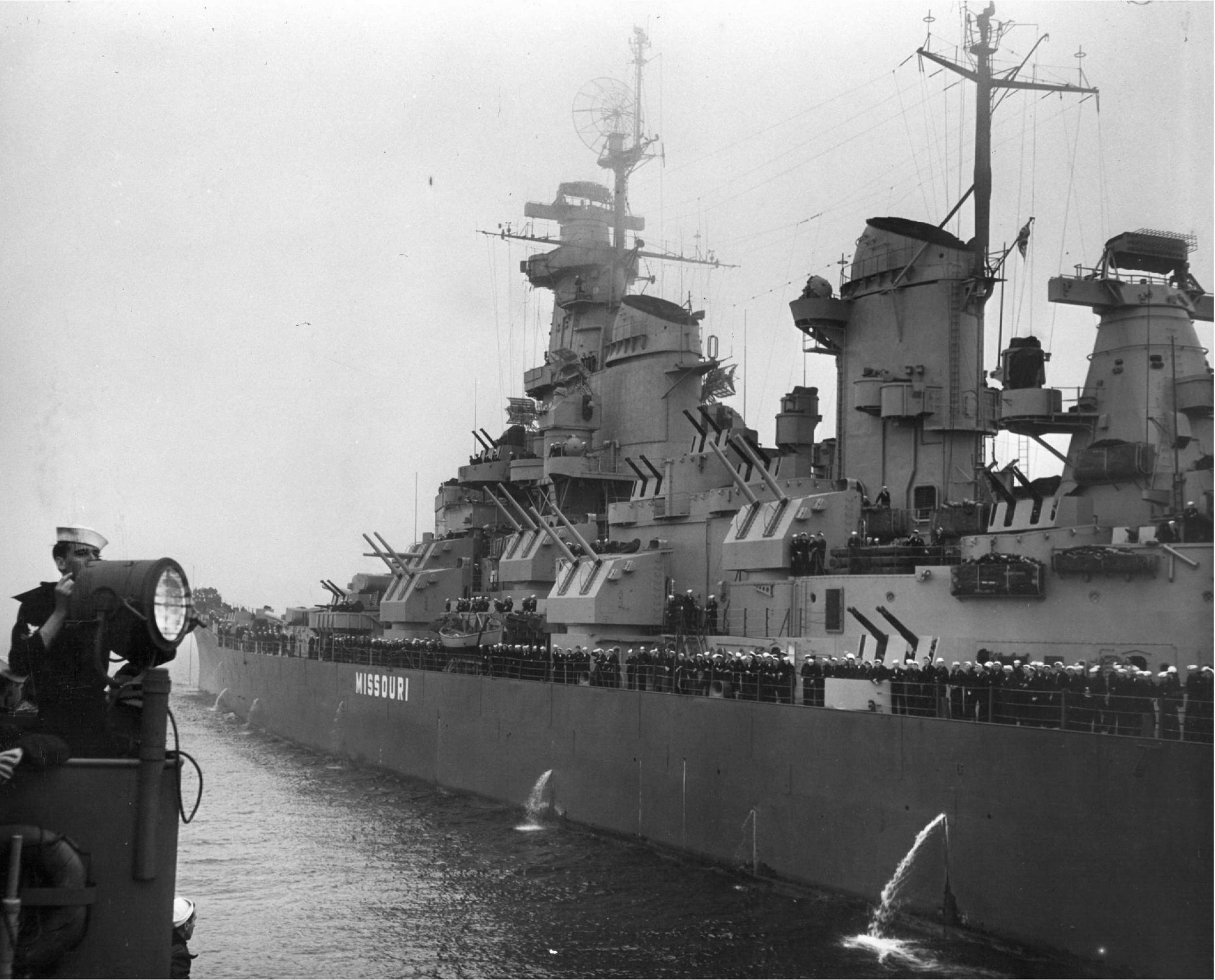

Pontos and eduard PE sets for 1/200 missouri both contain 2 half circular metal frames for each gun embrasures on the 5�/38 gun houses. I assume these are for supporting the bloomers/blast bags. But I�ve never seen these frames mounted when the bloomers are not mounted. Has anyone seen a photo where these frames are on the gun houses?
SpyderDan
Posts: 7
Joined: Mon Mar 30, 2015 12:01 pm
Location: Long Beach, CA
Post by SpyderDan »
chuck wrote:Pontos and eduard PE sets for 1/200 missouri both contain 2 half circular metal frames for each gun embrasures on the 5�/38 gun houses. I assume these are for supporting the bloomers/blast bags. But I�ve never seen these frames mounted when the bloomers are not mounted. Has anyone seen a photo where these frames are on the gun houses?
chuck
Posts: 3384
Post by chuck »
Thanks. Interesting on the Missouri only one frame is mounted on each embrasure.
Posts: 12447
I think it only appears that way for the mounts closest to the viewer, because the nearer frame blends into the opening/slot for that barrel. If you look at the mountings closer to the bow, you can see that second frame just "under" the more easily visible one.
