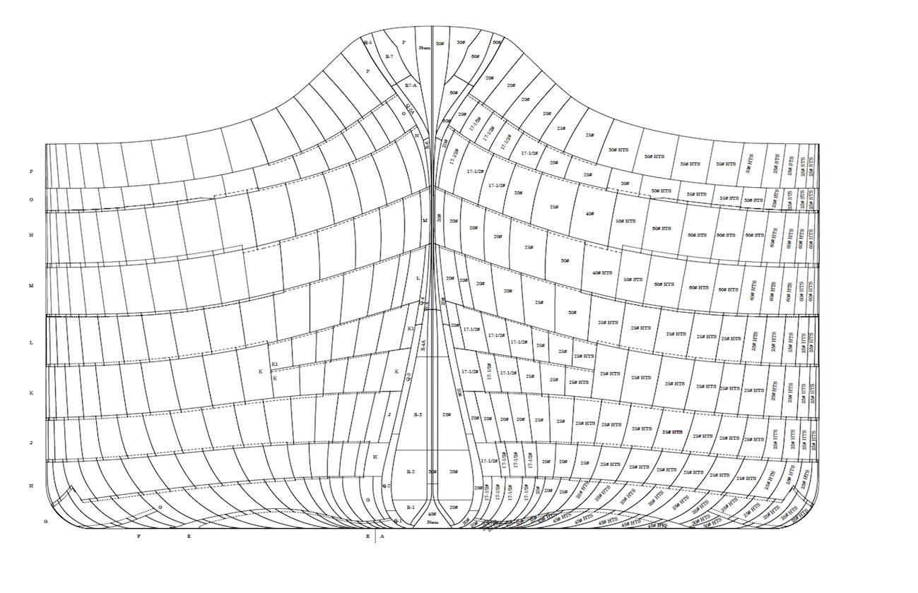

wojtekp90 wrote:
I have a question where can I find information on hull skin, hull plates and hull specifications?
I had to resort to using transverse sectional drawings in booklet of general plans identify where the hull strakes are at different frame numbers illustrated in the booklet, true them up as much as possible against photographs of the ship, and then connect the strakes between frame numbers illustrated, again using photo as reference where possible to determine how strakes merge or split.
I have to say although good direct information is hard to come by, there actually seems to be more information about Iowa's hull plating floating around in pieces and bits than other ships I've tried searching for. For example I've never found any information on the plating patterns on the bottom of the Hood or on much of the Arizona below waterline.
PostPosted: Tue Feb 25, 2020 2:58 pm
Posts: 463
Sadly, there is no one place that has all the information. The microfilm for this data is largely unreadable. Only one blueprint of the hull plating (out of eleven) has survived to my knowledge.
That said, I have been piecing the information on plating together from various source into a computer model.
I think that I have identified every hull plate, its type, its thickness, and type of joint to adjoining plate in a computer model. I know this is a bid of a tease but I need to figure out how to publish the data in a useable format (i.e. for those who do not have access to Rhino).
The plating structure is needlessly complex. The Kentucky and Illinois dispensed with some of the complexity. (I cannot tell how much.)
I have not seen any published source that gets the plating right. Even the recent AOTS book is way off in this regard.

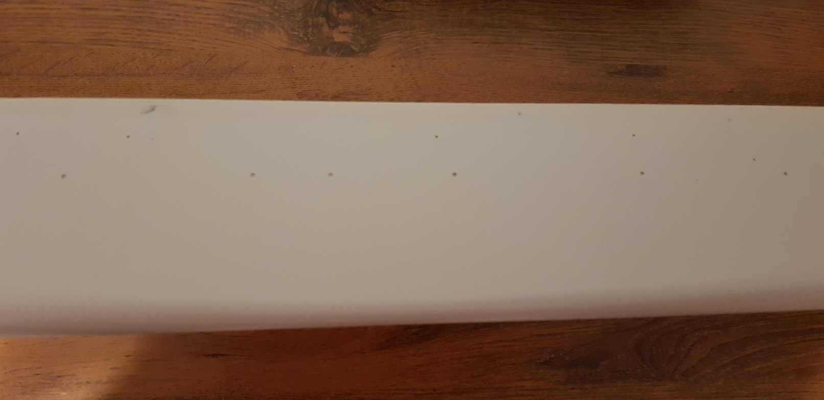

I bought the Trumpeter Missouri 1/200 set, I looked at the hull and wondered what the hull holes are.Maybe someone knows?
I am sorry to ask for such a thing but I am not an expert in this topic

Wojtek90 wrote:
Quote:
I bought the Trumpeter Missouri 1/200 set, I looked at the hull and wondered what the hull holes are. Maybe someone knows?
Once again - take the time to read thru the 1:2oo scale IOWA class build logs and you just might find out how those holes relate to 3rd party accessories. This is NOT a beginner's kit - it involves quite a bit of modeling experience to build it correctly. Just my opinion, of course :doh_1:
Most of the holes molded into the side of the trumpeter hull above waterline depicts various waste water discharge holes on the side of the ship. A few of them are for aligning railings used by the boarding ladders.
As mentioned before, while trumpeter did a reasonable job matching the planform and side profile shape of the hull, the contour is way off. Depending on your standard, you may or may not chose to correct the contour errors. If you do not, the kit would build up to something that to most people with passing interest in ship models in general or the USS Missouri in particular, would not look wrong.
But if you are an engineer or just detail oriented enthusiast, then the magnitude of contour errors are far too great to be taken care of by sanding and filling. You would need to rebuild around 60-70% of the hull from scratch.

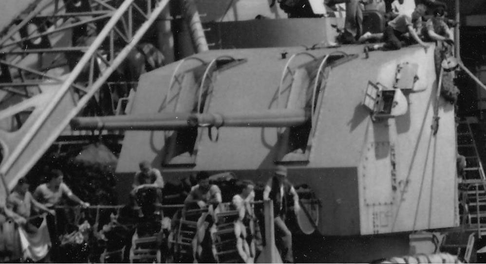

Pontos and eduard PE sets for 1/200 missouri both contain 2 half circular metal frames for each gun embrasures on the 5”/38 gun houses. I assume these are for supporting the bloomers/blast bags. But I’ve never seen these frames mounted when the bloomers are not mounted. Has anyone seen a photo where these frames are on the gun houses?
PostPosted: Wed Mar 04, 2020 3:44 pm
Posts: 3383
Thanks. Interesting on the Missouri only one frame is mounted on each embrasure.
PostPosted: Wed Mar 04, 2020 3:52 pm
Posts: 12331
I think it only appears that way for the mounts closest to the viewer, because the nearer frame blends into the opening/slot for that barrel. If you look at the mountings closer to the bow, you can see that second frame just "under" the more easily visible one.
