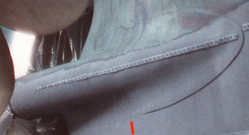

Here is an atypical example of the type of joint that occurs frequently in the Iowa class.
My red line marks the start of the shaft casting. The plating is welded flush to the casting. Forward of the casting is the one-plate D2 strake. Below that are the D and C1 strakes. The D1 strake has a riveted, overlap joint with the strakes below. But then its lower aft corner needs to be flush. The underlap has to be shaved down to allow this. That's a lot of machining for a joint that provides zero benefit. The Kentucky and Illinois were welded flush here.
The typical example of this joint occurs on the bottom at places where strakes divided to create T-shaped joints. Where B overlaps A at the side but is flush with A at the end you get the same kind of corner problem.

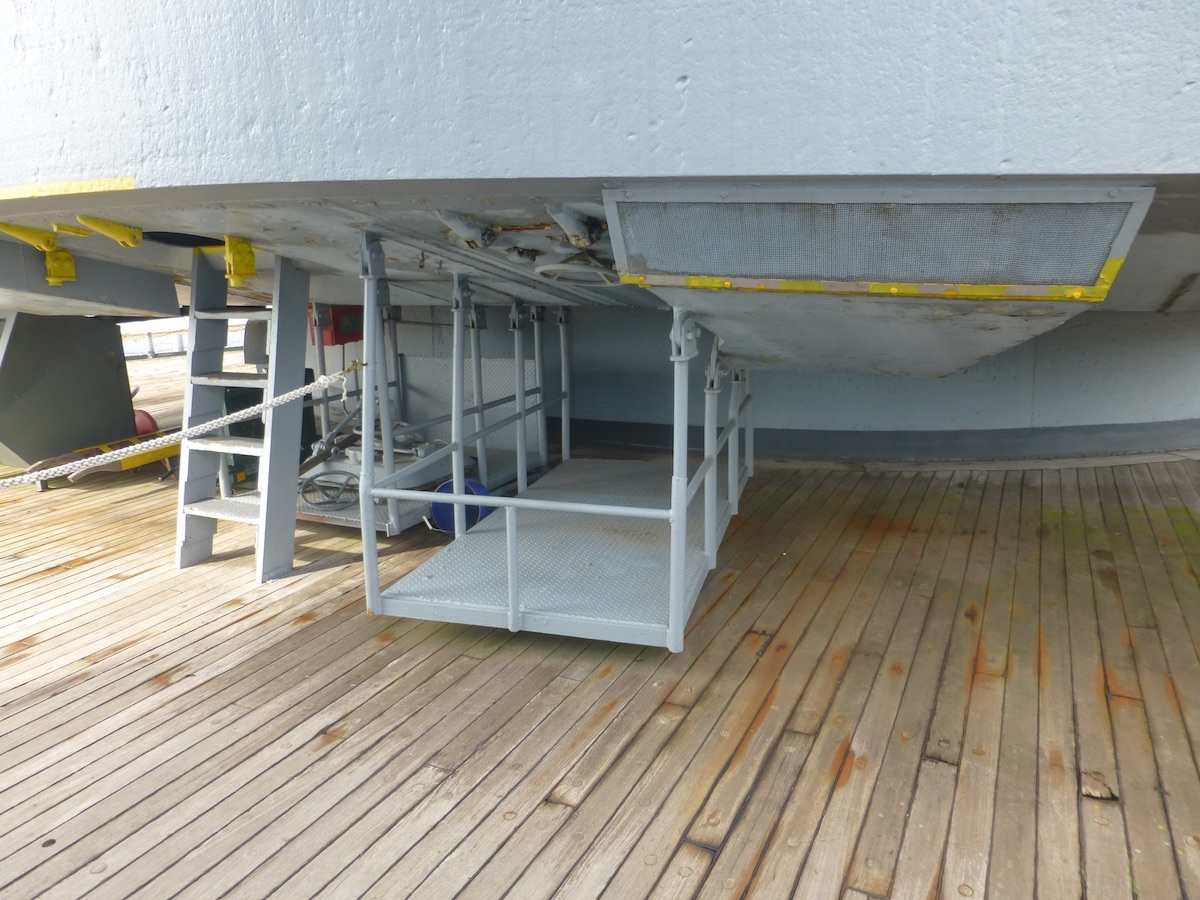

Here's Turret No. 2 on the NJ. The main hatch and the platform below have been removed and moved forward. The hinges are in place and painted yellow. The emergency hatch remains in place.
The hatch on Turret No. 1 does not block visitor access to it remains in place.

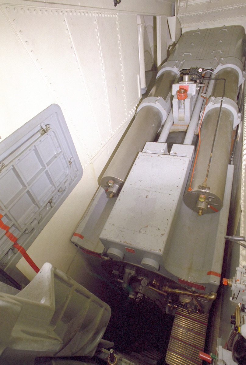

Here are some more details I have found scouring the blueprints. This photo is from the National Archives and can be found all over the internet so you get get it at much higher resolution. It shows the gun in the process of being fired. The yoke at the end is pulled back from the slide so some of the barrel is exposed in the gap. A cylinder at the bottom absorbs the recoil. There is 48" of travel in the cylinder so recoil is less than that (I have seen values between 43" and 48" in print). If the gun recoils 48.0000001" there will be damage. The two cylinders above push the gun forward.
My reason for posting is at the forward end. Just to the left of the side there is a vertical plate. That plate is attached to the turret and runs down to below the gun and as the side of the gas seal (ie keeping out poison gas). Running perpendicular to that plate you can see two plates forming a triangle . They are linked to each other, to the turret roof, and to the slide with hinged. They are the top of the gas seal. When the gun moves down, upper plate moves down so that it is slightly forward of vertical. When the gun moves up, the hinges bend to form a smaller angle between the seal plates.
At the sides and bottom the seal is formed with blades. There is a curved plate mounted under the gun for the seal. In higher resolution, you can see the wear on the vertical plate forming the seal.
I have not measured it out but it looks like they could not use a simple curved plate at the top it would have blocked the gun from moving close to horizontal.
