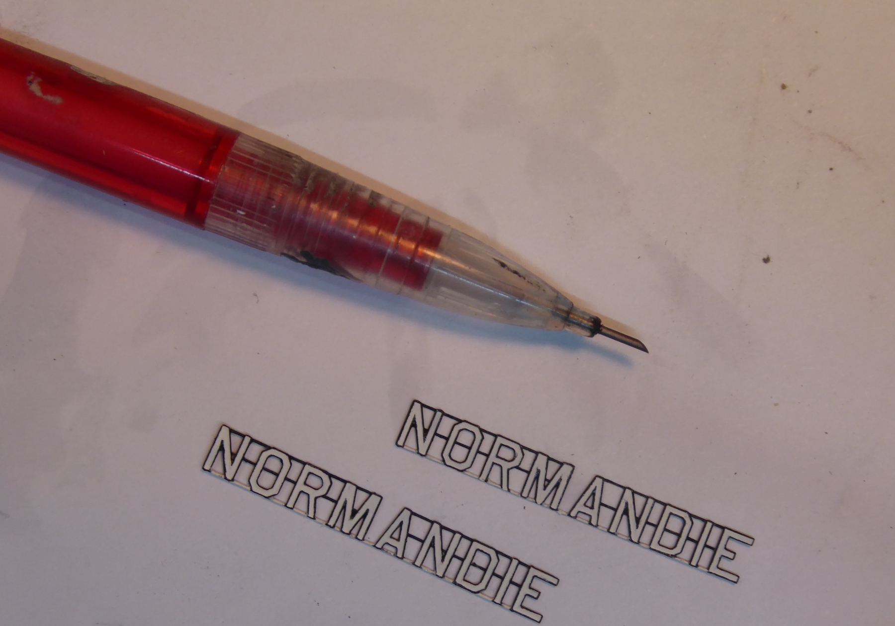

as built ( as is my model) the ship had the name emblazoned on her upper deck as a large illuminated sign
The real thing -- close up -- looks like this
Noteworthy is that the sign is a U shaped box section-- braced longitudinally on the reverse
with light-bulbs arranged to reflect the light within the U-box. The sides and back are painted black.
I decided against the light-bulbs... ( this is 1/700 !!! :big_grin: )
I had the option of the kit PE lettering ( too simplified, very soft- in brass )
3-D custom printed lettering--correct in that it had fine edges, and was a proper ' U-box'
or my custom stainless steel relief etched PE lettering
The problem with the 3D printed lettering was that whilst it was ' correct ' it was dimensionally correct ..
. in 1/700 on the ship it just looked a bit " BIG "
The bracing on the reverse was also a bit heavy for my liking
compromises and preferences...
The stainless PE -although in section -may appear a bit thin when enlarged brutally....
But when offered up to the model ship it had a more delicate appearance
-- and -looking at photos, taken from a distance of the real ship
my perception of the under-size section depth was actually more to my liking
They all were quite a fiddle to paint, to hold and paint!. I stuck them on to the sticky side of a post it note
( stuck down to the bench with doublesided tape )
and further secured the lettering to the post-note with Tamiya tape -
-so that when running the 00.3 pen along there would be no shifting
the bracing was added --in much thinner strips of stainless steel PE ( ex PE rigging )
Much touching up and paring away the paint with a curved edge scalpel blade was needed to get a reasonably acceptable look
The lettering was installed; the angled supporting props on the inside will be added shortly in situ
