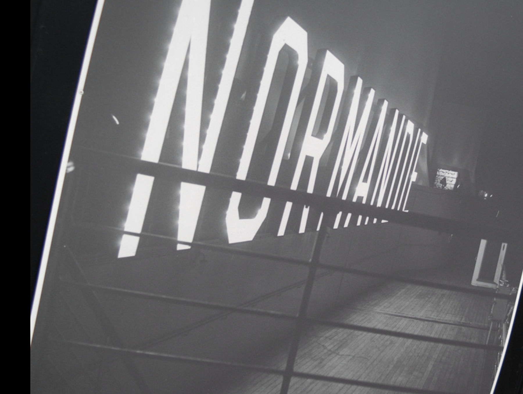

as built ( as is my model) the ship had the name emblazoned on her upper deck as a large illuminated sign

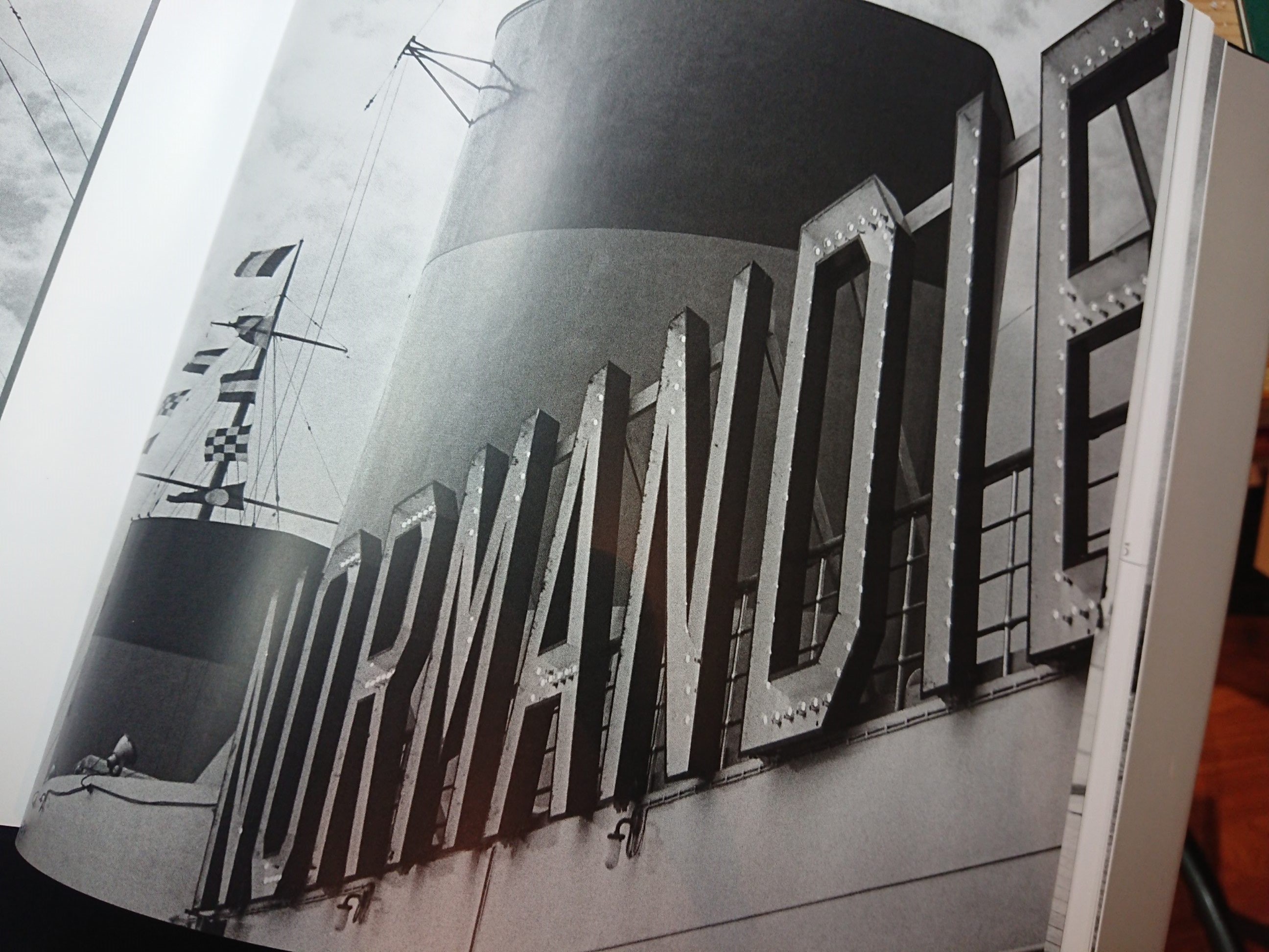

The real thing -- close up -- looks like this
Noteworthy is that the sign is a U shaped box section-- braced longitudinally on the reverse
with light-bulbs arranged to reflect the light within the U-box. The sides and back are painted black.
I decided against the light-bulbs... ( this is 1/700 !!! :big_grin: )

Sweet mother of pearl. Fantastic details. I love what you did with the ships name.

The name looks great! Sometimes, the look and feel of items is more important to the final result than absolute metric accuracy. I think you made the right choice here.
