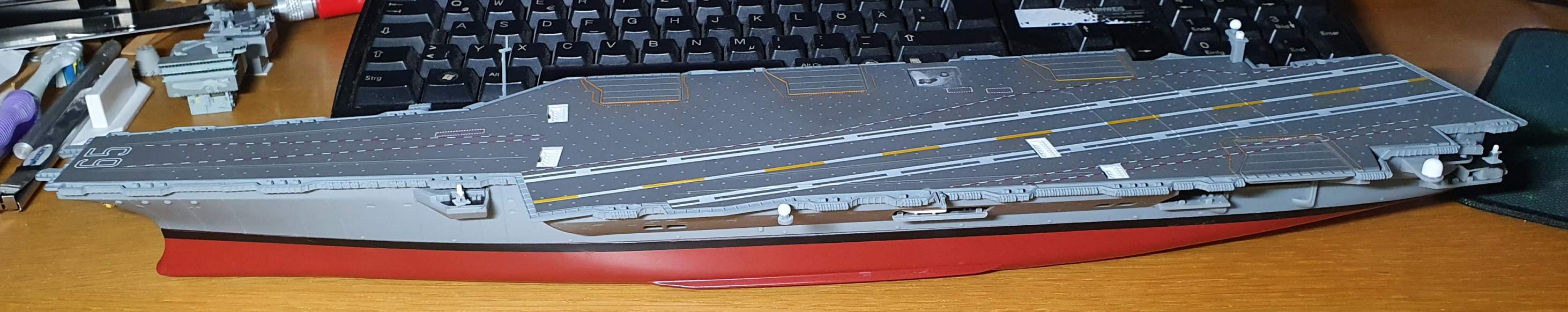

On the other hand...
I'm thinking now of modifying the FoV/Unimax to the 1970s configuration.
Using the Revell island as a reference.
What do you think about this?

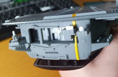

Hi,
Started some modifications on the Forces of Valor / Unimax / Waltersons USS Enterprise (see below).
Removed flight deck and island. Stripped island to basics to make the beehive design.
Does anyone have detailed dimensions of the island or even some CAD files?

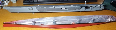

Hi Mark,
Fortunately, the FoV model can be easily modified to waterline configuration.
The lower hull is fixed with 4 screws and the split is right above the black waterline. However you have to cut the screw bosses flush.
Separating the deck is easy, as it's only glued at a few points, mainly at the beams next to the elevators. Separation of the island is more challenging.
If interested, I can show how the stuff is assembled and how to tear it down.
A big advantage of the new revision by Waltersons is that they did not paint the medium grey color like upper hull, island, catwalks.
Juergen

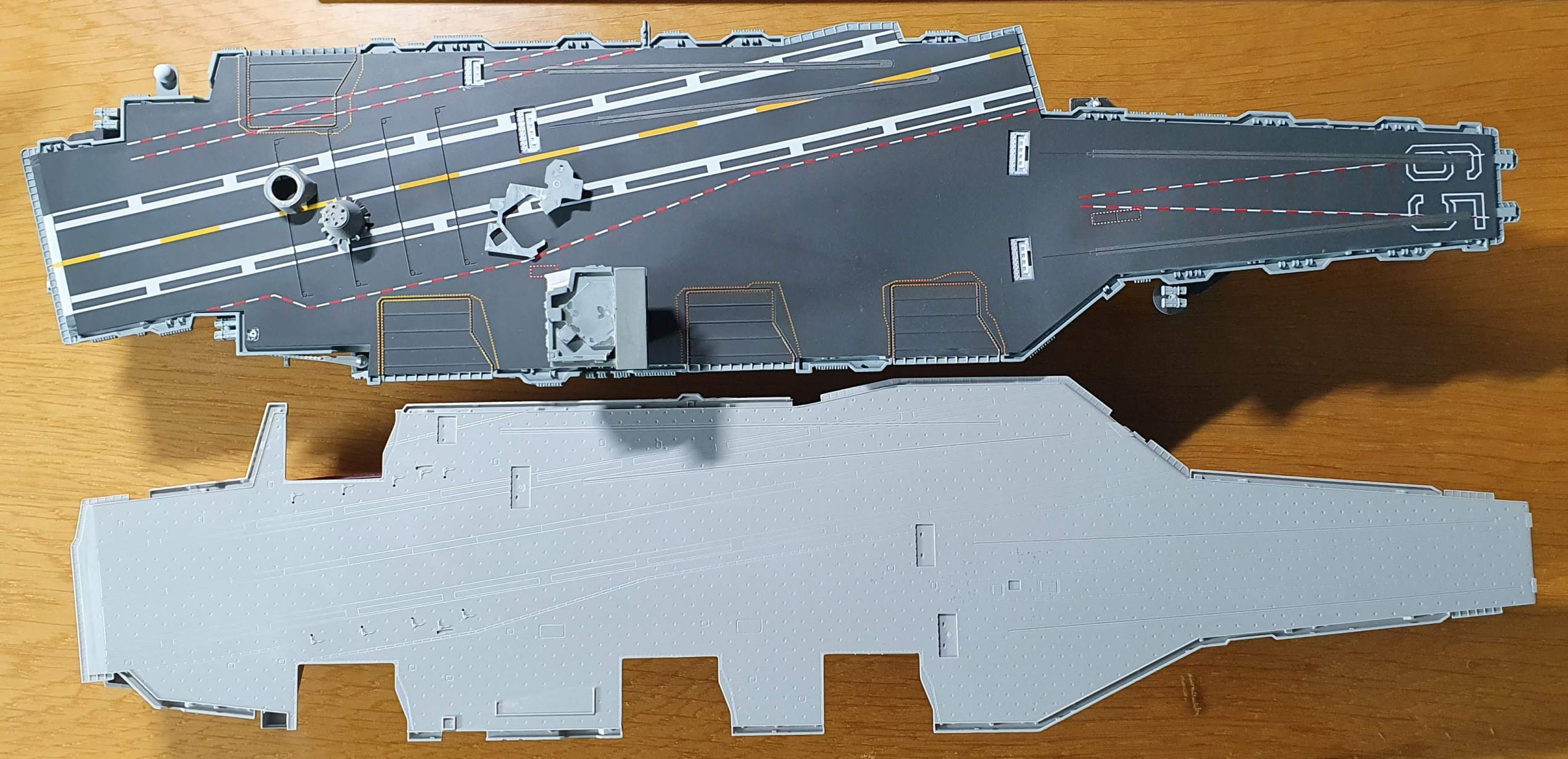

To all, who might plan to use the Forces of Valor stuff as a basis for a good model.
1. Used plastic material is much harder than standard Polystyrene. Maybe Polycarbonate. So it's hard to cut and some glues might not work properly.
2. The elevators do not align properly with the upper hull. So cutting out an elevator, you will need to do big modifications. See attached picture of removed No. 2 elevator.
Juergen
