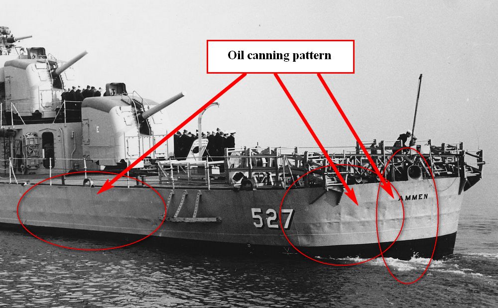

On the other hand, the two pics of USS Ammen are of particular value, as they show clearly what the pattern for the oil canning is in the stern areas, with sections differing in length:
This is backed by one of the few pictures that I had previously found, that shows not only severe oil canning effect, but the very same thing in sections length:
USS Ammen pics also confirms the oil canning pattern of the Fletcher class that can be seen in this pic of Velox showing again severe oil canning effect, along with the absence of it on the 1/2" plates around the machine and boiler rooms --as it has been already discussed in this thread-- and also under the screw defenses.
And shadows aside, this other picture shows clearly the vast amount of beating that these Fletcher class plates could cope with.

After studying carefully the last pictures, I have come to the conclusion that --even if by no means similar to the upper surfaces--, there was actually noticeable oil canning under the waterline before the bilge keels:
I don�t know how did USS Ross get her battle scars in this area, but I can very well imagine that this is the way USS Stembel was getting her own ones in september 1954:
I could live with the previous, already discussed canning mistakes, but honor is now satisfied, and my life, easier. :nod_2:

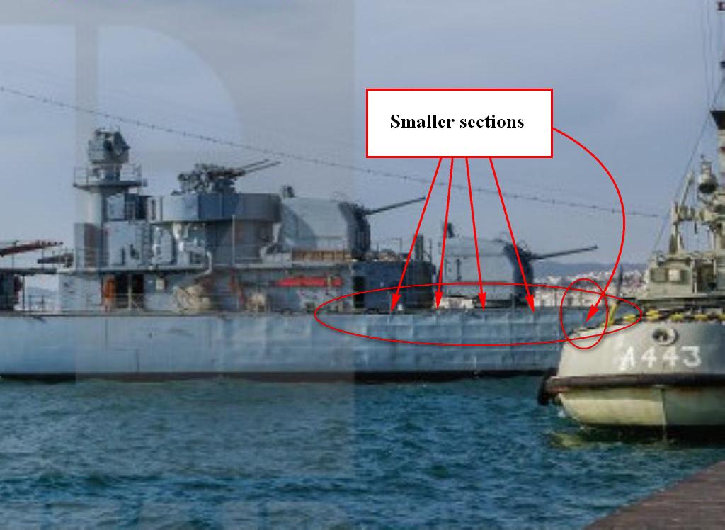

After the study of the Fletcher�s transom using the pictures of USS Cassin Young and USS Ammen, I decided to use this kind of grid, displaying five horizontal sections:
Once this was done, I came across this other picture of Velos, the former USS Charrette. Even if very blurr, it is invaluable to show that the oil canning grid in the stern parts of the ship is way more complicated than I had noticed before. This is what I mean:
This led to a further research, and I found more evidence:
I have to say that I was not sure at all about the vertical thinner section highlighted in the pictures, and supposed at first that it would be an effect of oil canning, but USS Ammen has got it too in the same position, confirmed by other pictures of other ships, and this solves all doubts:
This other picture of good old Velos/USS Charrette shows again that the transition from boards to transom is again more complicated than it seemed at first:
I was really surprised at first of the high freeboard of Velos and USS Cassing Young, until I realized that they are museum ships, with no ammo, fuel or water on board.
With all the info gathered, I think this is what has to be done, the bigger sections being 11.0x4.5 mm. and the smaller ones reduced accordingly. Some of the fore sections will also be doubled:
I would appreciate any input on mistakes that you can see, before I start cutting.
TIA, and again best regards from this side,
Willie.[/size]
