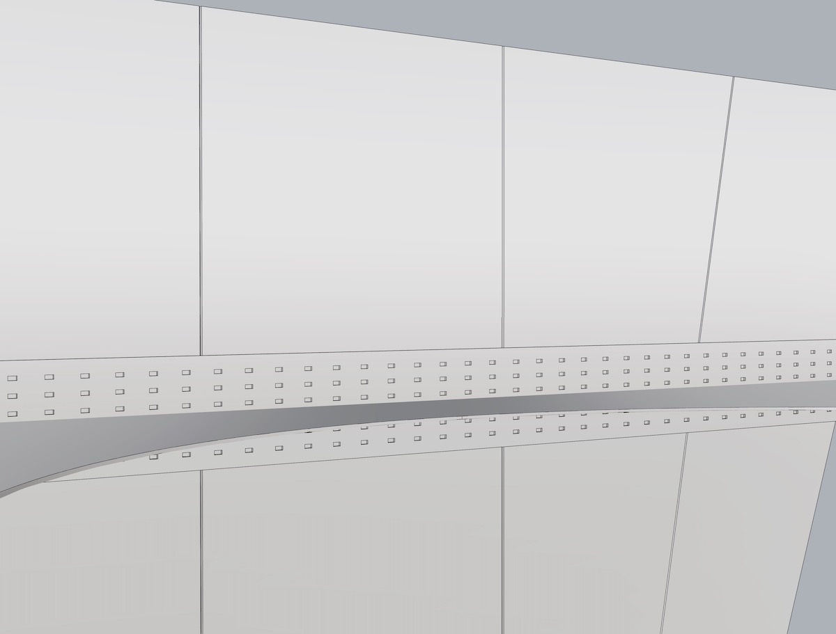

There are a number of places where the engineers went crazy with unnecessary complexity in the Iowa class. Here's one that took me a couple of months to sort out.
The Upper Belt ends at FR166. The Lower Belt plates have a different configuration aft of FR166 than forward. Aft they are 13-inches at the top. Forward they are 12.1". Due to their configuration, the aft plates are thicker than the forward plates at their top and bottom while the forward plates are thicker in the middle.
The plates were welded together using scalloped straps on both sides. It was felt the joint needed to be flattened. This illustration shows what they did. At the top, the aft plate was planed even with the forward plate.
In the middle, both plates were planed down (it would have been simplle to just have planed the forward plate). The edge created on the forward plate was beveled.
At the bottom the aft plate was planed then beveled down to the forward plate.
In the middle area the strap welded over the joint is forward of the bevel. In the bottom area, the strap has to be shimmed.
A) They could have welded the two plates together directly (which would have been stronger than what they did).
B) They could have shimmed the entire joint and skipped all the planing.
C) They could have done a lot less planing to even things out.
