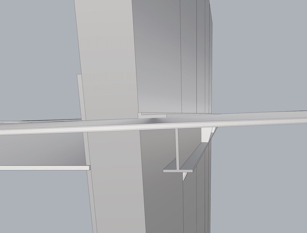

This shows the forward face of the transverse armor. The seams between the armor plates (angled but close to vertical) have slots in the them Vertical supports were inserted into the slots and a beam was welded between them. The beam supports the third deck.
An L-bar was welded to the the third deck on the upper side that butts up against the armor. The L-bar is not welded to the armor.
Note that the third deck takes a large step down at the armor. The step is not visible because there are no openings in the armor plate. The Third deck shelf runs outside the citadel on both sides. At its forward end, the shelf joints the third deck flush. As it moves aft, the shelves descend below the third deck.
