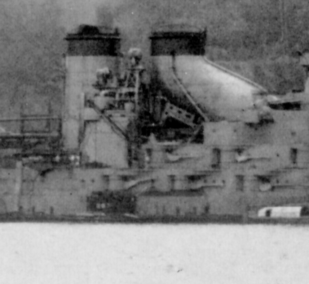

The Ishibashi book indicates that both ships did have this director arrangement. And then I found this:

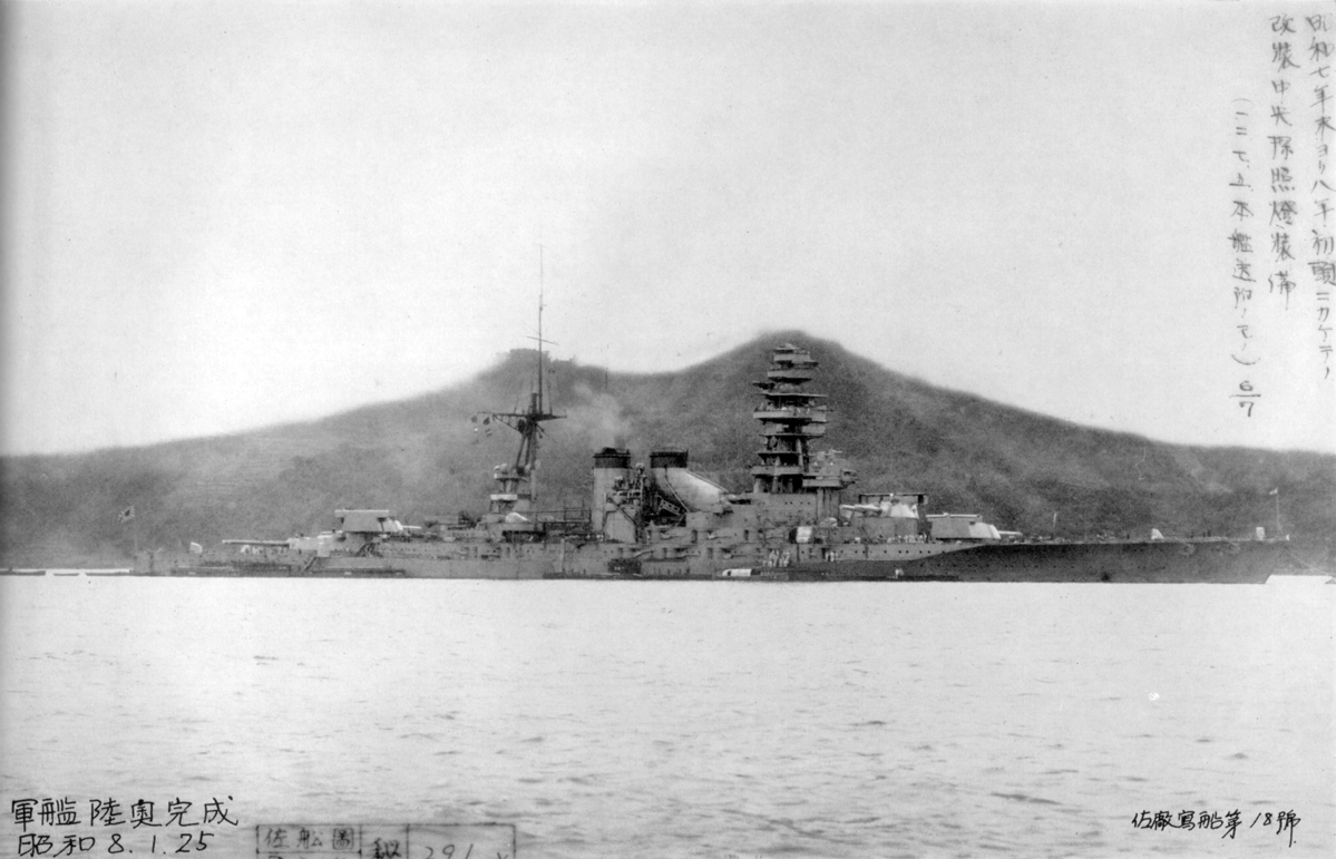

There IS no as far as I know a picture of IJN Nagato in this configuration. Only far afar picture with crude details. But Aoshima(surprisingly) is correct in the "solid" rangefinder base and searchlight platform for the IJN Nagato both 1927 and 1933 version.PetrolGator wrote:Wouldn't the rangefinders have been added at or around that time? If they need to be deleted from the build, that's fine. If not, is the shape present in the Aoshima kit correct? The TROM isn't clear.
I've found evidence of the searchlight platforms present on NAGATO, but the photo of MUTSU with her twin funnel configuration and midships (127mm?) rangefinders present seems to be the only time I see all these features in one place.
