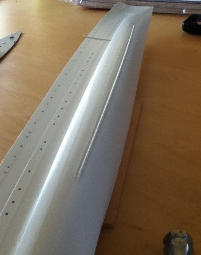

Re: 1. removing the belt, I removed the belt from my 1/350 Cornwall in order to backdate her, then drilled out all the portholes.
To do so, I taped around the belt, shaved some off with a blade attached to a shaped jig I made, that didn't work too well so I made a guide from a dremel part and then the dremel slid and reduced the bulge; then I sanded the remainder. The difficult part is matching the curve from the bulge to the slope of the hull side, but it is possible.

Hi Maarten - I skimped on the portholes! Exhaustion set in after the hull and "she'll be right," took over. I added a few smaller ones aft of where the torpedos will go. The model now has superstructure basics done and a custom wood deck cut out for it.
I'm going to have to repaint the lower hull as I suspect it will be grey in China Station days, so maybe look into portholes then. Any Cornwall plans from early 1930's out there?
The hull separation sounds a little daunting: I used surfboard shaping skillset to see/feel the curves and the interaction with the sheer of the hull. I guess my mind/hands are most at home doing it this way.

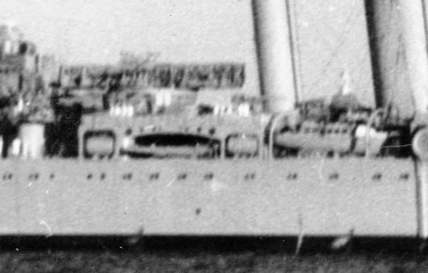

Rotley, I would suggest you check late images of Canberra to ascertain the boat positions, they changed from her early boat layout and she shipped less boats.
In 39 her boat compliment somewhat mirrored the OH GA, the strbd Admiral`s barge was landed sometime late 39/early 40, from that time she shipped no boats of that design. The 35`early design motor boat was moved forward to the midship Admiral barge location, no boat was fitted in the original position from that time onward, she also shipped one of these boats on the port side location.

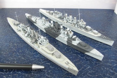

Here my interpretation of HMS Dorsetshire as in May 1941 (80 years sinking of Bismarck):
I used the Aoshima kit (052693), photo-etched parts by Tom's Modelworks and Aoshima, gun barrels by NNT and Master, light AA guns by FineMolds, and the Walrus by Flyhawk.
More about the real ship and the model (in German):
Heavy cruiser HMS Dorsetshire
with HMS Kent and HMS Berwick
