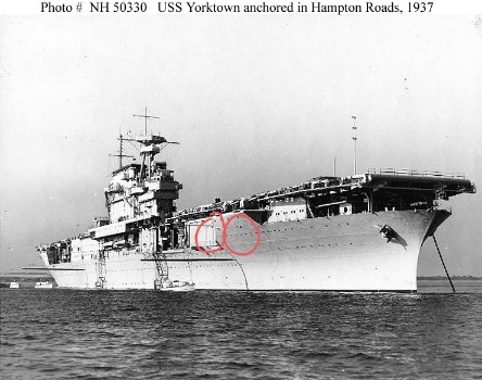

TF17Greg
Posts: 419
Joined: Mon Dec 07, 2020 7:02 am
Re: Calling all USS Yorktown CV-5 fans
Post by TF17Greg »
Dear all thank you for your help...
as u can imagine l still have some questions on the hull
So here it is
I found this picture of Yorktown with 3 exhaust of cooling engine water (hope l�m saying it right)
Were there more than 3?
If yes you have an idea where?
Thanks in advance
Greg
CUT...FILE...GLUE...PAINT...WEATHER...AND...REPEAT :wave_1:
Follow me on YouTube https://www.youtube.com/@Fullmetalpainter
