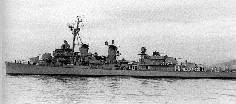

Actually the font was different from that in the US Navy. This is Lepanto, former USS Capps:
Regarding yuor question:[/size]

It would seem to have been different styles of text (especially of the number 2) in use over time:
Posts: 5068
Post by Fliger747 »
Good observation on the numbers! Lepanto is an early round bridge Fletcher, a lot of steaming miles there! In the lower photo familiar Motor Whaleboat!
Willie

Amphion wrote:It would seem to have been different styles of text (especially of the number 2) in use over time:
The hull markings in the Spanish navy changed from the traditional only shaded hull letters to only rounded shaded numbers in white, then to rounded letters and numbers in only white; then to angled US Navy-style markings in only white, to shaded angled US Navy-style markings; then to shaded white rounded Spanish markings, then to shaded grey rounded Spanish markings and finally to grey-only rounded Spanish markings, as they are nowadays. Lots of stuff to study and a headache to follow up. I have never been able to trace the exact dates, but there are examples of all this.
I am trying to reproduce Jorge Juan in the, say, late 60�s-mid 70�s, when in full commission in the 21st DesRon, with the modified rear stack, so this corresponds to your picture nr.2, rounded shaded markings. Too bad: had they been angled US Navy markings, things would be somehow easier again.
There is a curious anecdote with Jorge Juan: when she was commissioned in the Spanish Navy on Dec.1st 1960, she had no hull markings, other than the name McGowan in her transom. Notice the Spanish navy ensign and the American name.
Jorge Juan should have had a "45" painted on her hull, but if she ever received it, it had to be for a very brief time, before she was given her definitive "D25" some months afterwards, in 1961.
So, for some time she sailed like this, the only Spanish Navy ship with no pennant number and an American name. Wonderful.
Nice going and very best regards from Spain,
Willie.[/size]

Willie:
Of course it would be entirely correct to have no hull numbers! Easily identifiable in the fleet as the ship with no number!
