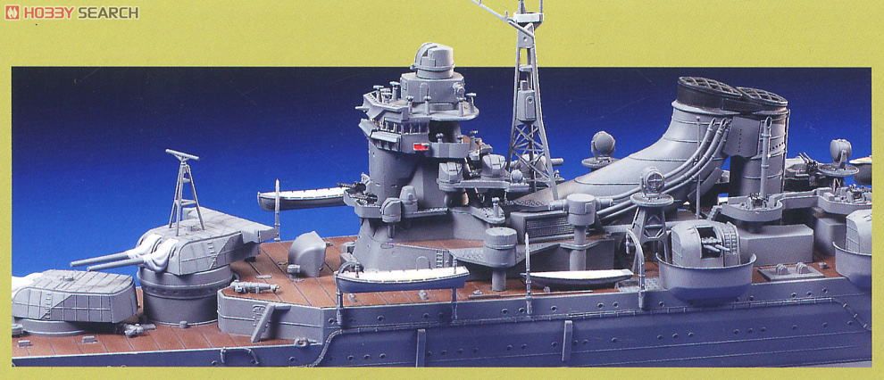

I am currently working on Tamiya's 1/350 Mikuma Light Cruiser and I have already built up most of the hull and superstructure subassemblies. However, I am now contemplating on converting her to her heavy cruiser version. I have the complete sprues of the Tamiya 1/350 Aircraft Cruiser Mogami Kit that has been a victim of recent flooding and I plan to use her 8 inch guns for the conversion. The Mogami mast sprues also have a tub-like structure that probably represents the torpedo control station. My question is, aside from replacing the guns and possibly adding the tub-like torpedo control station to the mast, are there any other changes that I have to do to the kit? I am not very particular with the period, as long as it is at the time when she had the bigger guns and least number of modifications so as to suit my novice modelling skills LOL. Thanks in advance.

The only things that come to mind are the addition of windscreens to the bridge (see the Mogami CA pic), and a couple of Aichi E13A seaplanes. If it is a wartime fit, you will also need to add a degaussing cable.

Thank you very much for this info Dan, forgive my ignorance of nautical terms, I'd like to clarify if windscreens are the same as wind baffles? If yes, I think they come as parts R20 on the Mogami sprue and maybe I could adapt them to fit on my Mikuma's bridge (?) Thanks.

The things that extend forward of the superstructure below the bridge are "venturis." They capture air blowing against the superstructure and deflect it upward. The rising air mixes with air coming over the bulwarks and deflects it upward, forming an invisible "wind screen." It really works! I have been standing on the open bridge in rain squalls and the rising air from the venturis deflected the rain over me.

Different navies refer to it differently. Venturi is actually the wind effect. Windscreen or wind baffles also works.
The important thing here is that only the lower baffles were added by Midway, and the top of the bridge had not yet been transformed into an AA command position. IIRC, the L&W IJN cruiser bible does not point at that baffles were added before Midway, yet the photos clearly bear this out.

Dan thank you very much for that picture, I was about to ask the same exact question: I plan to replicate Mikuma in her 1942 fit when she was sunk and wanted to ask whether she should be represented as in Picture A in the link below (Fujimi's 1/700 version of Mikuma 1942) with wind baffles both below and above the bridge windows and presence of numerous binoculars on the topmost level of the bridge, or picture B where the wind baffles are only present below the bridge windows and the topmost level of the bridge doesn't have any binoculars. Based on the picture you have shown and another Midway picture of Mikuma as posted below, I think it's safer to copy picture B for a 1942 fit. Many thanks again for the help.

My pleasure. Choice B for certain.

Hi. With regards to Tamiya's Mogami, incidentally, the picture B that I showed is from a demo shot of their assembled 1/350 Mogami kit in her 1942 heavy cruiser fit (link below). It appears that they got the demo sample right but made an error when making the instructions. It's easy to rectify this however, since the parts for the plain topmost platform without wind baffles is also present in the kit's L sprue... part L26 if IIRC.

Ooops, apologies, I sent the wrong link, this is the Tamiya demo model I was talking about, it has the baffles only below the bridge windows:
https://www.modelsport.co.uk/product/ta ... uns-427391
https://www.modelsport.co.uk/_images/pr ... 023_05.jpg
