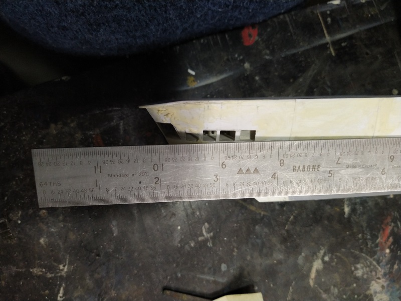

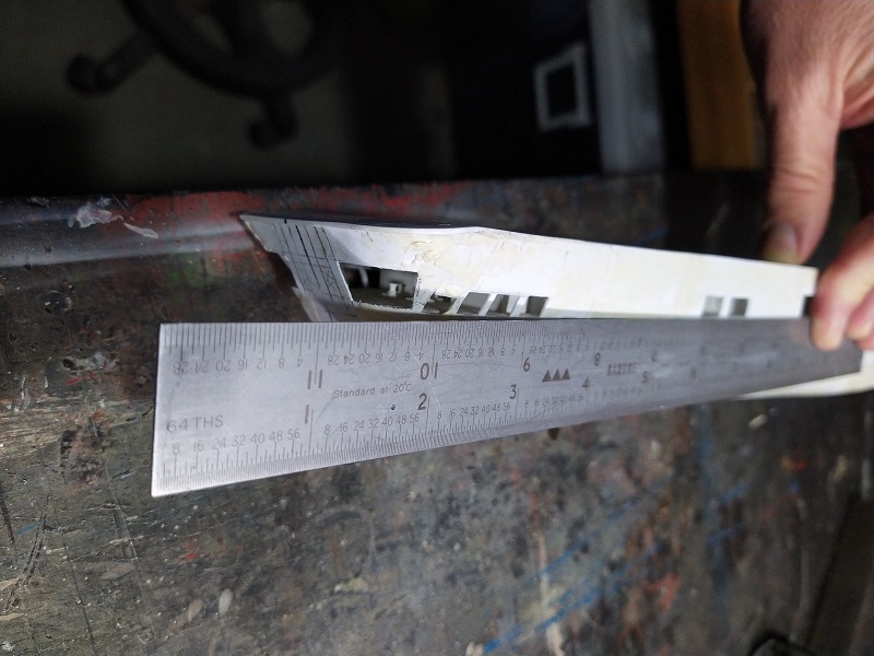

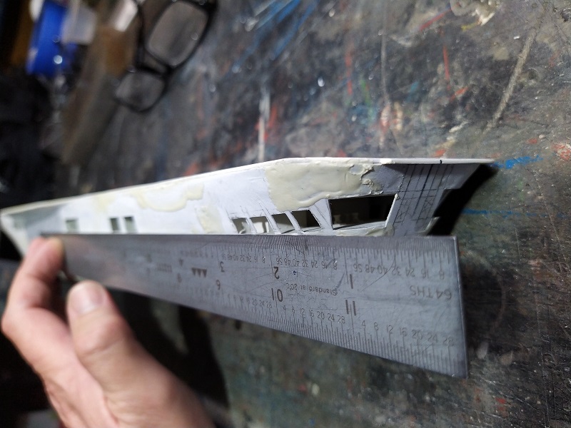

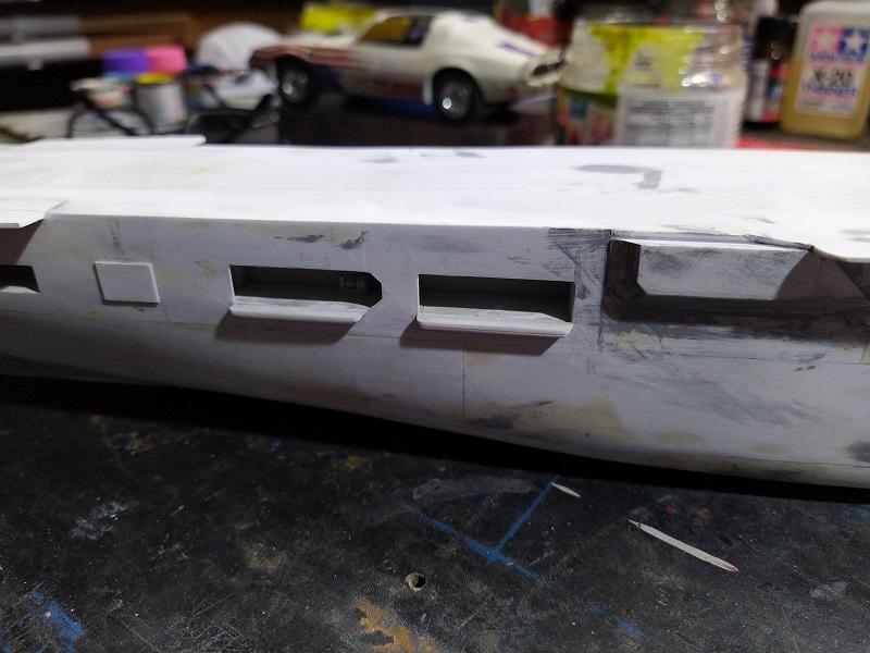

Well the story goes a bit like this....this is my very first scratch build and I am learning a lot, and I mean a lot.
Deck 3 isn't flat and even though to start with I scribed the top and bottoms of the openings with something akin to a compass I discovered that some of the non-flat locations coincided with the openings. Deck 3 isn't flat because the styrene sheets I used where too thin (1mm) and too soft (Damn Evergreen!). However.......the quarter deck is an especially big problem because it curves up slightly towards the stern. It wasn't meant too but it did. I attempted to fix it but not nearly well enough. I definitely have to go back over the quarter deck openings and level them with respect to each other and somehow find a way to hide that pesky little slope. Maybe all the airplanes on the flight deck will draw the eye away and no one will every notice except for me and you lot with your keen eyes :shipcaptain:

Bonobo_Atho wrote:Well the story goes a bit like this....this is my very first scratch build and I am learning a lot, and I mean a lot.
Well, sir, hat in hand! You ARE learning a lot! And so do all of us if and when we pay attention to what you are doing.
Indeed, well noticed, on the longitudinal section drawing (I suppose you have these?) of the Colossus/Majestic class the decks ar all perfectly straight, no sheer whatsoever.

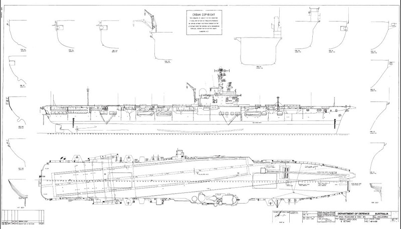

I have been building the ship from the image below, which I purchased along with the drawings for HMAS Sydney from the Naval Historical Society of Australia https://www.navyhistory.org.au. The HMAS Sydney drawings included a plan of deck 3 showing the layout of the galleries, hanger, and quarter deck. I don't have any longitudinal sections in elevation.

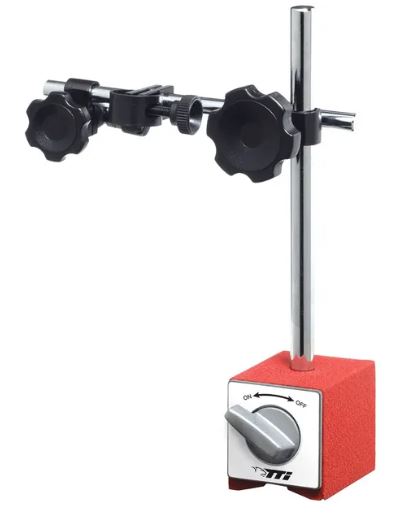

I don't have a compass but I do have a pair of metal dividers. What I think would've be ideal though is a mag base with a pencil or scribe attached to it.
I agree the problem lies with the balsa under the deck. I installed it vertically between the frames when maybe I should've laid it flat parallel to the deck (i.e glued the deck sheet to a large flat piece of balsa. And instead of making frames I should have used negative patterns of the frame???
As for the shear in the quarter deck I may just file what I can so that the bottom of the openings are all level and then repair the top of the openings to match.

Well,
It's not the Melbourne, but the Karel Doorman instead, but here you can find a rather complete set of drawings (44 of them) of such a carrier:
https://www.nationaalarchief.nl/onderzo ... ~3190-3233
Let me know when you need any help for the explanation.
You might find this one useful too: https://prints.rmg.co.uk/products/inboa ... 1956-m0595 and4
https://prints.rmg.co.uk/products/no-2- ... 1956-m0598
If you want a higher resolution, it's going to cost you some money though... :heh:
And here you find a set of drawings of HMS Colossus before she became Arromanches:
http://3dhistory.de/wordpress/warship-d ... -colossus/

DavidP wrote:Bonobo, how flat/level is the flight deck except for the extreme end as that is what the compass/divider will slide across while scribing the hull openings? which way does the balsa wood grain under the quarter deck go, starboard to port or along the length of the model?
viewtopic.php?f=13&t=214450&start=43
The answer can be found some pages back: I believe left-right (or port-stbd), not lengthwise.
Bonobo used the balsa as a filler material, after all the frames were set. Personally: I rather use the balsa structurally, lengthwise, using its fiber strength as a construction material, as a strong core for the hull. I don't use the fysical frame formers as Bonobo did, but I use (thick) paper counterforms, to cut the balsa core into shape. So the grain stays intact. I also ususally don't use sheet plastic to skin the hull, but Evergreen strips, as these can be plied over curves much better. The more pronounced the curves, the narrower the strips I use.
But this talk is now not relevant, as the hull is there already, the point is how to correct the shape of the deck. I think using a (coarse) file is the best way to do that, refining with sandpaper on a sanding block, or sanding sticks, to finish it off.

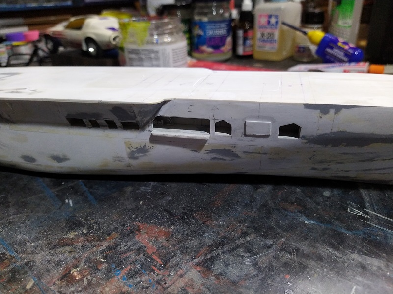

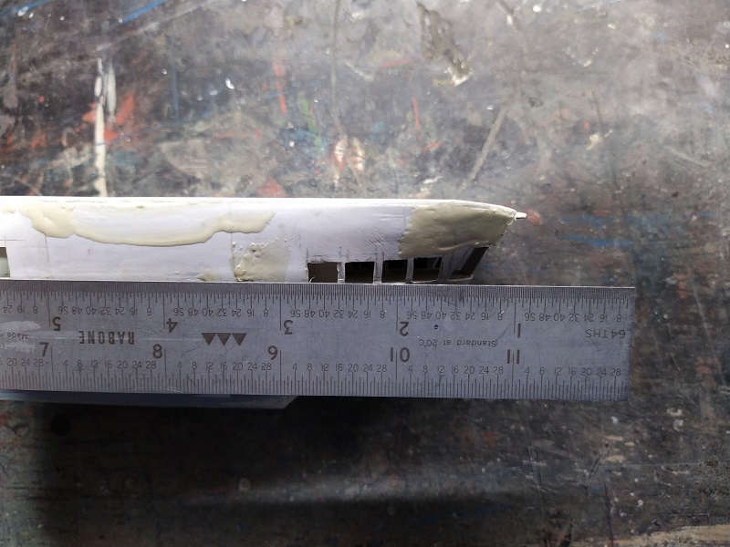

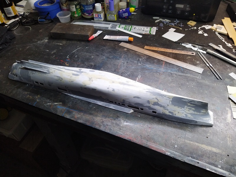

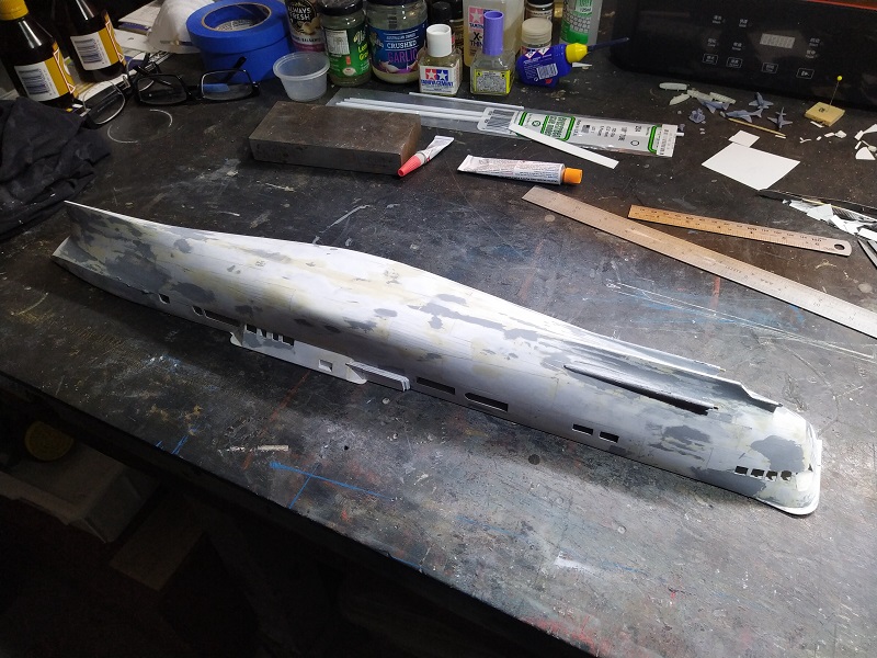

Last few days progress has been focused on filling and sanding the hull. Mostly done except for some detail around the bow, the stern openings on the quarter deck, and the prop shaft fairings.
I'm still considering what to do with the level of the openings on the quarter deck. Interestingly I am using Tamiya putty as the filler and haven't been through a whole tube yet. Hopefully next weekend I can put a primer coat on the hull and see where more fairing is required.
To answer a question in previous posts I have used several brands of polystyrene cement and found they all glue styrene to balsa very well. I have used it almost exclusively on this project except where I wanted a quick joint. Historically I have used the Revell cement in the neat little applicator but in the last few years have started using Mr Cement and Tamiya. Each one has an application they are best suited for.

Persistence a most important attribute. I an fortunate to have one of the magnetic bases. My table isn�t metal but wood. The most important part being smooth and level. Scribing waterlines is it�s main use, though I did use it with a dial gauge to measure disc runout on my BMW. Keep plugging away, you will find many techniques that don�t work and some that do. I have in the past chopped off major sections and started over. As to printing your planes and props, orientation and placement of supports critical. With my new printer, no supports needed for the props, which now leaves both sides smooth.
