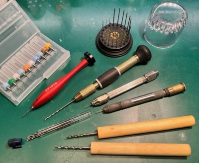

wefalck wrote:
Did you use an electric drill ? The drill-speed may have been too high, melting the plastic, which in turn leads to drill run-out. A pin-vice is better for this.
Nope. Just the regular collection of pin-vices and bits.
