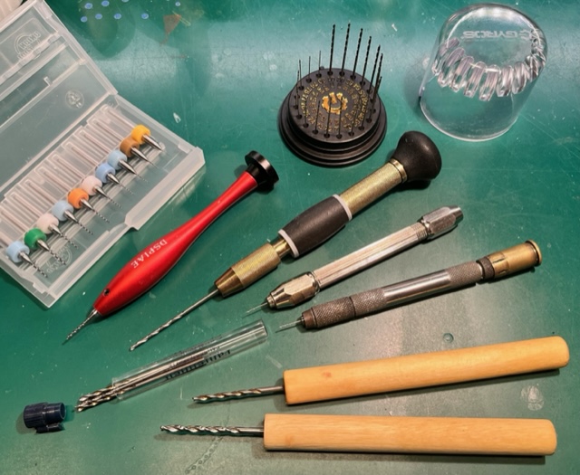

I've never built anything in 1/200, but I've done lot of portholes in 1/700 which I assume is no more forgiving.
Typically I'll mark out the horizontal centerline with some type of hard edge tape https://www.amazon.com//dp/B00B8GQRHK ( or Dymo tape, scribing tape, even masking tape sometimes) and then mark the centers with a needle tool of some type https://www.amazon.com//dp/B0028MV9G2 to center the drill bit before drilling with a pin vice.
Links above are similar to what I use, but not necessarily specific recommendations.
Related - I'm really not much of a fan of the newer drill sets with tungsten carbide bits. https://www.amazon.com//dp/B07G6STHKW I can't even keep one on the desk top without the bit breaking. Strongly prefer regular old carbon steel bits for smaller sizes.

Carbide drills are not made, indeed, for free-hand drilling, they don�t like lateral forces.
Did you use an electric drill ? The drill-speed may have been too high, melting the plastic, which in turn leads to drill run-out. A pin-vice is better for this.

Nope. Just the regular collection of pin-vices and bits.wefalck wrote:Did you use an electric drill ? The drill-speed may have been too high, melting the plastic, which in turn leads to drill run-out. A pin-vice is better for this.
