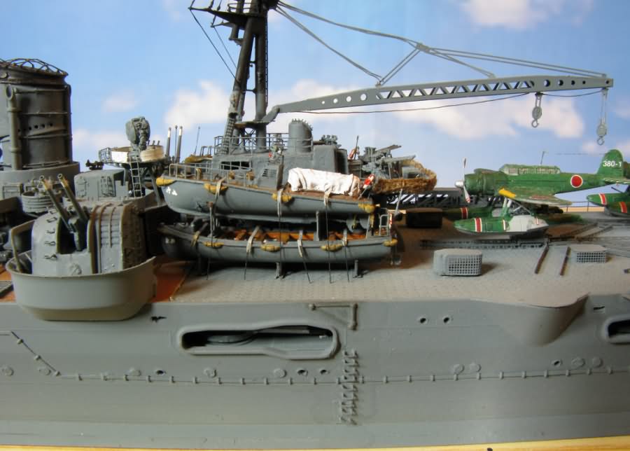

Mogami143<br />2. catapult added
Mogami143
2. catapult added

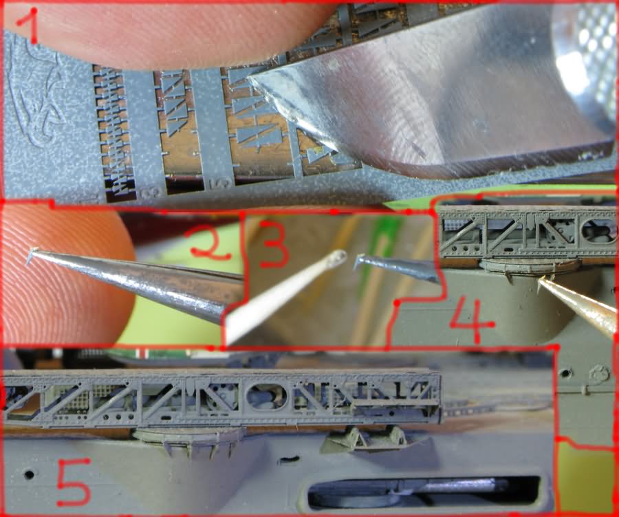

Mogami144<br />Adding more details to the port catapult
Mogami144

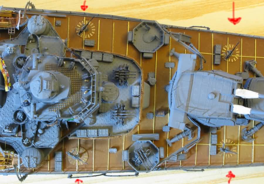

Here my last progress:

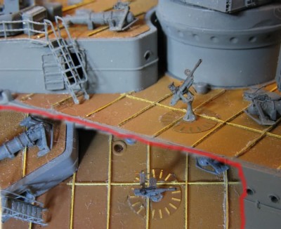

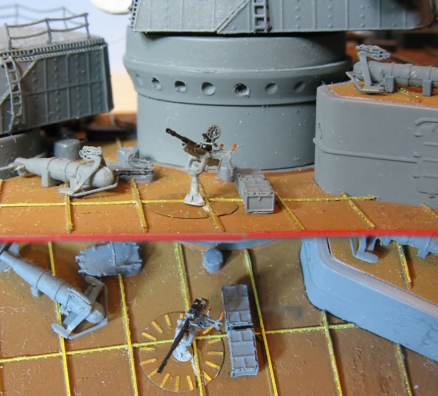

This is the procedure I used for adding positions for single 25 mm guns on the linoleum deck.
I airbrushed the Veteran Models parts (Mogami145-1) with WEM linoleum paint (Mogami145-2). Then I removed the paint of the prominent areas with a scalpell (Mogami145-3).
Mogami145
Mogami145
Now I removed a slice (width of a brass strip) (Mogami146-1) and another one (Mogami146-2).
Mogami146
Mogami146
Mogami147-1 shows the target area and Mogami147-2 the same area after adding the four parts.
Mogami147
Mogami147
Here the same position with the gun and ammo boxes.
Mogami148
Mogami148
The next pictures show two more examples.
Mogami149
Mogami149
Mogami150
Mogami150
Also obvious is the dust. I found out that a airbrush pistol is very effectiv in removing the dust.

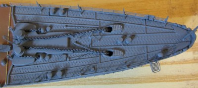

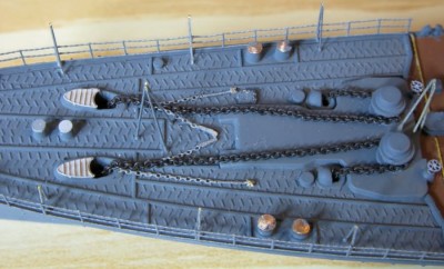

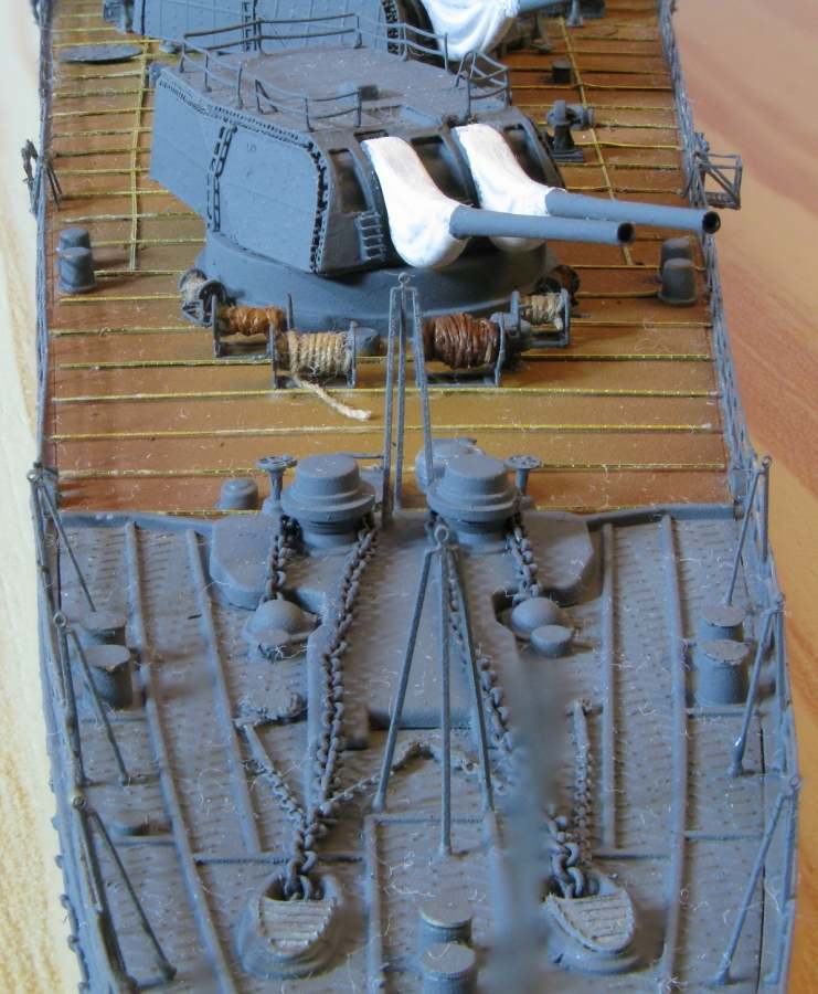

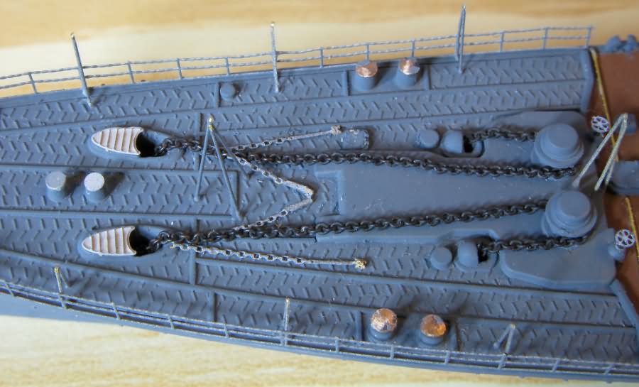

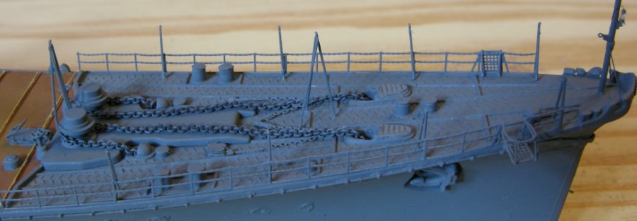

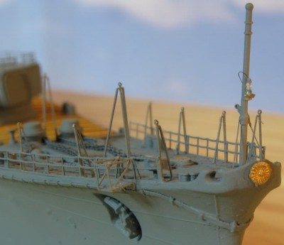

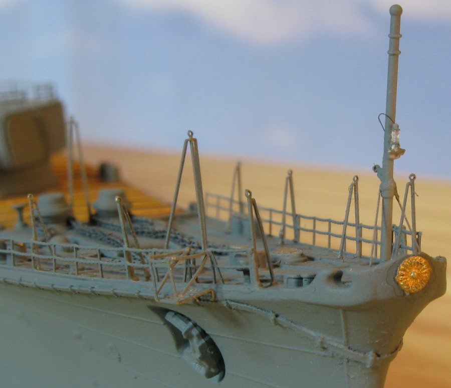

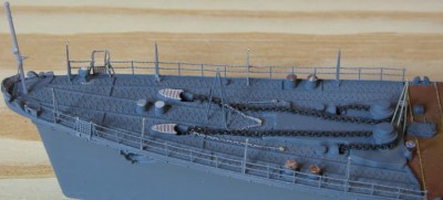

I added anchor chains and some details to the fo'c's'le.
Before final airbrush:
Mogami151
Mogami151
Mogami152
Mogami152
After final airbrush (Weathering will come later.):
Mogami153
Mogami153
Mogami154
Mogami154
Mogami155
Mogami155

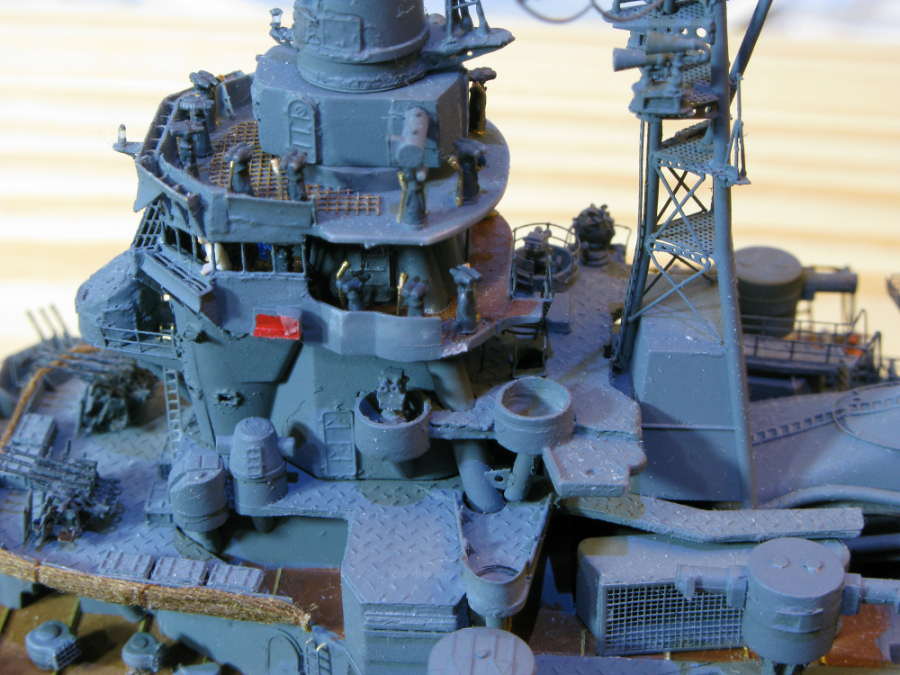

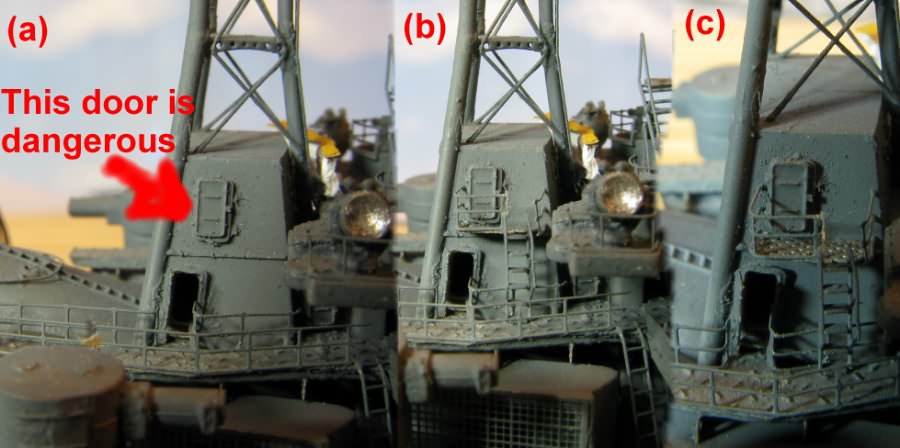

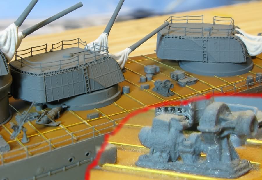

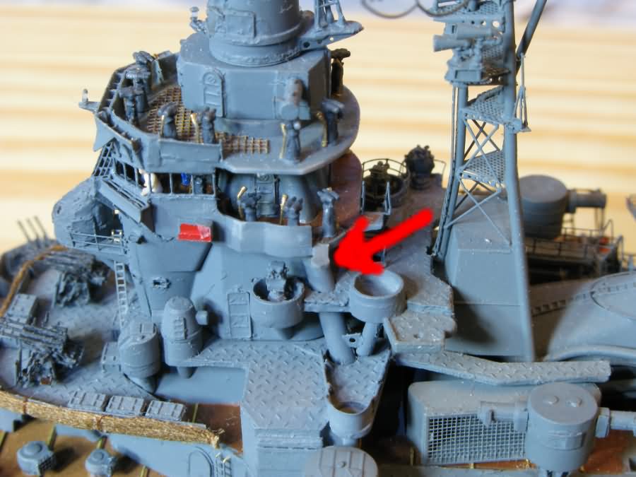

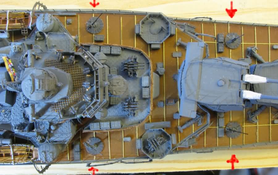

Mogami156<br />Signal platform (highlighted by red arrow). Too coarse, it has to go. I need plastic surgery here.
Mogami156
Mogami157<br />Fortunately, I have the appropriate tools (and the necessary cojones). Here you see my very fine pliers just before action.
Mogami157
Mogami158<br />Job is done. Platform is gone.
Mogami158
Mogami159<br />Same location with new platform and additional details
Mogami159

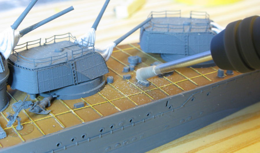

At this state it might be dangerous to damage the paint and more serious: D U S T
Here the new part in position (deck winch from Veteran Models).
Mogami162 Camera sees still some dust after cleaning with a brush
I used a brush to remove the dust and for my eye (even with optivisor) everything looks clean. But with the camera: Oh my God!
But then I remembered: I have an airbrush! So I started carefully with 0.5 bar and increased pressure up to 2 bar (nozzle diameter 0.4mm). This gives a strong blast and is perfect to remove dust more effectively (Mogami163).
Mogami163 After airbrushing with &quot;pure air&quot;
Mogami163 After airbrushing with "pure air"
Of course you have to be careful, too much blast might damage the model.

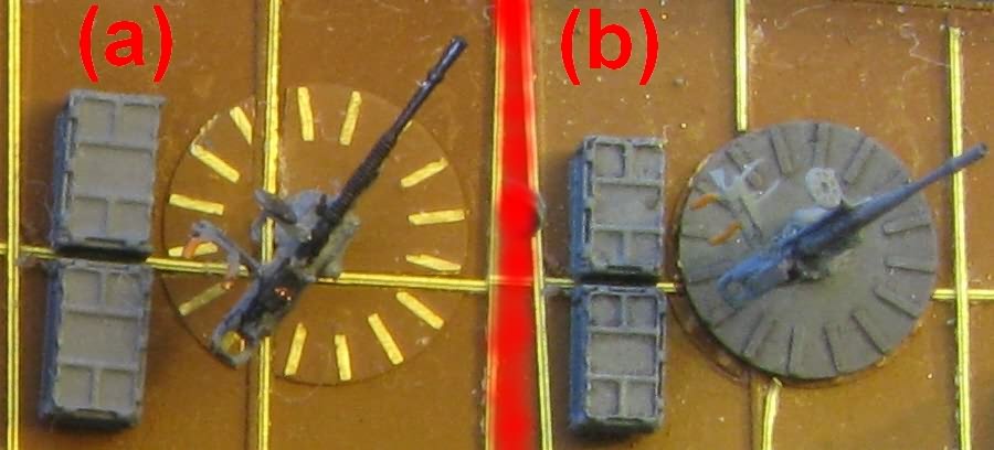

Mogami164<br />(a) before<br />(b) and (c) after improving security
Mogami164
(a) before

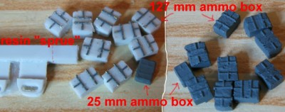

I produced ammo boxes for the heavy AA guns. I used resin �sprues�, grind them to the right cross section and cut pieces. These resin boxes were decorated by two �T� sections (made from hand rails). On the left in Mogami165 there is also a 25 mm ammo box from Lion Roar, just for comparison. On the right the ammo boxes after air brushing.
Mogami165
Mogami165

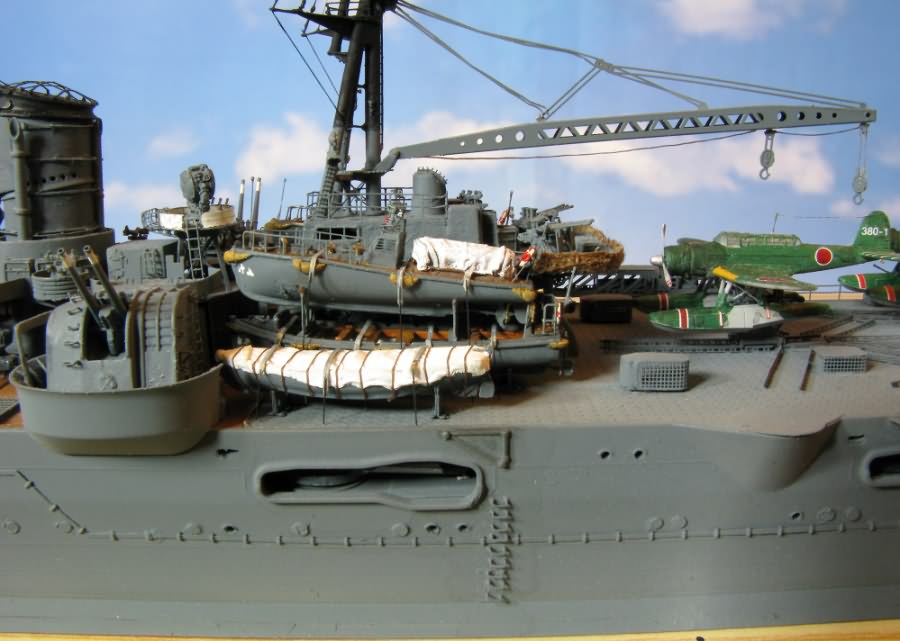

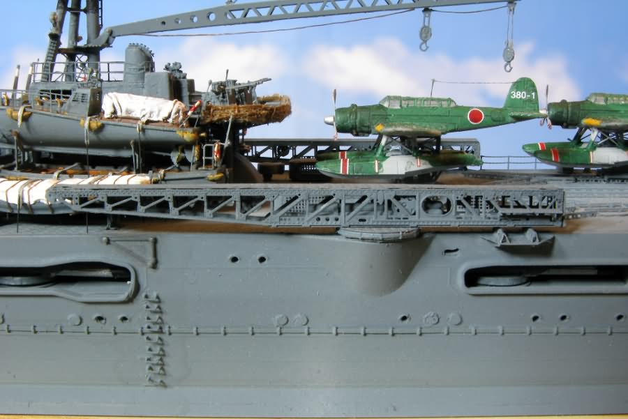

Here a progress update:

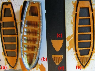

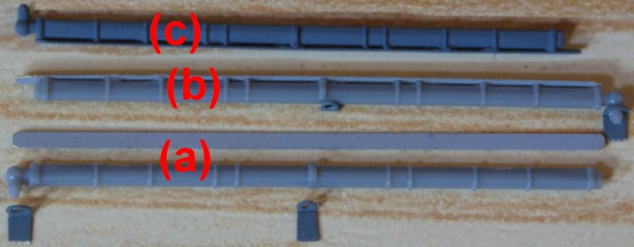

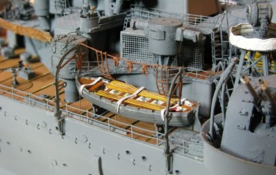

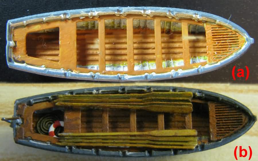

For the last 9m cutter I used the part from VoyagerModel (Mogami166(a)) minus the tip (c) and glued it to the resin part (b). Then I added the tip (d) from the Flyhawk part (e).
Mogami166
Mogami166
This is the result (Mogami167(a)) and after adding more details and a wash with black watercolor (b).
Mogami167
Mogami167
Here the cutter in position (Mogami168).

Just wondering about the bases of 25 mm single AA guns. Shouldn't they be made of steel and therefore painted overall grey (just like the bow deck with welded on antislip steel strips)? I do not have any literature with me @the moment, but I cannot recall seeing linoleum bases with brass mounting strips. I think they should be also placed over the deck linoleum-mounting brass stripes. Please correct me if I am wrong.
Good job with the cutter, I like the rope-ring and the rescue wheel inside of the boat particularly. Nice touch!

donalyah00 wrote:Just wondering about the bases of 25 mm single AA guns. Shouldn't they be made of steel and therefore painted overall grey (just like the bow deck with welded on antislip steel strips)? I do not have any literature with me @the moment, but I cannot recall seeing linoleum bases with brass mounting strips. I think they should be also placed over the deck linoleum-mounting brass stripes. Please correct me if I am wrong.
With the bases of the 25 mm AA single guns I fear that you are right. I think I will change this in the future. Thanks for pointing this out.

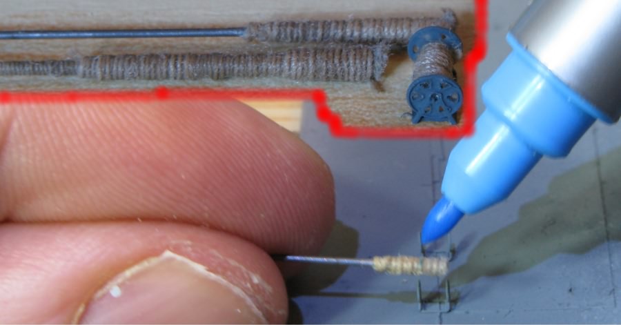

Here is my last progress:

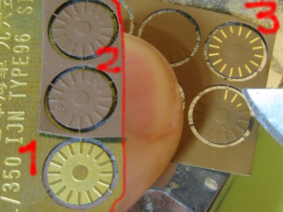

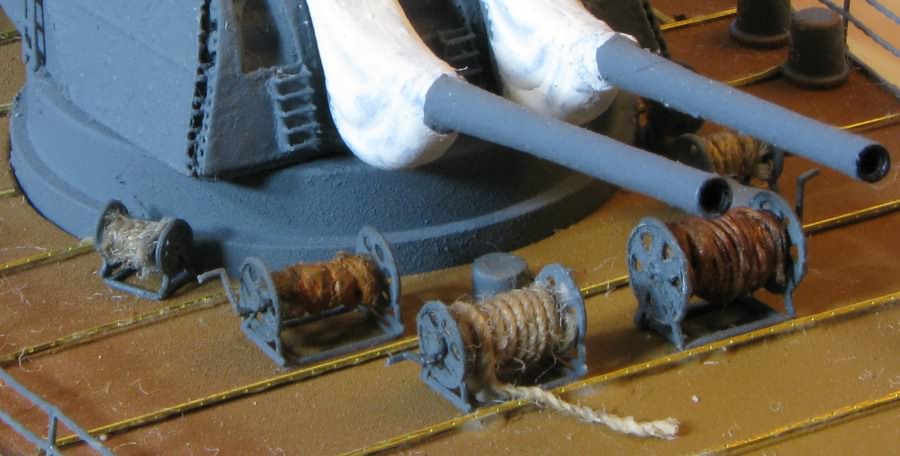

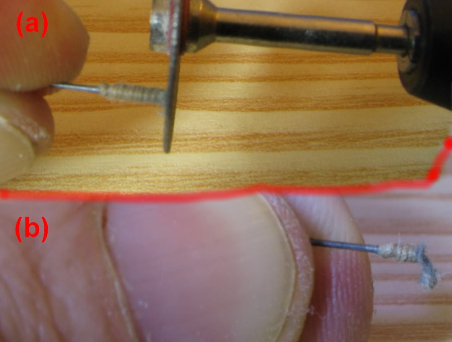

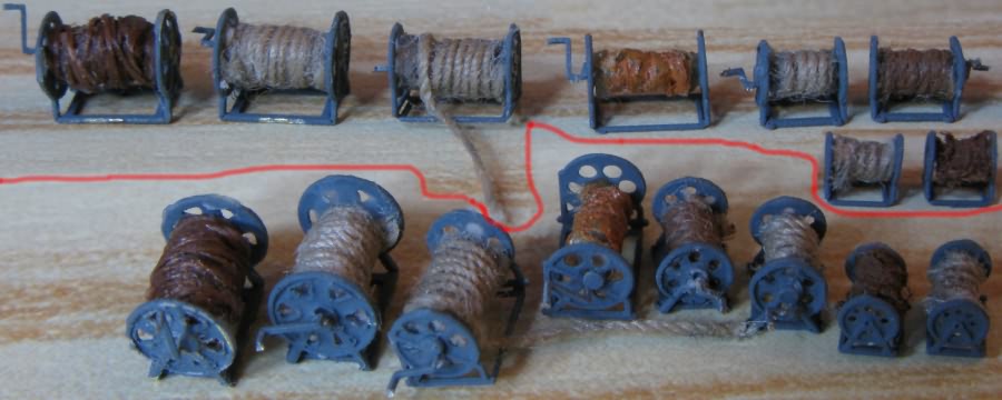

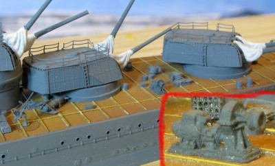

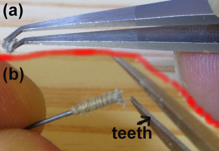

This is the procedure I used to produce cable-reels: I started with a 0.5 mm � steel wire to coil a thin sewing thread. I coiled several layers by using all the time gel-type CA-glue. Then I marked the desired length (Mogami169).
Mogami169
Mogami169
Then I cut this length with a Proxxon (Mogami170).
Mogami170
Mogami170
For cutting the rest of the thread (Mogami171(b)).
Mogami171
Mogami171
I employed scissors and the diamond wheel again to produce even surfaces (Mogami171(a)). The result is shown in Mogami172(b).
Mogami172
Mogami172
Then it was time for my special pair of scissors. Only this type of scissors is effective in cutting the very small thread hairs because it is armed with teeth. The teeth are holding the fine hairs before cutting. I bought this (Fine Scissors - sharp/sharp 'Super-Cut' - 11.5 cm 1652) from
http://protools.be/E_frame.html?http:// ... _home.html
I bought there also the Ultra-Fine Scissors Curved (bowed) - 12 cm Article code: 1025 which is perfect for making very tiny cuts during rigging.
Mogami173 shows the resulting cable-reels.
Mogami173
Mogami173
According to the Tamiya instructions there should be 3 reels on the linoleum covered decks. From the Miyukikai plan it was possible to identify 8 reels. I followed the Miyukikai plan. The next pictures depict 6 of these rails in position.

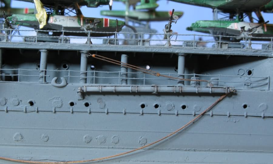

The plastic part for the boom from Tamiya looks quiet good (maybe better then most flatter PE booms).
Therefore, I added only some minor brass parts to the plastic part (Mogami179(a)).
Mogami179<br />(a) parts for boom; (b) glued; (c) air brushed
Mogami179
Here the boom in place after adding ropes and a wash:
Mogami 180<br />boom in place
Mogami 180
boom in place
Because I think Marek is right here (and I appreciate Marek�s criticism) I had to do another surgery.
Mogami181 shows the state before. The 4 bases of the 25 mm AA guns are highlighted by red arrows. This configuration looks nice to me but it is very likely to be wrong.
Mogami181: before
Mogami181: before
Now (Mogami182) the 4 guns are mounted on steel bases.
Mogami182: after
Mogami182: after
Mogami183 is a zoom of one base (a) before and (b) after my little surgery. I don�t know if it looks better or worse but it is certainly nearer to reality.
Mogami183 (a) before; (b) after
