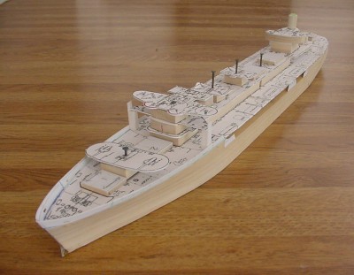

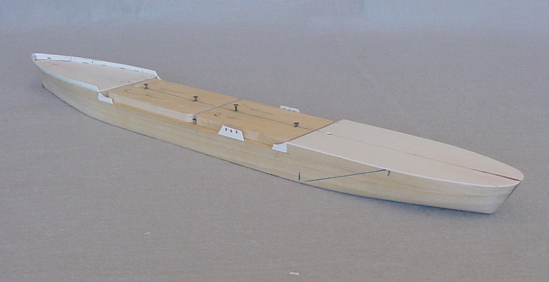

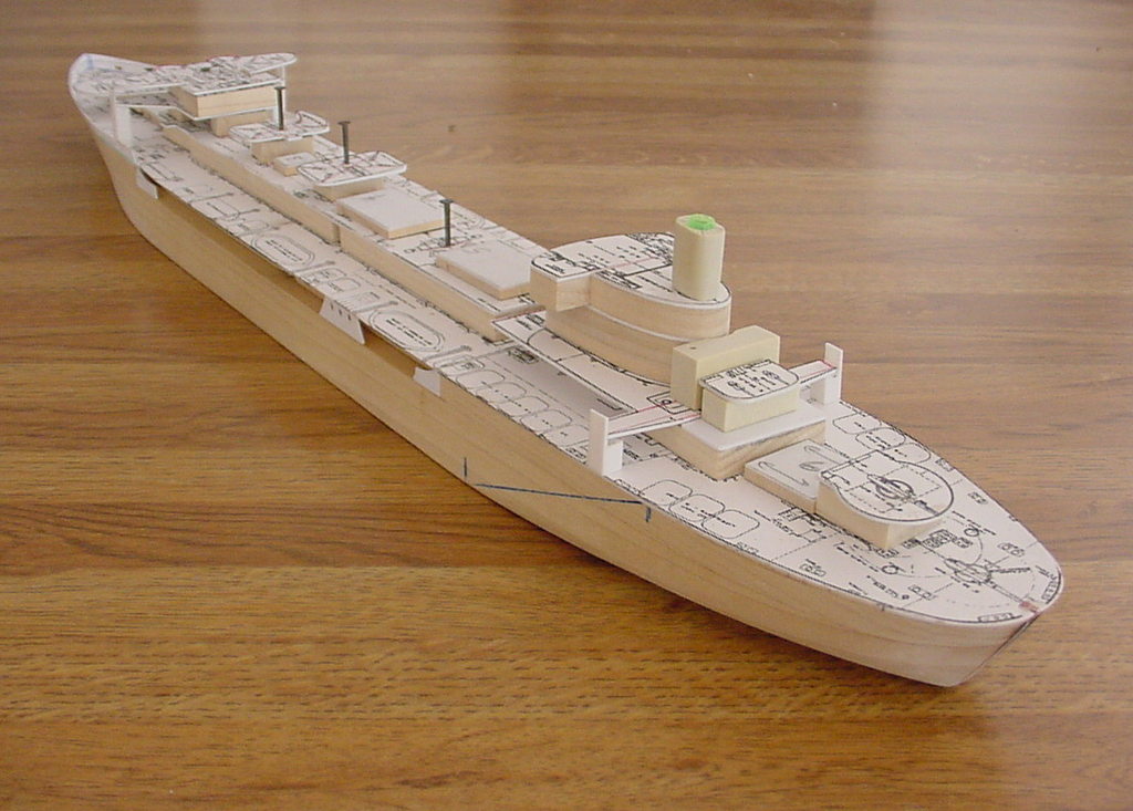

The documentary got me interested in the Richmond yards and the Gen G O Squire class of transports in particular. Richmond built 30 of this class. They were based on the very nice C-4 hull (523" loa 71.5' beam) with a superstructure that at this time I will charitably call unusual (I will save ugly until I have finished the model and have a good base for a definite opinion). One example is the use of 3 different davit designs for the 4 sets used on each side (one has to guess a committee did this).

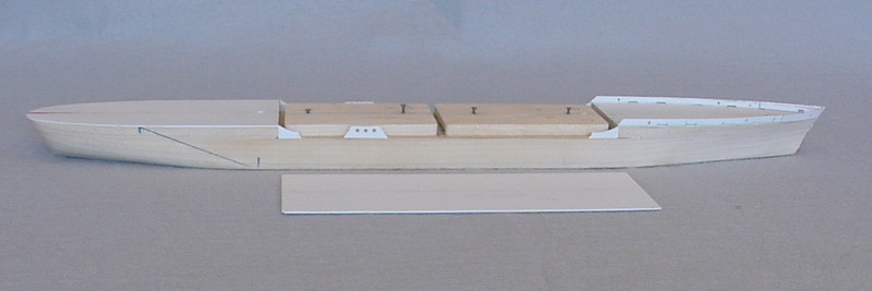

Pic 1 is the ship in 5N meas 21 (which is the scheme I will use).

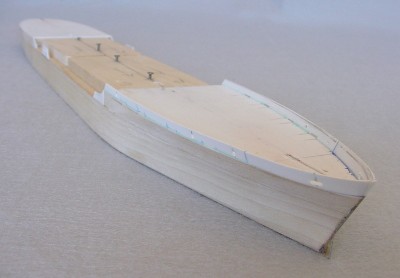

Pic 2,3&4 are the hull to date.
Pic 5 is a close-up of the prow which changes from a rather steep angle to vertical. This caused me to make the centerline insert in 2 pieces, the upper 2/3 .020" styrene as usual and the lower 1/3 .020" brass to survive the aggressive sanding that had to occur in this area.

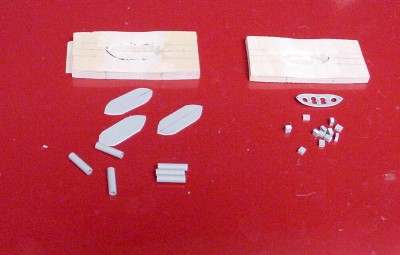

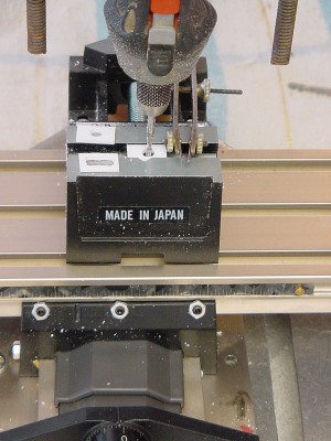

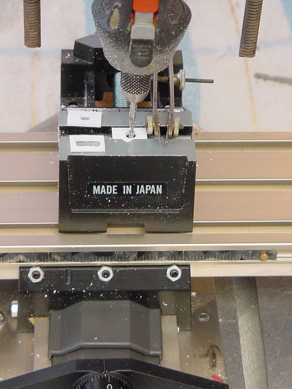

This build posed some challenges, the rafts and the lifeboats. The rafts are LARGE (.30" x .50" in 1/350) and the lifeboats are also larger than I could find commercially.
Pic 1,2&3 show how a homemade vertical mill made the blanks, only the top of 3 pieces needs the center milled out.
Pic 4 shows the patterns made for the nesting lifeboats, I hope to get a result from vacuum forming, if not then try to lay up a hull with paper and glue.

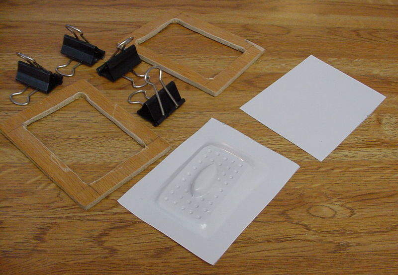

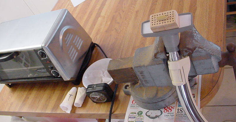

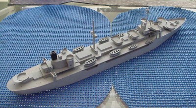

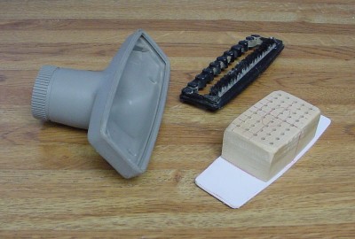

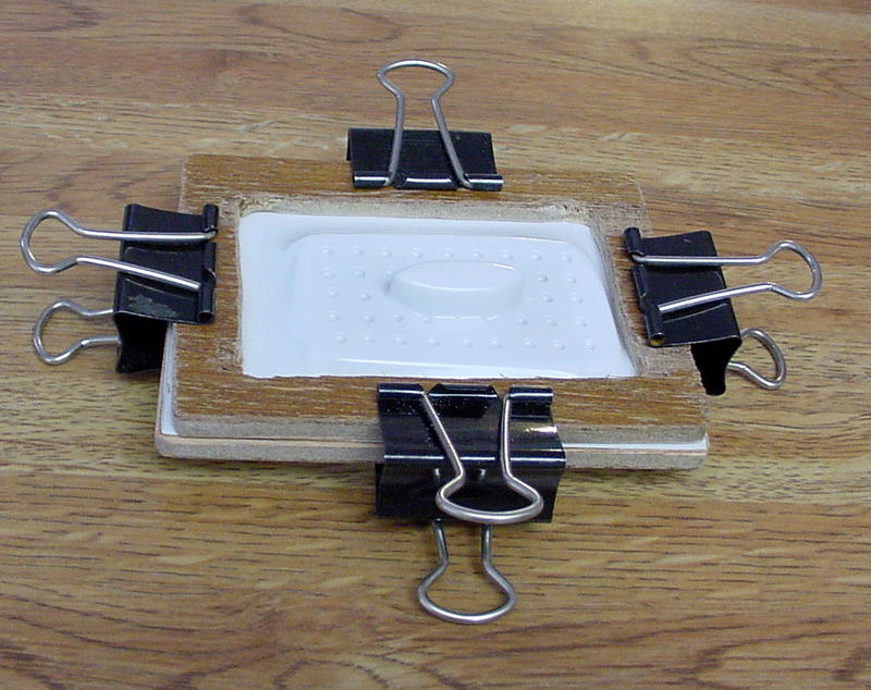

Pic 1 Surprise...Surprise...my first try at vacuum forming ended up with a usable part. Still cannot believe it, I really was expecting a grinding learning curve.
Pic 2 Modifications to an ordinary vacuum nozzle. The black brush was popped out, the new plate is .080" thick and the wood block is 2.5" x 1.5" x 1" with 45 .120" holes.
Pic 3 The production line from right to left, 400F toaster oven (.010" styrene 35 seconds - .015" styrene 50 seconds), finger protectors, clock, damp paper towels, vacuum set up in vise.
Pic 4 3" x 4" styrene blank, blank holder and clamps, the finished product.
I am fairly confident that I can make a finished lifeboat from this point.

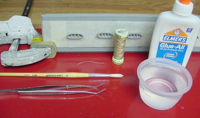

The lifeboats are roughed out and primed. They show my usual lack of perfection but hopefully will be OK from one foot. Made a few extras and left some notes, the idea to do a AP-110 class (10 pairs total) is gestating and at least I will NOT encounter the "how did I do that ??" problem.
Pic 1 Hull sheer sanding guide, "thwart deck" blanks (cheated ion the large boat - all is hidden by the small one), mounting spacers for both sizes.
Pic 2 Gunwale production.
Pic 3 Lifeboats as modeled.
Pic 4 Lifeboats as they were.

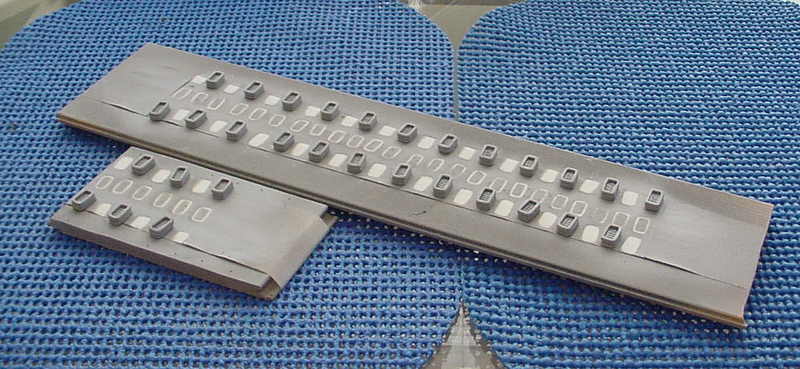

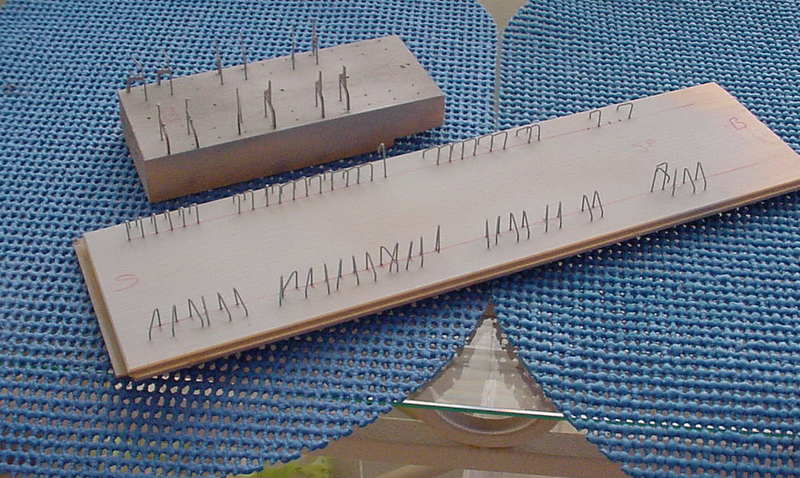

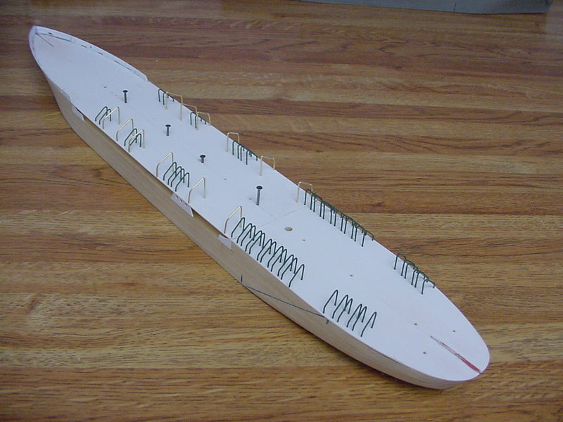

Pic 1&2 show the ship as she is now, getting close to being ready to paint.
Pic 3&4 shows wire bending and the "finished" davits and raft supports. There was a LOT of wire bending.
Pic 5 is the rafts, more sanding than I would care to repeat.

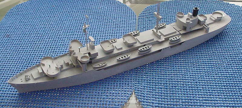

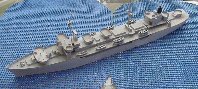

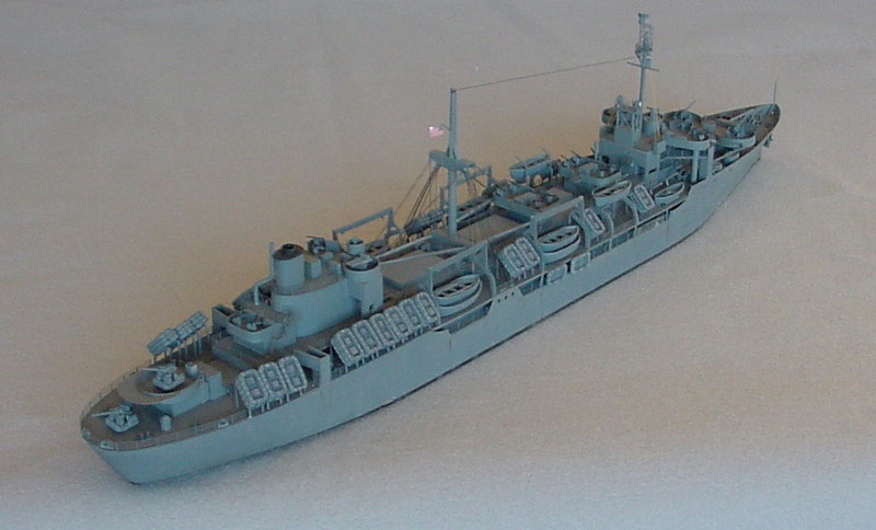

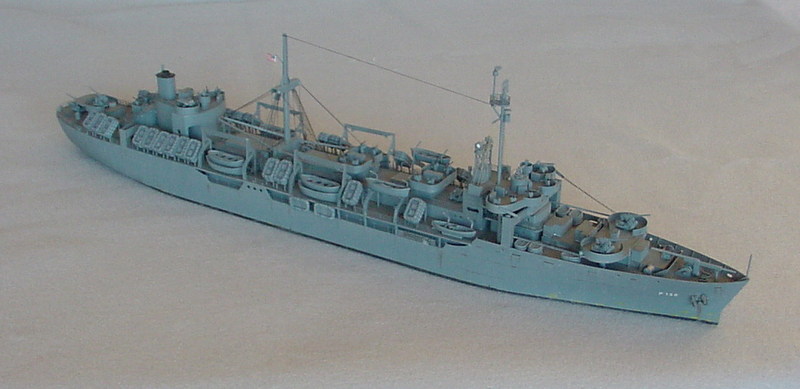

The General G. O. Squier is done.

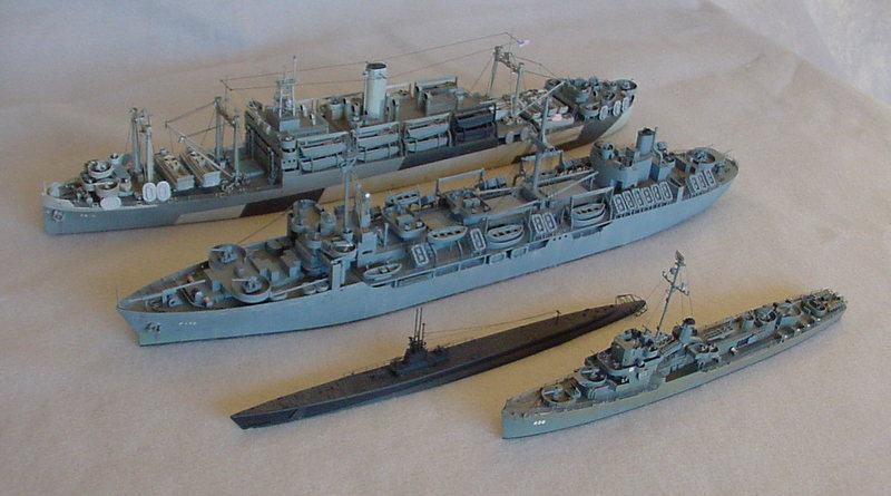

Enjoyed the build although it took longer than normal, a combination of lazy and lots of parts. My impressions are, love the hull - best of the merchant hulls, hate the forward superstructure - off balance and added on. The aft superstructure seems to be an art deco sculpture. Cannot understand why the USN wanted four 5"-38 for this class but did not provide adequate fire control, a mark 37 director. Five shrouds per side on the mainmast seemed to be a reversion to the age of sail, I checked the photos closely for ratlines.
Pic 1 The goal.
Pic 2,3&4 The model. I know it is missing all the little people, but what is left of my sanity is still intact.
Pic 5 Always looking for comparisons, but this was my first transport. Then I remembered that the Leonard Wood was built to be a transport. A DE and a Gato added for size.
