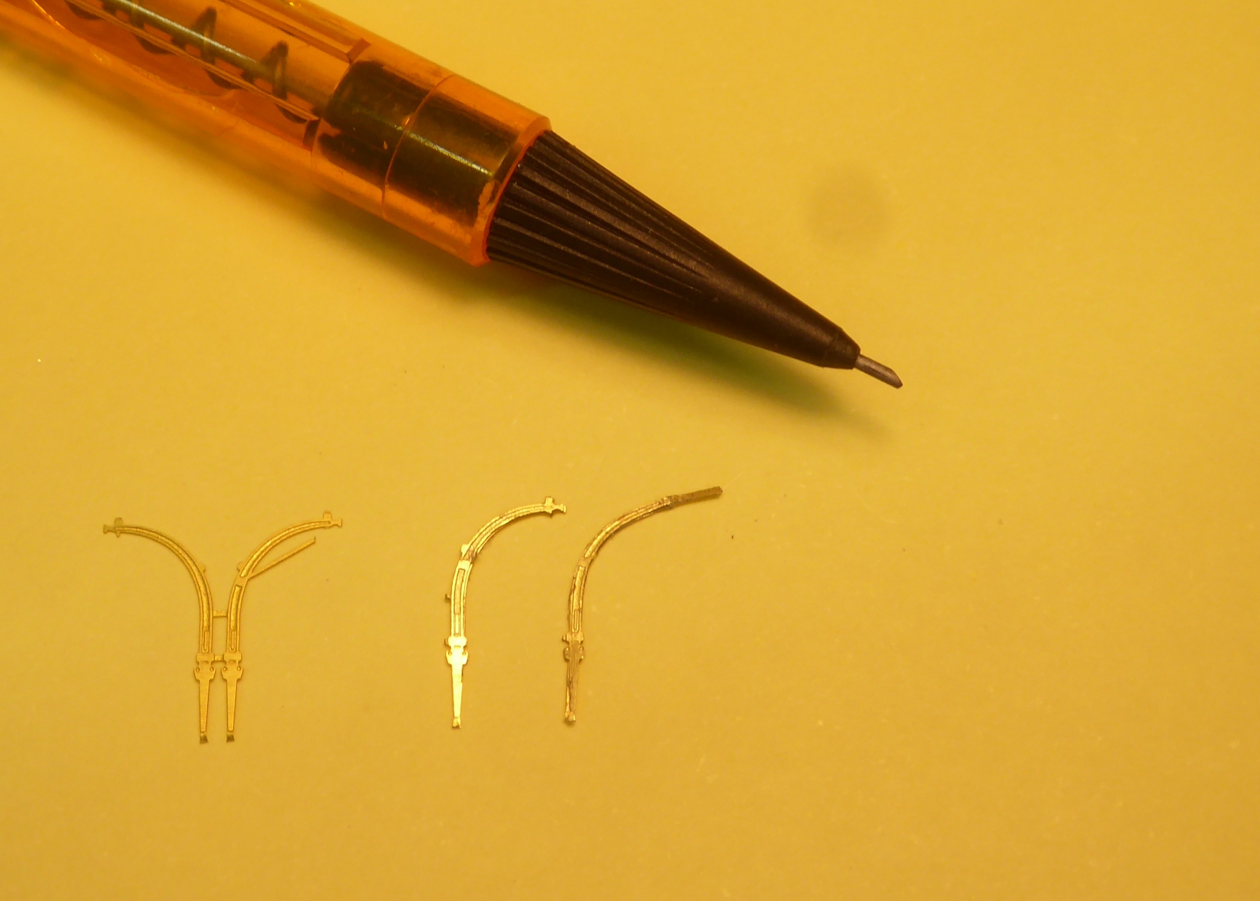

these were made by bending up Mastermodels brass yardarms to get a nice tapered davit...
all were painted in a blob blu-tack

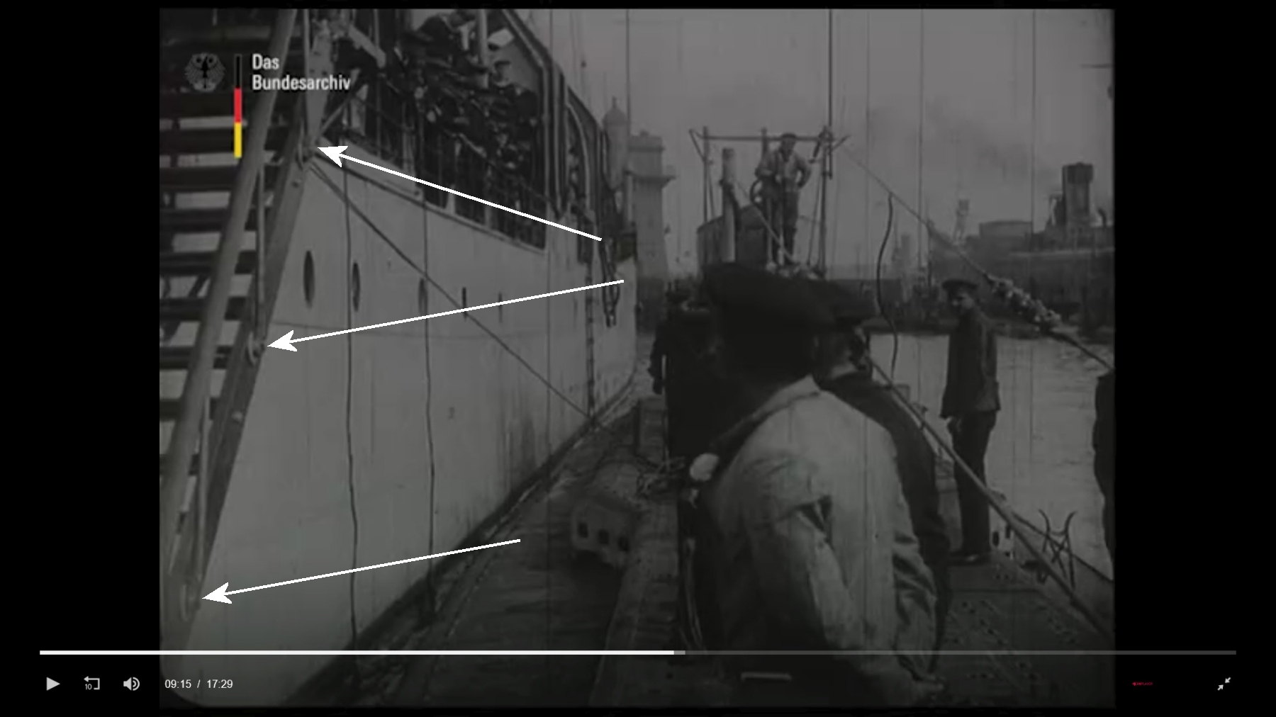

whereas the same position set of davits on starboard were distinctly different--being the square girder type
Enhances zoomed in screenshot video still from on-line Bundesarchived WW1 film
These were made up from the ( original kit ) PE -- but extended
The other davits were broadly of similar type--again using various sizes of brass yard-arms

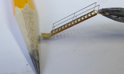

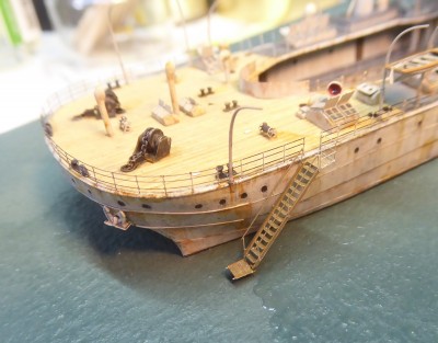

The aft accommodation ladder... I used the treads and grating platforms from a WEM Koenig PE set-- ( its WW1 German anyway !)
but the ( commendably fine!) handrails I was unable to use-- as the ladders on Vulkan had only a single rail
and the articulated stanchions on the outboard sides ( img )
I made new hand railings of nickelsilver wire to try and get close to the real thing
a hinged platform and a stowed accommodation ladder was espied in photos--made and added.

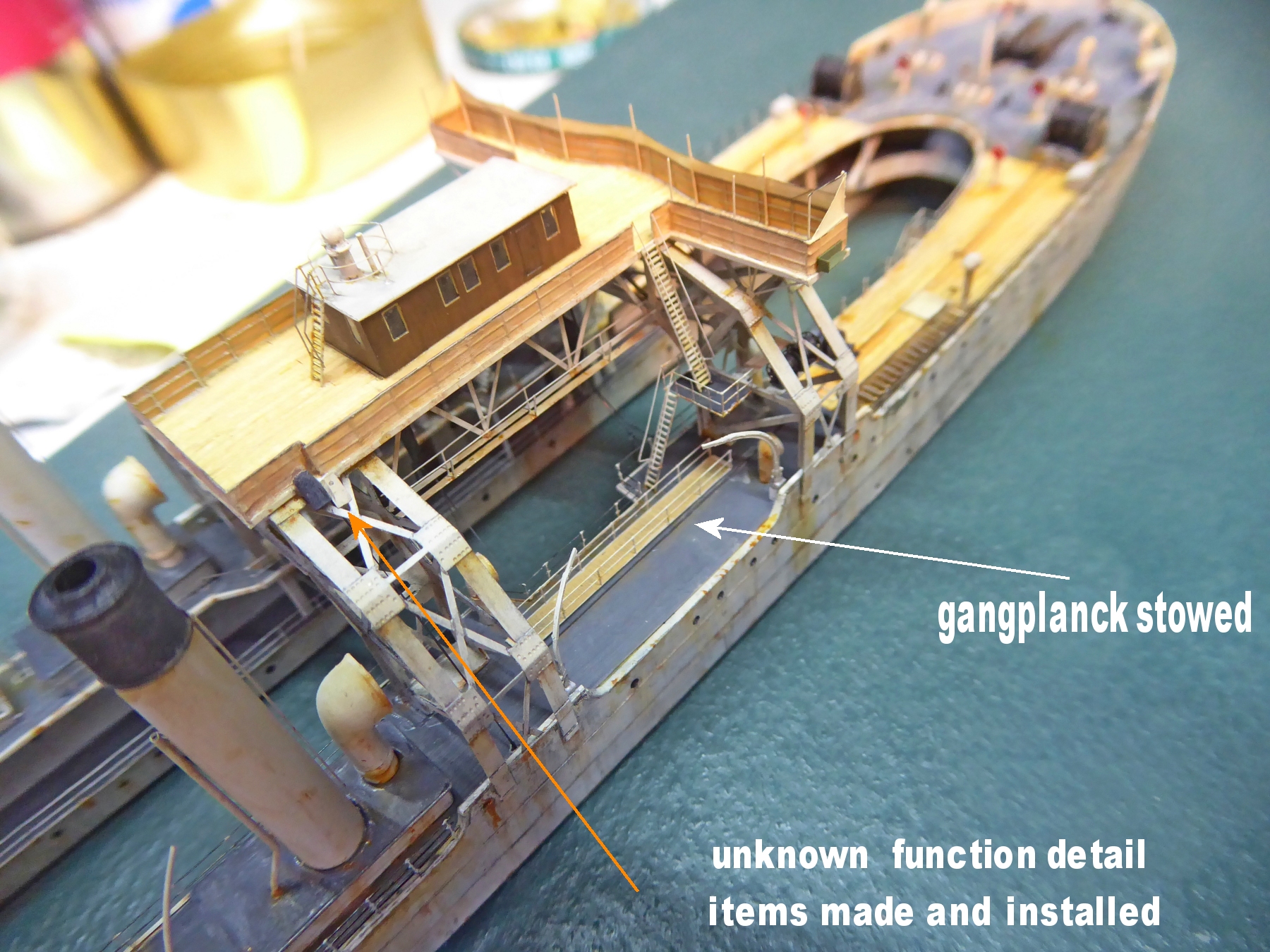

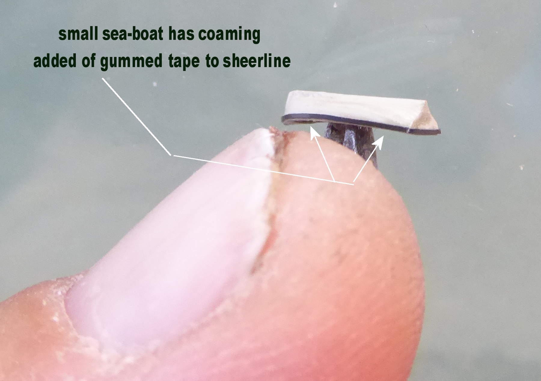

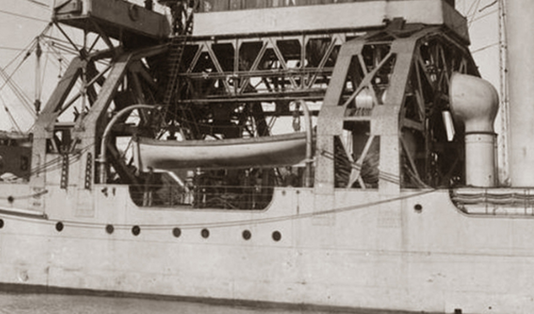

The small sea boat which will be slung on the stb davits needed a wooden coaming panel adding
I used black gummed paper cut into thin strips, this was later painted a dull brown
The large pulling boat on the port-side was seen in images often to be suspended from the davits above the cradles
so is mine now-- ( though I still need to finish the rigging and paint the falls)

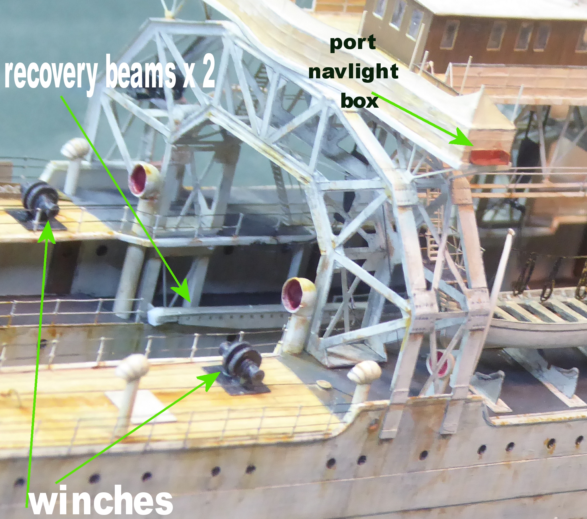

The navlight boxes were made of paper and brass and added after painting--they are still to receive their lanterns
2 x winches were made ( these operate the huge long fwd booms- not yet fitted)
There was a gangplank suspended midships across the void between two hulls
==> giving a short-cut rather than going 'around the ends...'
I made this item using some Torpedo net shelving ( sort of planked look )
and rails added to the sides
I reasoned that if the vessel was going to the open sea ( albeit the last trip !)
--then it was likely that the gangplank
would have been lowered to the deck and stowed... - it is now!

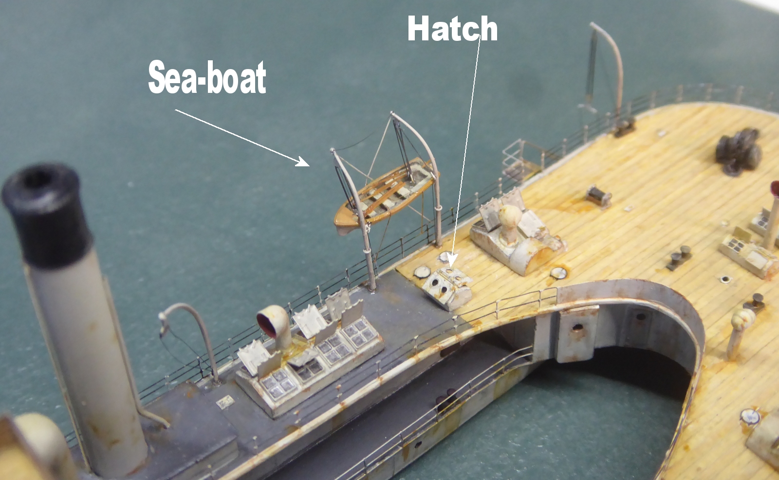

the ' extra' hatch has been cleaned up and installed

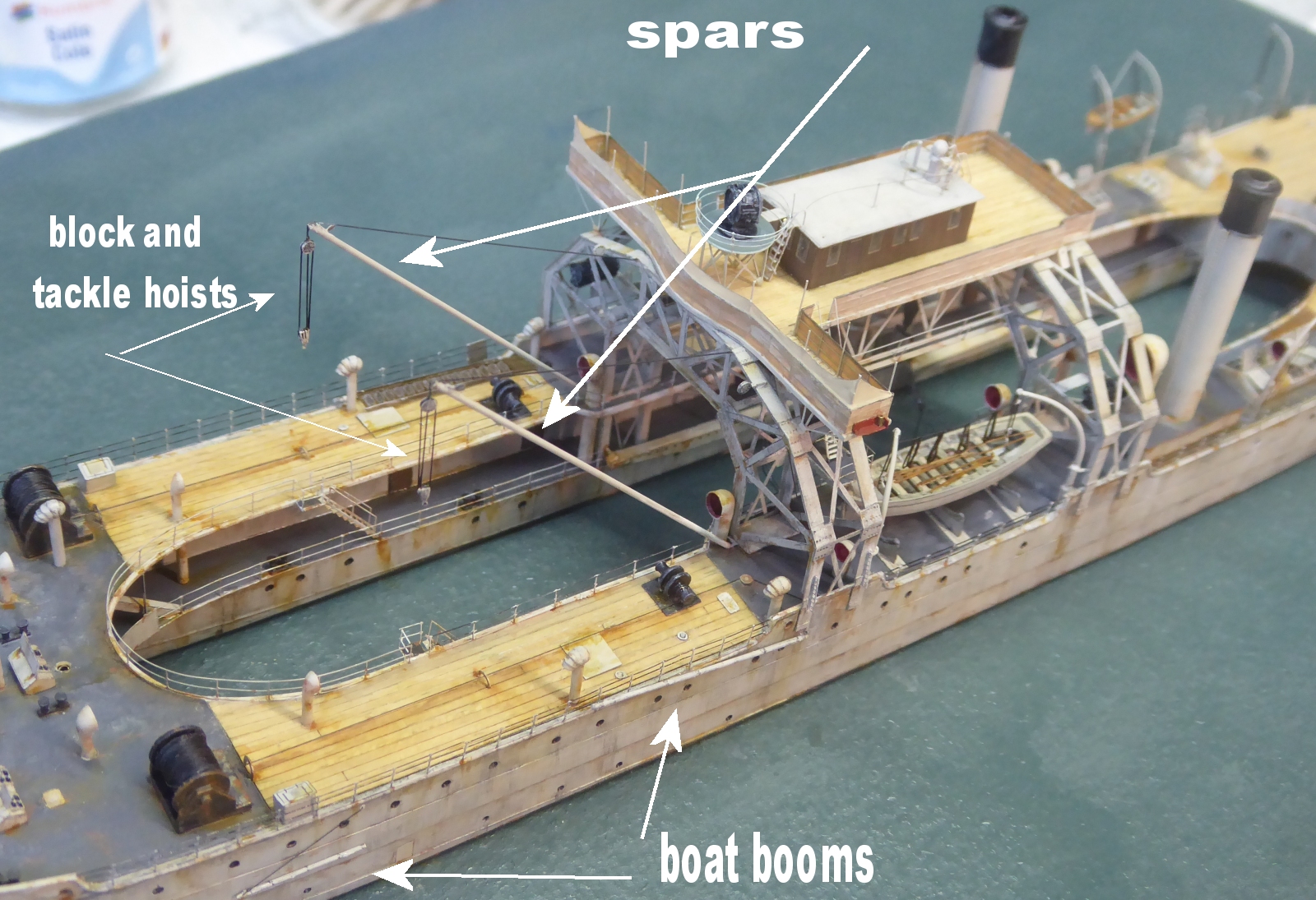

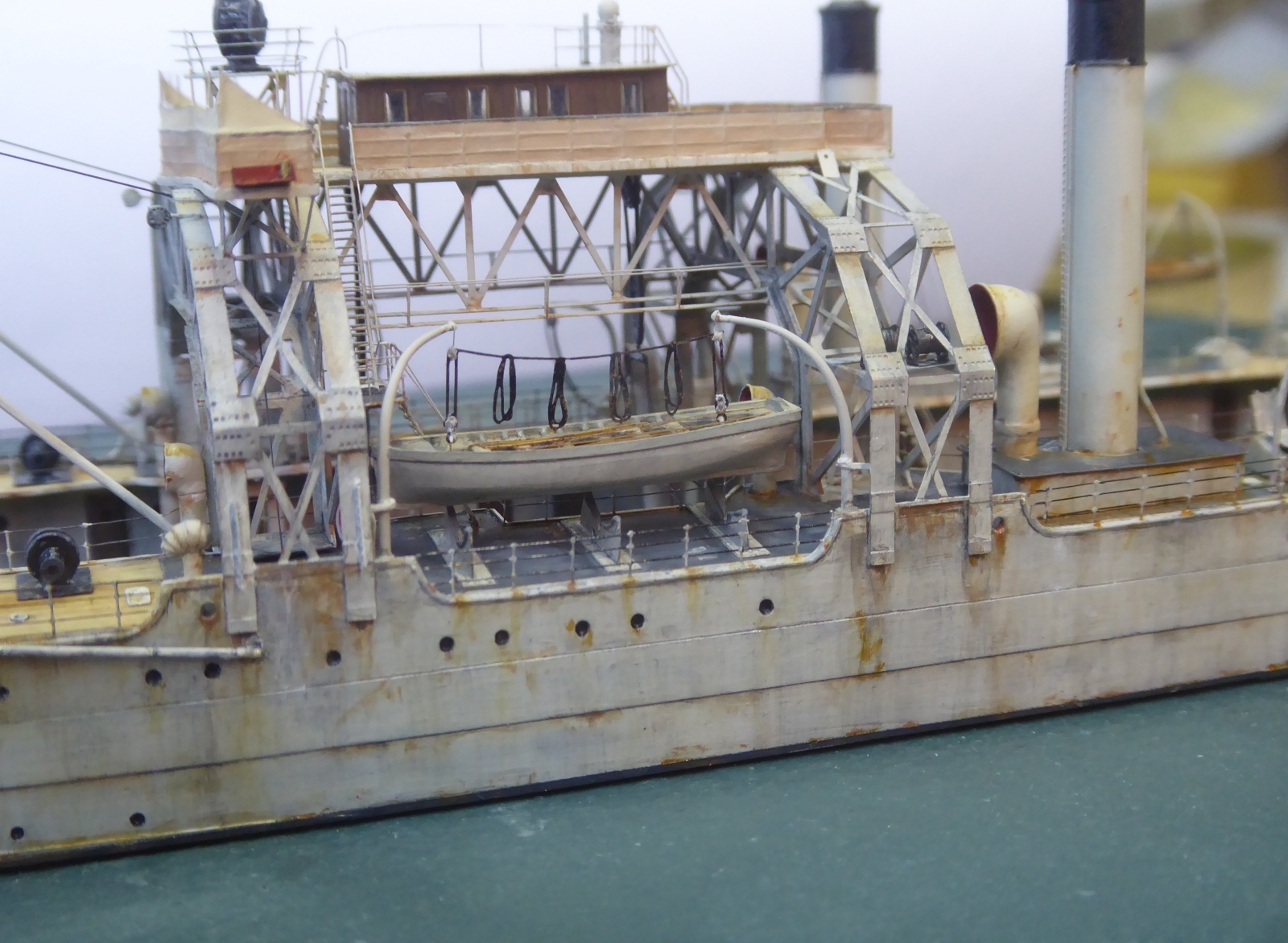

The small seaboat that last time seen was having its coaming installed of gummed tape,
is now suspended from davits and strapped in readiness for its onward journey...
quite a number of the davits have been rigged,
spars and booms made and installed
the spars have a fixed cable to keep elevation
and running rigging for raising the spar and block and tackle hoists

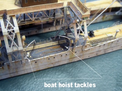

Almost all of the boats were landed at an earlier time
aside from the large pulling boat port-side and the sea boat stb aft
All the other boat positions and davits were left unused and

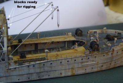

the heavy tackles hooked at the base of the davit mountings
The pulling boat rigging has been been painted and the boat adjusted

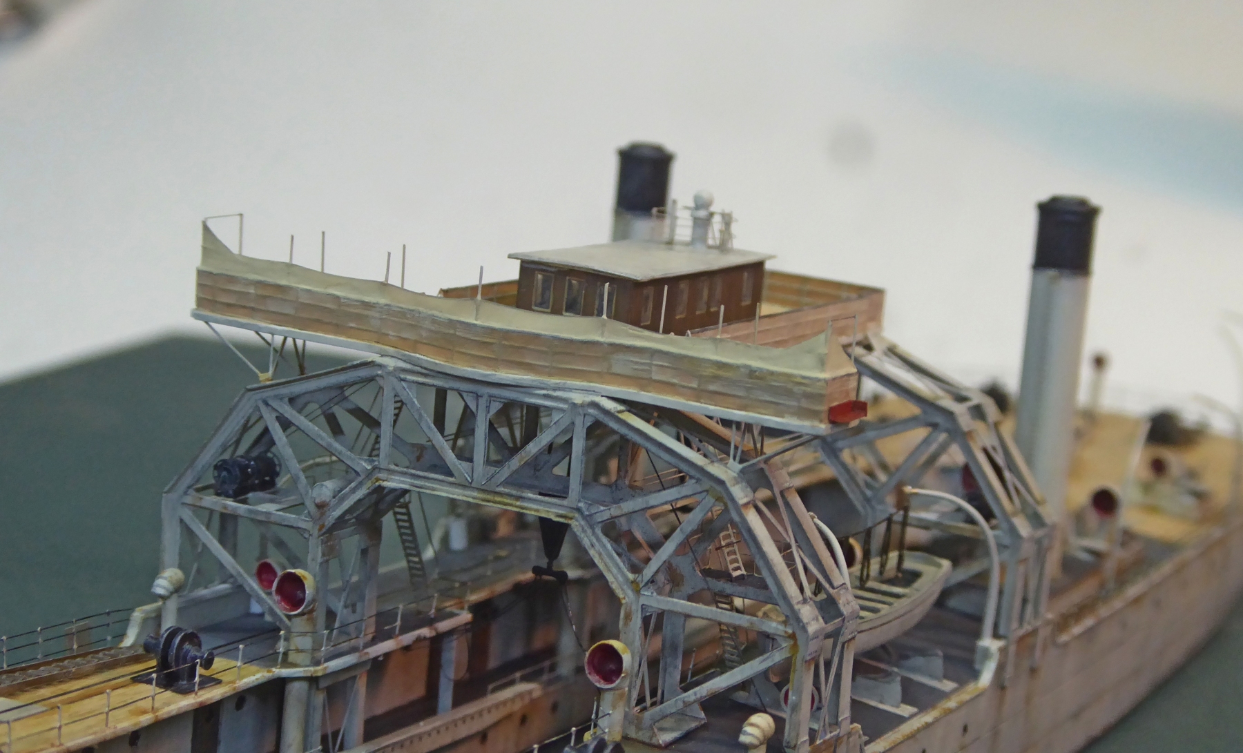

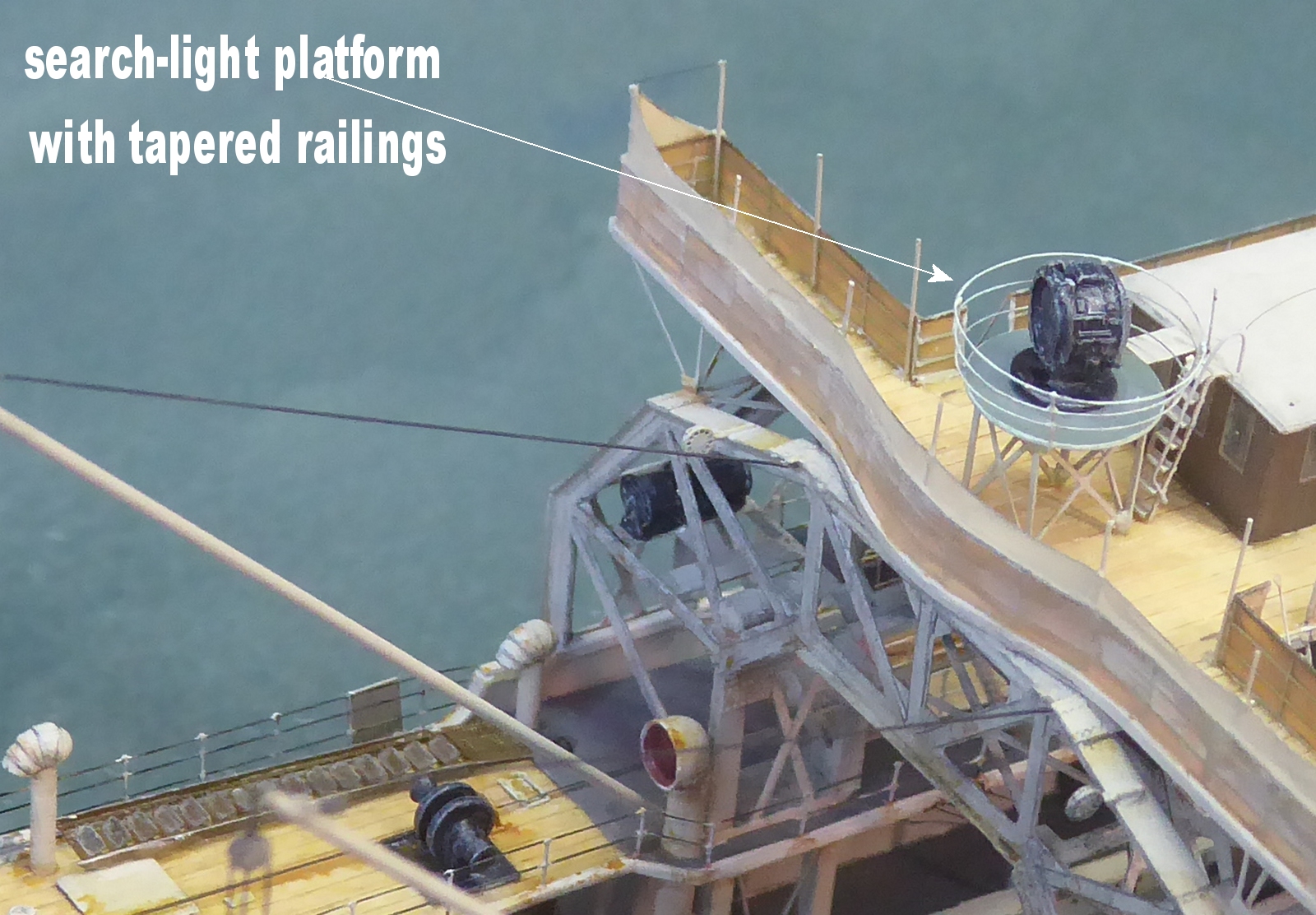

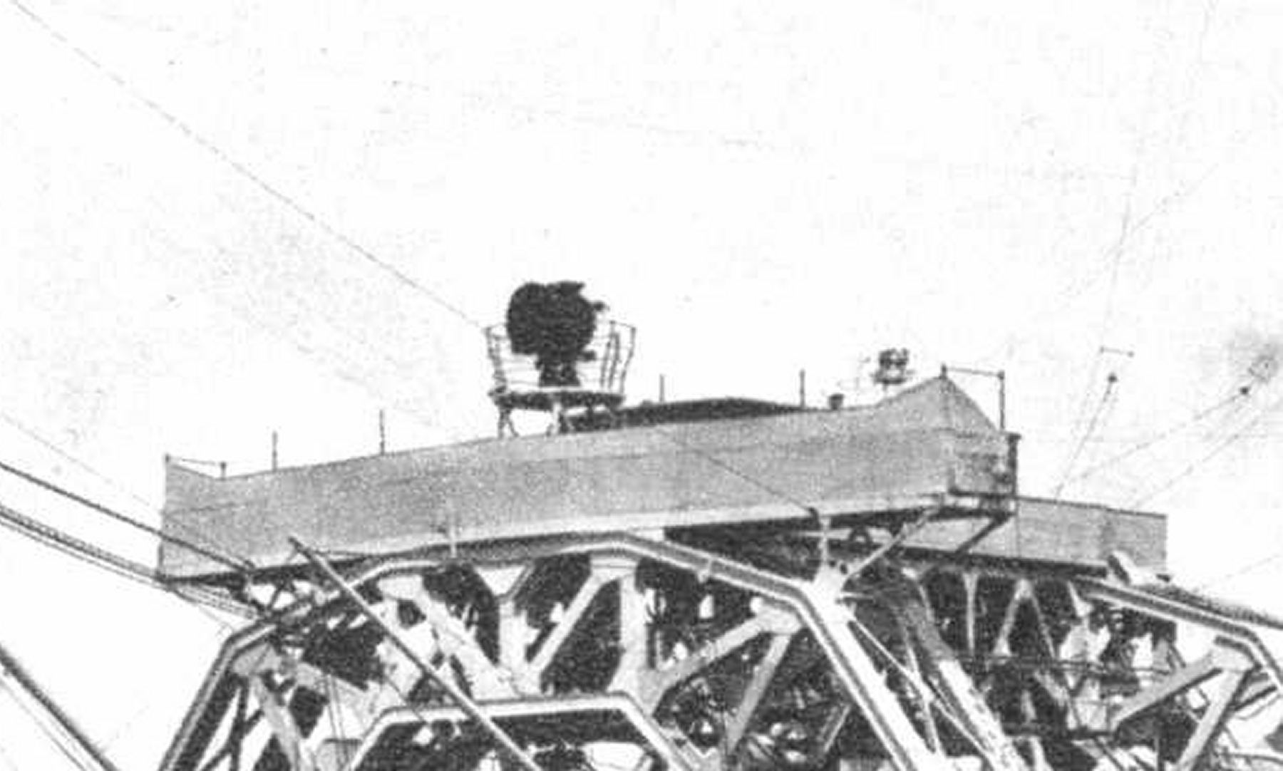

The searchlight platform on its spindly legs and the tricky tapered railing has been installed

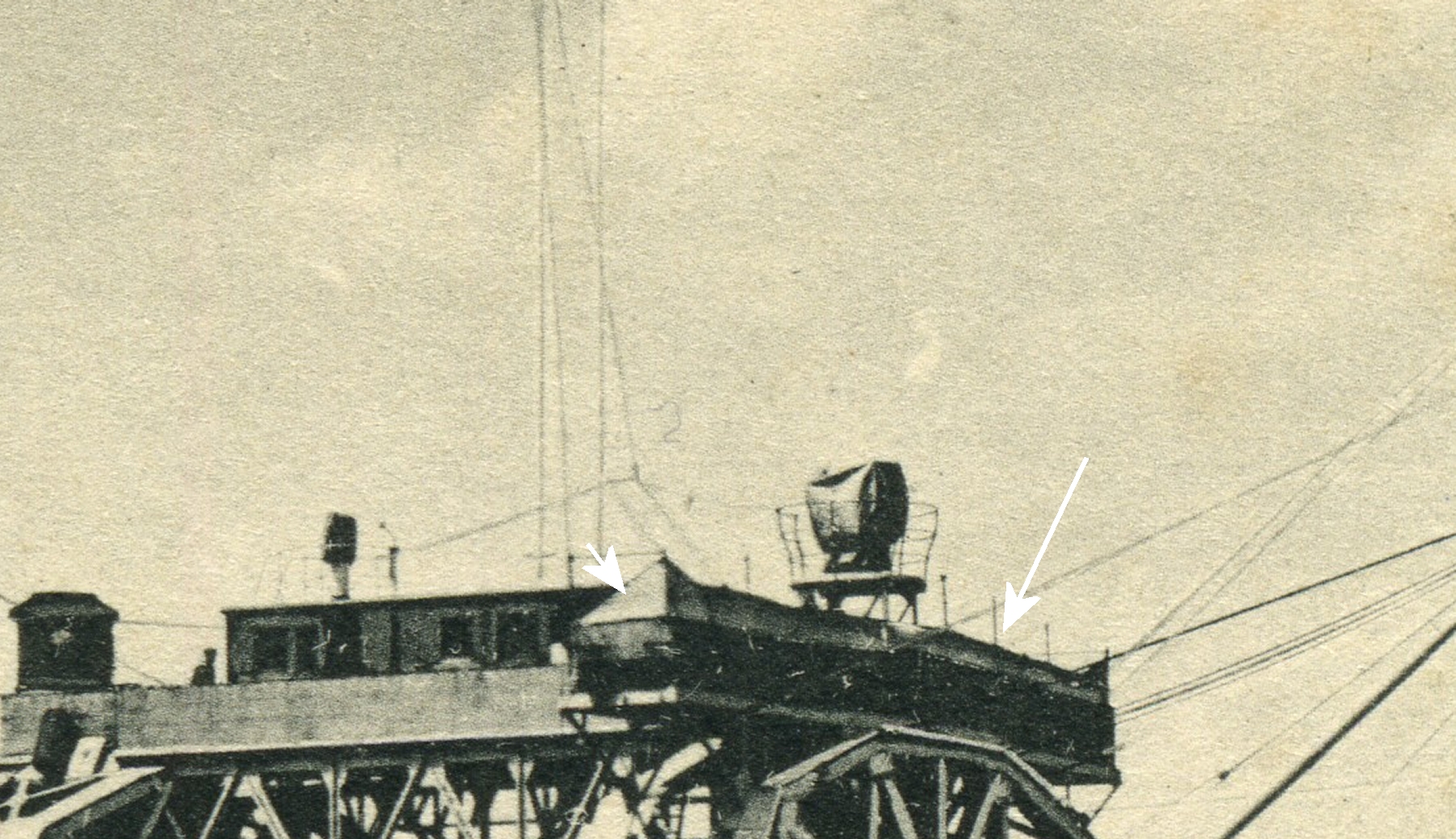

some items , tapered -- the function of which I have not been able to identify, have been made and installed x 4
any ideas?

The aging and the details are remarkable, you would think you were there. But without neglecting the artistic side of the thing. :cool_1:
