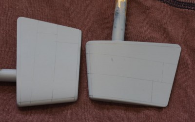

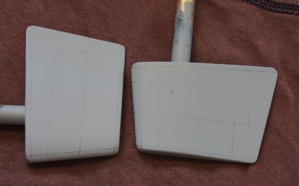

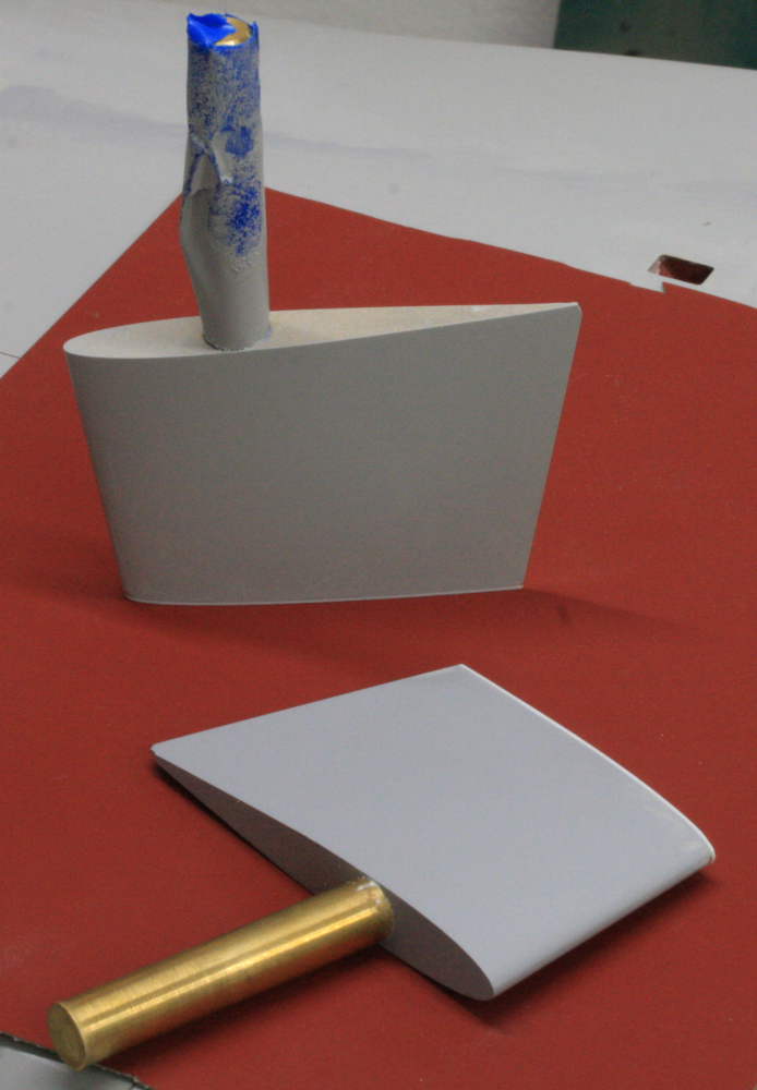

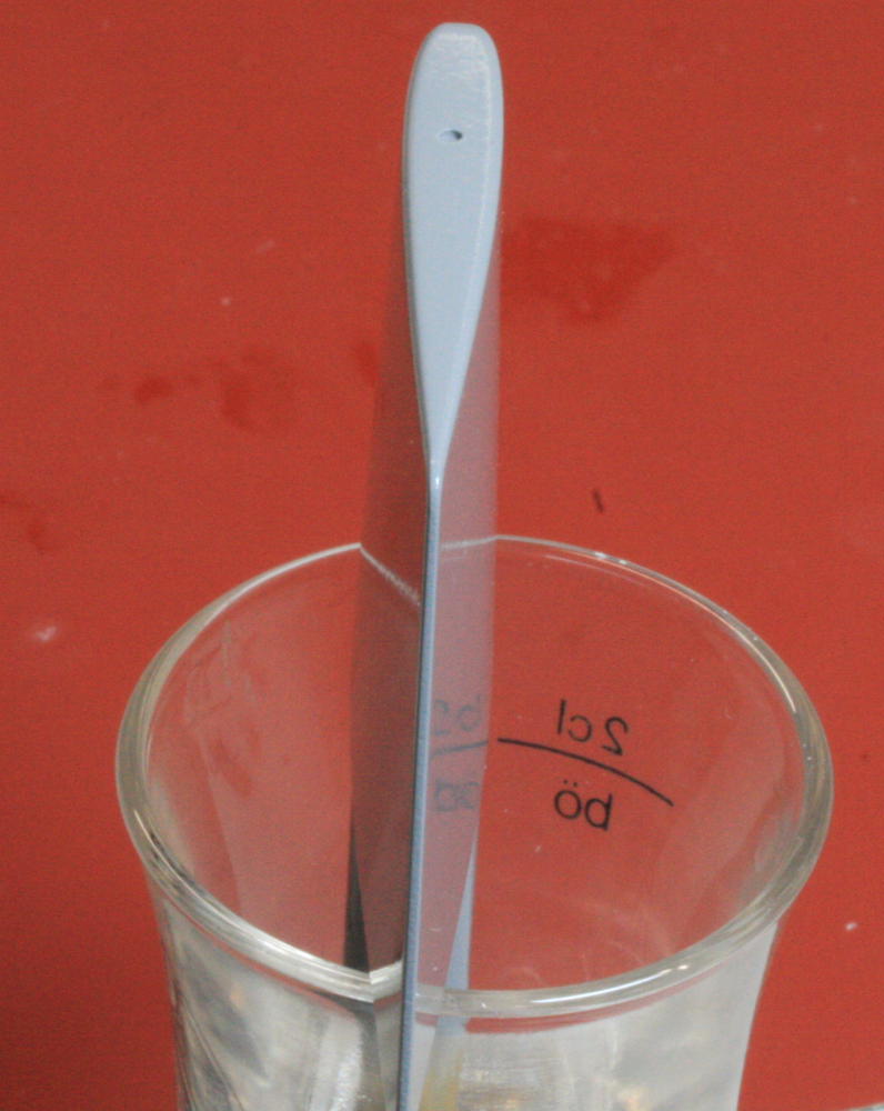

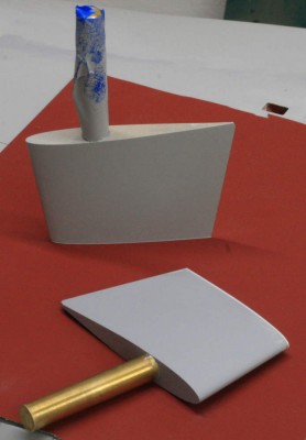

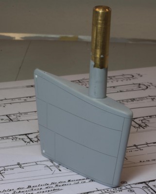

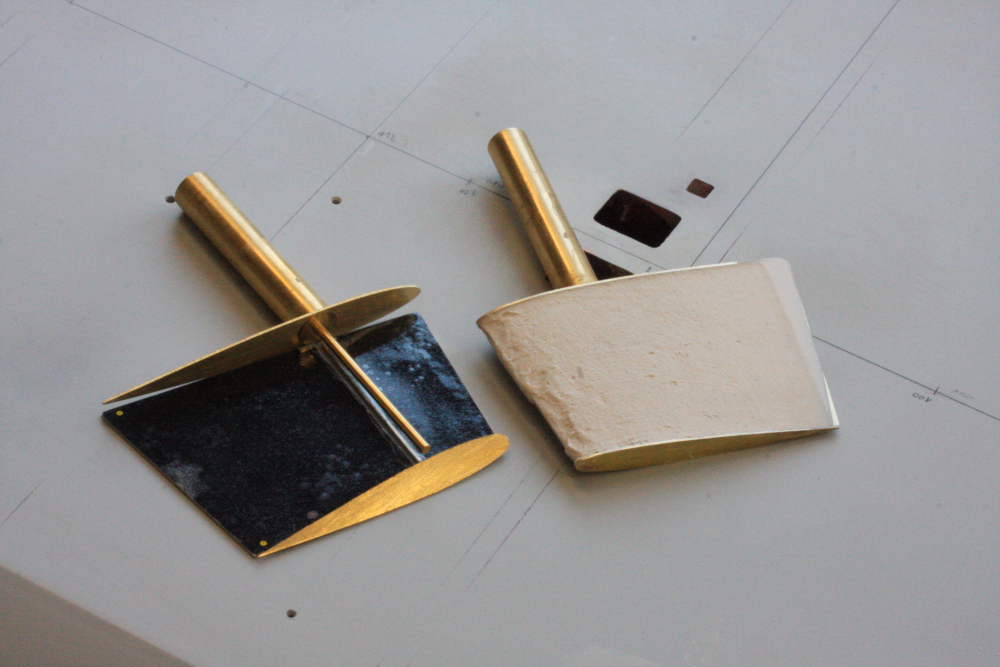

Dave Wooley wrote:Superb workmanship .Question how will you be shaping the rudder profile?
Hi Dave,
here two pictures of the rudders ...
Bye!
Richard J OMalley
Posts: 1012
Re: Reconstruction of hull, Battleship BISMARCK, 1/100 scale
Post by Richard J OMalley »
Hi 109
Excellent how to on the rudders .They look great . :woo_hoo: Hope you are done making holes in a perfectly good hull . :lol_pound:

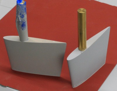

Hi,

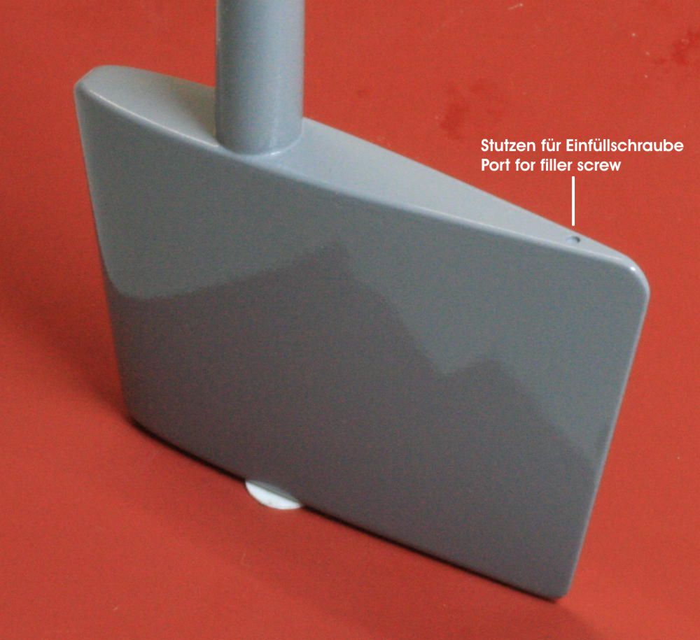

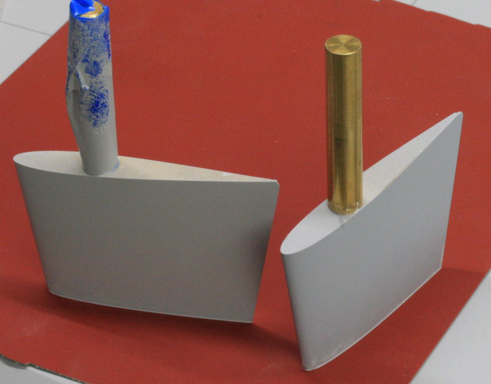

I worked on the rudders so I can now add the lower und upper endcaps of the rudders. I will do them with a sandwhich of 2 * 0.5mm styrene sheets.
109
Posts: 627
Post by 109 »
Hi,
I almost finished the first rudder body ... fine sanding and details are still left to do ...
Bye,
Bernd.

very fine work my friend Bernd :cool_2:

bernd, that is a very impresive rudder.your attencion to detail is amazing your hull will be one of the best i've seen :thumbs_up_1:

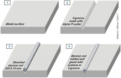

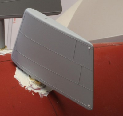

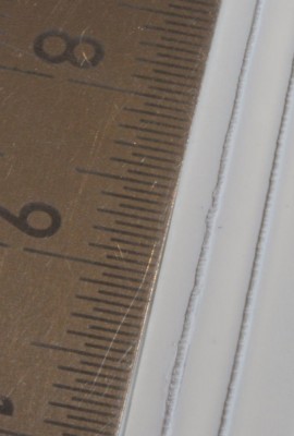

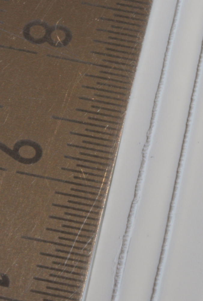

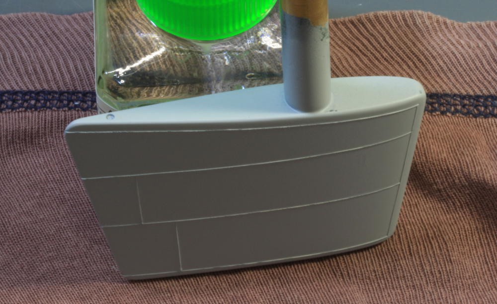

I need your assessment, please ... I made some weld seams as seen in the attached photos. What do you think about them, please?
Talk to you soon,
Bernd.

PERFECT
i have made some of these in some parts of superestructure but more simple than this.
i think this you doing is for the hull :wave_1:
yes?

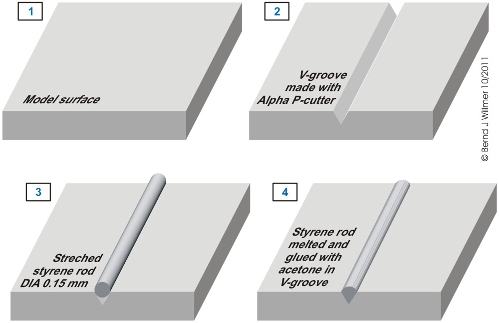

109
Posts: 627
Post by 109 »
Hi Noberto,
I made a how-to-sketch.
Bye!

109 wrote:Hi Noberto,
Bye!
Bernd perfect thank you
i have used styrene in the plates of superestructure too.
i have used Tamiya tool for it i think the equivalent the tool you describe.
when i take one pic i show.
your process is very good
i likt it :thumbs_up_1: :wave_1:

Welds look great .Thanks for the how to . :thumbs_up_1: :thumbs_up_1: :thumbs_up_1:
109
Posts: 627
Post by 109 »

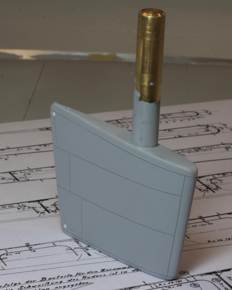

Hi,

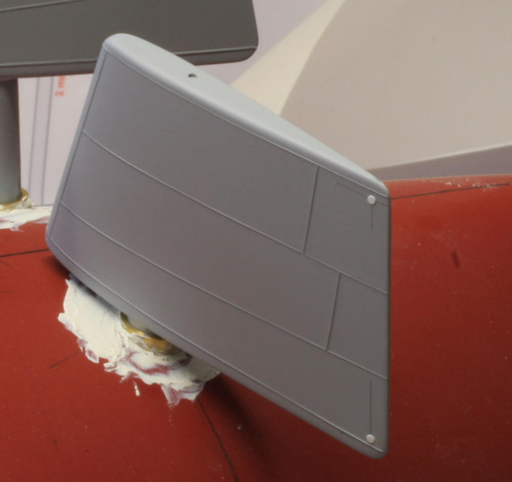

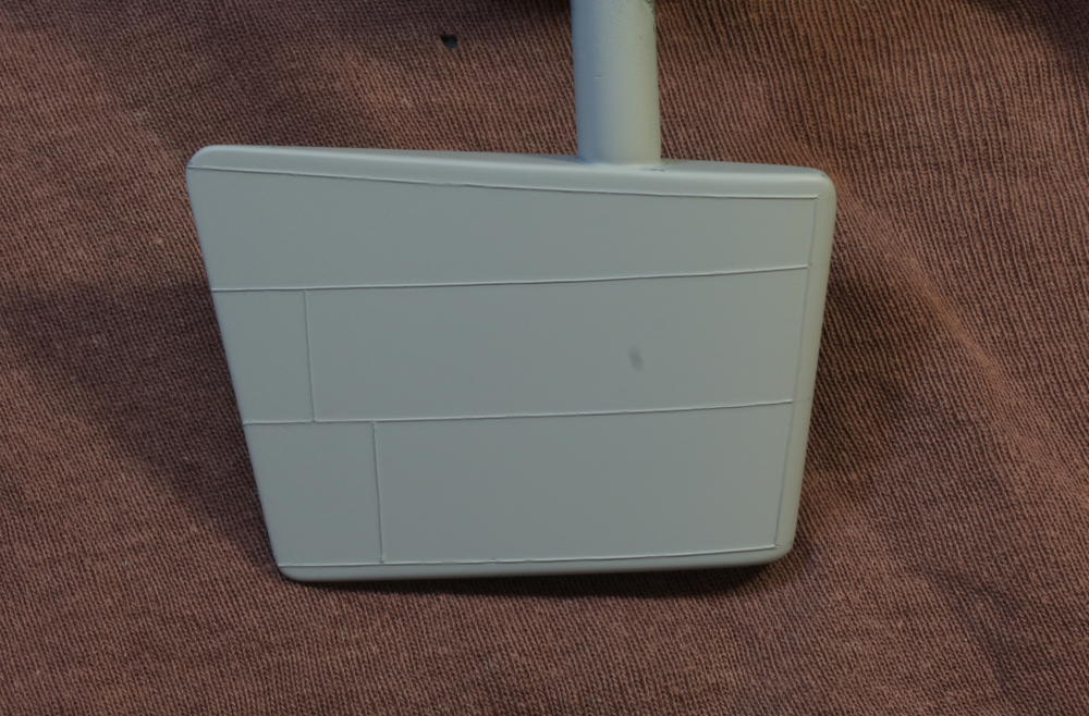

I made one side of a rudder. I will sand the welds tomorrow with a 1000 grid paper to make them less prominent ... what is your impression, please?
Bye,
Bernd.
Capit�o Norbert
Posts: 1993
Location: Brasil
Post by Capit�o Norbert »
These rudders are very very good
the weld detail brings a touch of life in the rudder.
very good as always :wave_1: :thumbs_up_1:

Bernd,
I like your weld bead technique very much - except for one thing. It is going to add a lot of work to my model if I try to replicate all of the welds!
With very small diameter styrene rod adding an excess of solvent when gluing should cause the thin rod to melt and flow into the groove to make a slightly irregular and convincing weld bead.
I like this better than the decal weld beads for two reasons. Scribing the groove can be done with good precision to get the welds in the exact location. Second, you don't have the "decal edge" caused by the thin decal film. Even after using decal softeners and such the edge may still be visible. This is what has prevented me from using the rivet and weld seam decals.

Bernd I must admit it is very rare to see such level of detail added to the rudder although such lines are almost invisible on most rudders ! Question I recall Phil Ardell fitting sacrificial anodes to his Bismarck rudders? Once again you have lifted the bar to a higher level, now its back to the work shop to think again. :thumbs_up_1: :thumbs_up_1: :thumbs_up_1:
109
Posts: 627
Post by 109 »
Hi,
thanks for your input. :thumbs_up_1: Indeed it�s a lot of work ... :heh:
I checked photos of Bismarck�s rudder and hull and depending on light conditions weldseams are clearly visible. I try to make them visible when you have "your nose on the model", but they should almost completely vanish when you step back from it. So I sanded the weldseams a little down. I hope to airbrush the rudders around tuesday or wednesday. Then we will have a homogenous surface to judge their appearance.

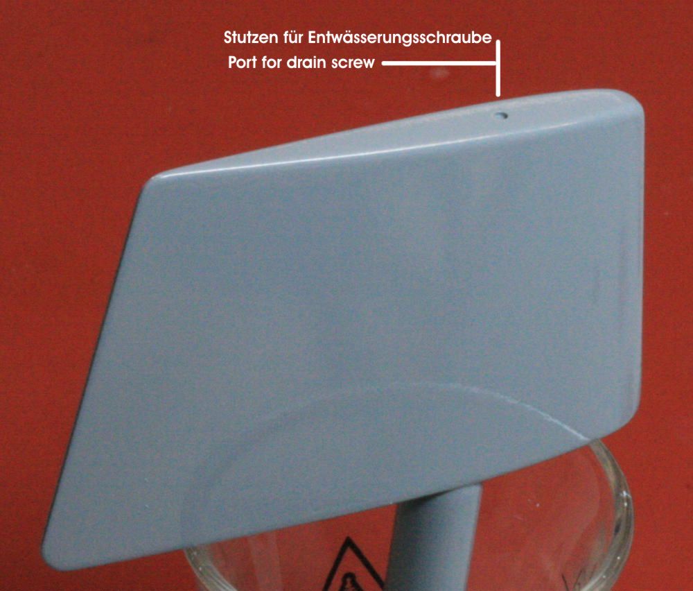

I will add the anodes later - I will do them as PE parts.
Bye now,
Bernd.

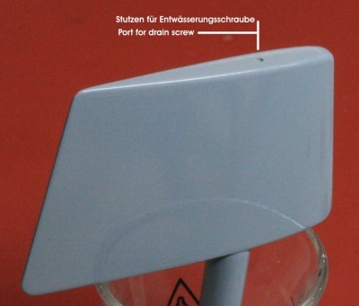

Capit�o Norbert
Posts: 1993
Location: Brasil

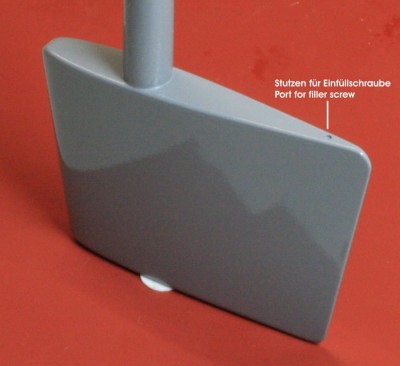

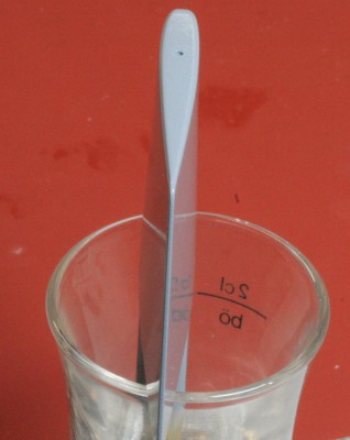

white balls in the rudders is drain locations?
