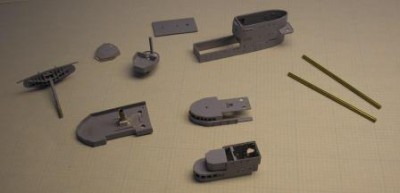

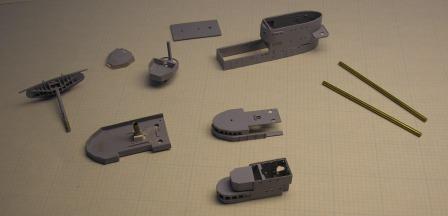

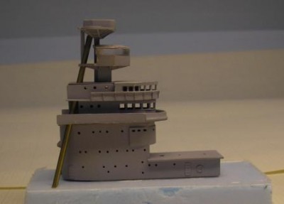

Here are some pictures of my version of the Flag Bridge. I note that Chris Smithers drew essentially the same conclusions as I did as to the shape of the Flag Bridge. There are pictures of SARA with a framework in the same area which was largely pipe and canvas or some similar material. I concluded that much like the simple shapes for the 1.1" splinter shields in the areas where the 8" turrets were removed, the same approach was used on the Flag Bridge for wartime expediency: lots of flat plates which could be placed and welded in a minimum of time. Note that my structure is incomplete, currently lacking the corrected details such as the correct positions for the searchlight platforms. I still have some cleanup work to do as well to fix a couple of flaws, but you get the general idea.
This photo shows that I have not yet changed the splinter shield height and size, but I will do so before attaching the flight deck. As you can see, my solution to the problem of fit of the wooden deck is to laminate 1/8" basswood to the underside of the FD and allow the basswood to force the hull straight. You can see that I have done some carving on the basswood so that it conforms to the hull flare. I also took the top off the boat pockets so I could detail them properly . I glued the bottoms of the pockets in place to add some rigidity to the hull sides so I could get the flight deck to fit square and tight before proceeding. If you look closely, you will see that I chose to expand the lower hull by cutting it lengthwise for the middle half of its length, then splicing in some (white) strip plastic strip to force the bottom of the hull outwards to meet the upper hull. Doing this also shortened the lower hull length slightly which also brought it into closer agreement with the upper hull length.

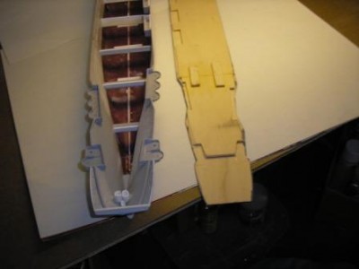

I've been fussing with the fit of the hulll right at the bow as there was still a slight overhang in a 3 inch area or so and I have been filling, sanding, filling, sanding, and stilll not quite happy with it.
Jim
