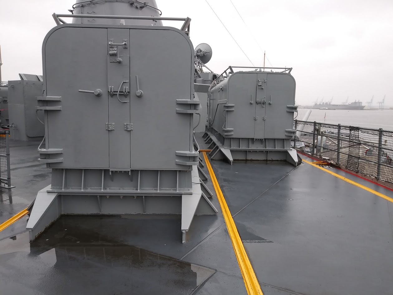

I think I have finally remedied the lack of references on the ABLs. I climbed over ABLs and filled two notebooks with measurements. There are a few caveats.
1) The feet at the ends vary in length. They are not even the same on each ABLs.
2) There are two variants. The one shown has a ladder on one side. The six aft-most ABLs on the NJ are like this. The two forward-most ABLs have rungs welded to the ABL on both sides.
3) There is 2-1/2" of blast shielding under the back ends. The ABLs are cut upwards over the shielding. Not shown here.

Thanks for posting your very fine ABL 3D rendition! As you & I have been discussing, the ABLs were not all the same and making a "master" unit that would fit all models is probably not realistic. Esp. from your own findings on NEW JERSEY. In contrast, I have included the photo I took last week on WISCONSIN of her port angled ABLS:

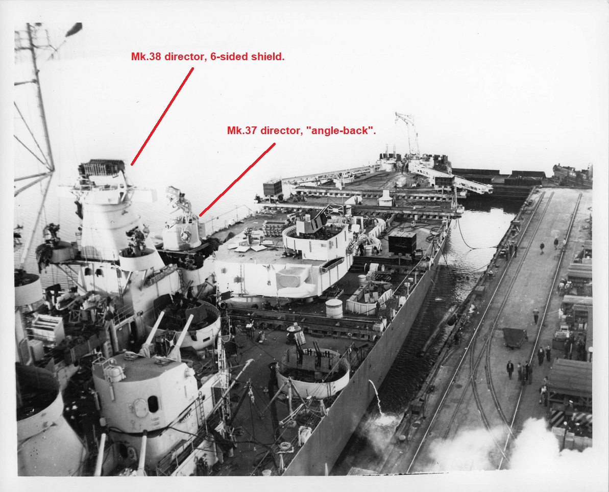

Regarding New Jersey's original fire control directors, here's New Jersey in June, 1945. At the time of this photo, she still has her original 6-sided Mk.38 directors and angle-back Mk.37 directors.
Iowa originally had the 6-sided Mk.38s and "angle-back" Mk.37s, too, as did the preceding North Carolina and South Dakota classes. Missouri and Wisconsin were built with the enlarged 7-sided Mk.38 directors and "square-back" Mk.37 directors. So, too, were the Alaskas.
Interestingly, after a deadly friendly-fire incident involving a 5" round destroying USS North Carolina's port-side, angle-back Mk.37 director, the destroyed director was removed and replaced with an enlarged "square-back". To this day, she retains three "angle-back" Mk.37 directors and one "square-back".
Mk.37 angle-back and Mk.38 director (6-sided shield) BB-62 1945.06.24 016201b small.jpg

At least the Iowa still has the 6 sided Mk 38 directors today. The Mk 37 directors have been modified so the shape of the housing is substantially different now.
