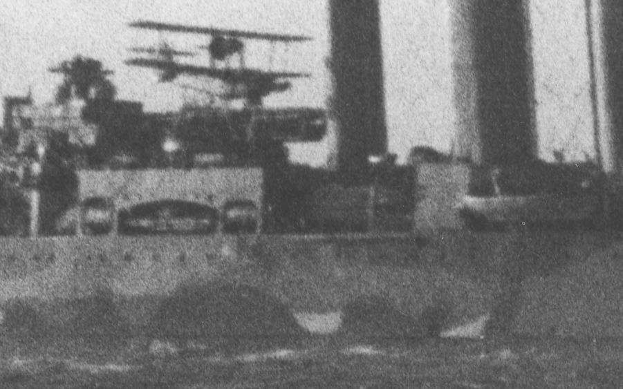

6. What variant of the Walrus was Canberra carrying at the time of her loss? Are there any after market or 3D print options available? And, in what colours would the Walrus have been painted?

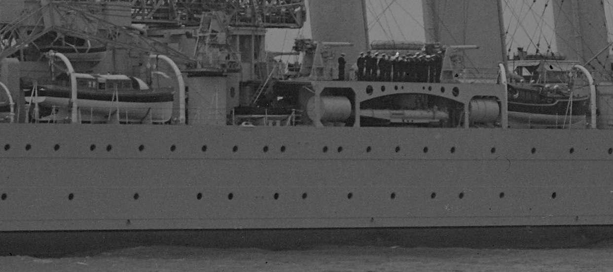

3. Check photos, Canberra�s boats were often covered with canvas while at sea. Micro Master has a wide collection of RN boats available, I am sure he will be able to help you here.

6. I don�t think you can tell the difference between Walrus I and II in 1/350. Canberra�s Walrus was painted in standard RN 3-tone camo in 1942 incl. standard roundels (red center) until her loss.

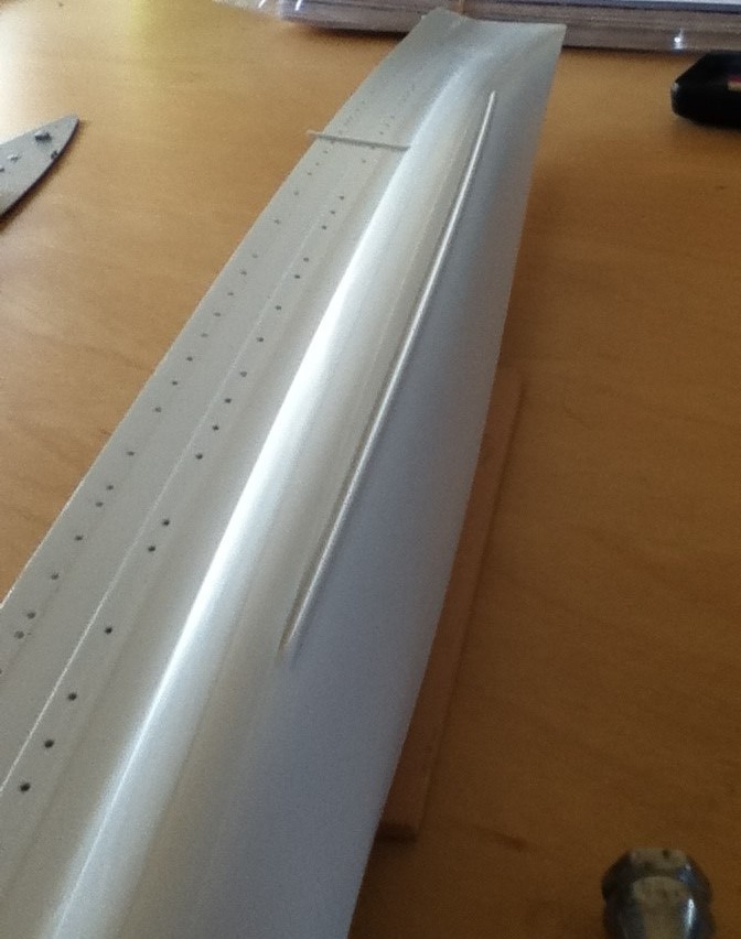

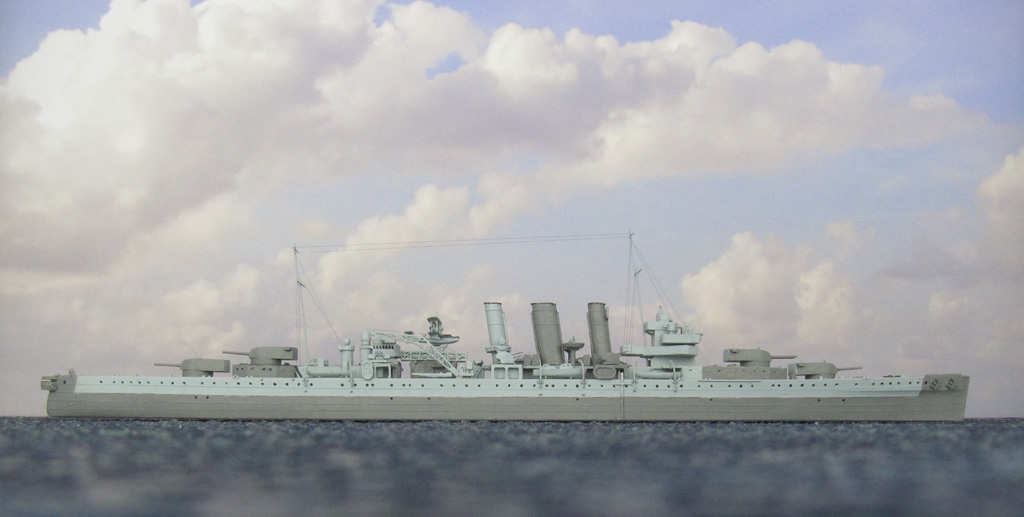

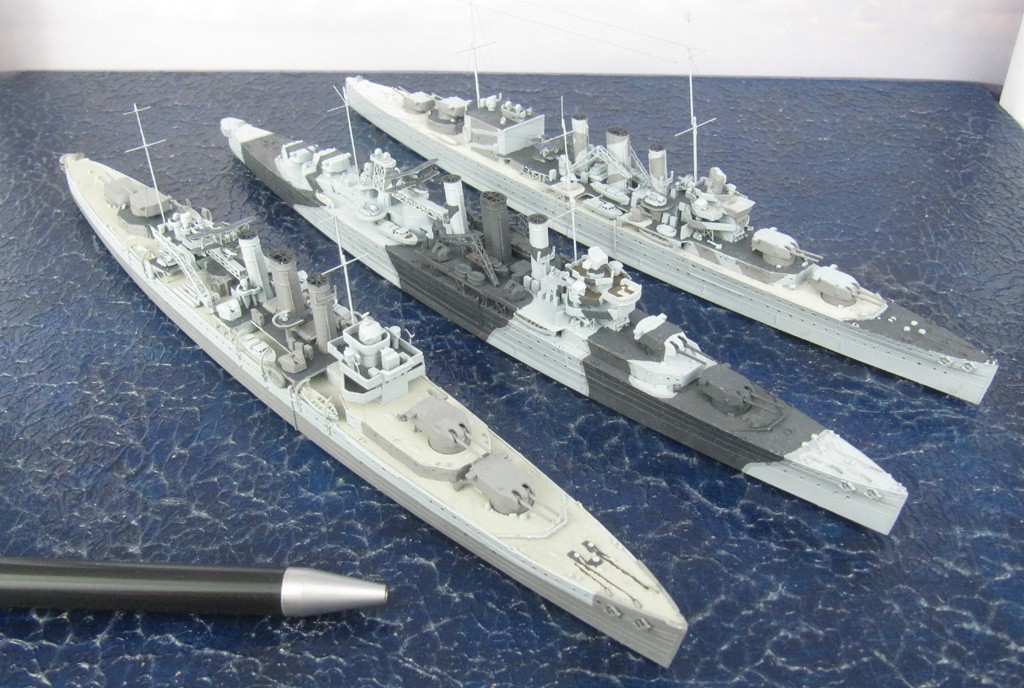

Re: 1. removing the belt, I removed the belt from my 1/350 Cornwall in order to backdate her, then drilled out all the portholes.
To do so, I taped around the belt, shaved some off with a blade attached to a shaped jig I made, that didn't work too well so I made a guide from a dremel part and then the dremel slid and reduced the bulge; then I sanded the remainder. The difficult part is matching the curve from the bulge to the slope of the hull side, but it is possible.

Looks you have done that very well, Jack G!Jack G wrote:Hi Rotley,
Re "the difficult part etc.": it may sound daunting, but it might be an idea to first separate the hull at the top level of the bulge (even 0.5mm above that), and then remove the belt from the upper part. When done, re-join the upper and lower hull parts (adding a spacer for the width of the saw blade), this will help creating a clear kink between the bulge and sloping part of the hull. Of course a minor amount of putty will be required then for cleaning up the cut.
Re "then drilled out all the portholes": did you check the locations for this with photographs, or did you simply believe the Trumpeter locations (or those from Profile Morskie) were allright? When I did my Suffolk conversion I found the discrepancies were huge, so I ended up redoing all the scuttle locations, both the lower and the upper ones.

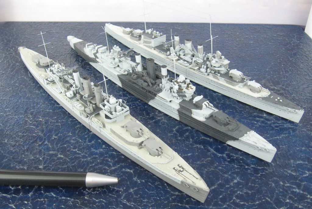

Hi Maarten - I skimped on the portholes! Exhaustion set in after the hull and "she'll be right," took over. I added a few smaller ones aft of where the torpedos will go. The model now has superstructure basics done and a custom wood deck cut out for it.
I'm going to have to repaint the lower hull as I suspect it will be grey in China Station days, so maybe look into portholes then. Any Cornwall plans from early 1930's out there?
The hull separation sounds a little daunting: I used surfboard shaping skillset to see/feel the curves and the interaction with the sheer of the hull. I guess my mind/hands are most at home doing it this way.
In other news, I found a great pic of a Hawkins class cruiser in a dry dock - that beautiful hull shape is so similar to Counties and Hood. The ships by d'Eyncourt were very graceful.

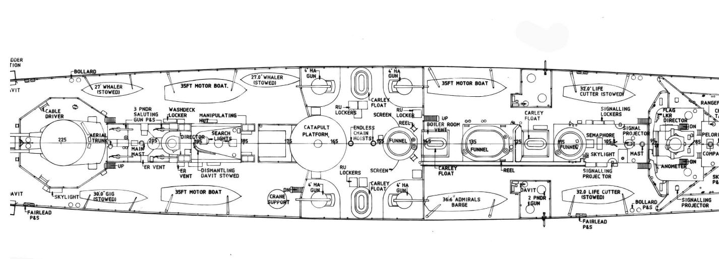

I did not include these with the instructions as this is the 1929 layout, however after looking at most pictures it seems that for Canberra this stayed pretty close for her career.
Hope this helps.
Hope this helps.

Rotley, I would suggest you check late images of Canberra to ascertain the boat positions, they changed from her early boat layout and she shipped less boats.
In 39 her boat compliment somewhat mirrored the OH GA, the strbd Admiral`s barge was landed sometime late 39/early 40, from that time she shipped no boats of that design. The 35`early design motor boat was moved forward to the midship Admiral barge location, no boat was fitted in the original position from that time onward, she also shipped one of these boats on the port side location.

Thank you. That is exactly what I was looking for. I remember seeing this drawing years ago but could not find it online.

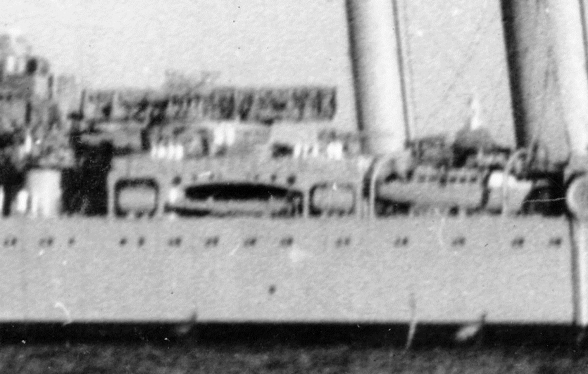

Here is a similar photo:
https://www.worldnavalships.com/ship_ph ... dID=108859
All of the photos, which I had found, are dated to be from the second half of 1941, i.e. after the June 1941 refit.
According to Raven in Warship Perspectives, the camouflage pattern was made of 507B and 507C. He earlier thought (see Man O'War about County class), it could have been Mountbatten Pink and 507C, but according to the crew members (as stated by Raven) she never used Mountbatten Pink.
According to the drawings in Warship Perspectives and British and Commonwealth Warship Camouflage of WWII Volume 3 on Cruisers, Minelayers and Armed Merchant Cruisers by Malcolm Wright, the forward two 8" turrets were painted light grey. Aoshima's instruction shows all four turrets light grey. But a photo in Cruisers in Camera by Roger Hayward shows all four turrets in the darker colour, only the rear of three of three of the turrets in the lighter colour.

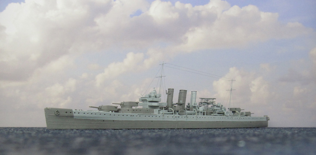

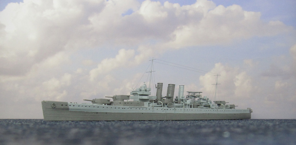

Here my interpretation of HMS Dorsetshire as in May 1941 (80 years sinking of Bismarck):
I used the Aoshima kit (052693), photo-etched parts by Tom's Modelworks and Aoshima, gun barrels by NNT and Master, light AA guns by FineMolds, and the Walrus by Flyhawk.
More about the real ship and the model (in German):
Heavy cruiser HMS Dorsetshire
with HMS Kent and HMS Berwick
Cag
- Posts: 232
- Joined: Thu Dec 24, 2015 7:37 am
Re: Calling all RN County class fans
Hi All,
Hi Maxim, may I say that those models are lovely, great pieces of work, congratulations
Best wishes
Cag.
Best wishes
Cag.
