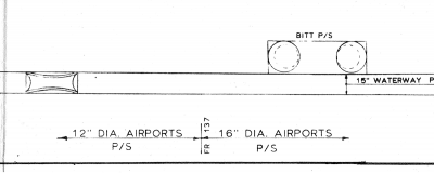

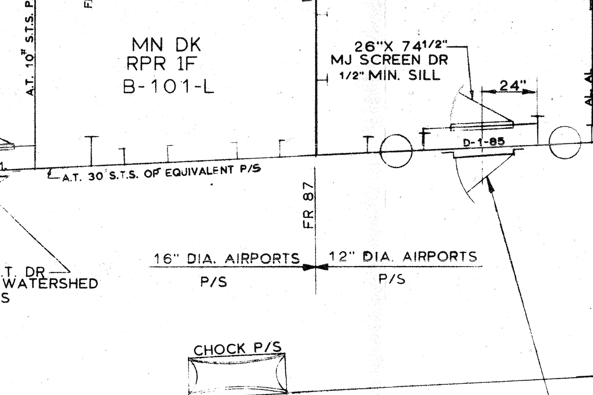

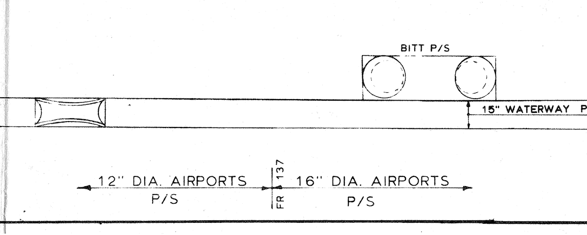

What were the dimensions of the portholes in the superstructure?
Wojtek
bigjimslade
- Posts: 463
wojtekp90 wrote:What were the dimensions of the portholes in the superstructure?
12" DIA FWD FR87
16" DIA
12" DIA AFT FR137

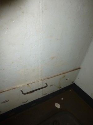

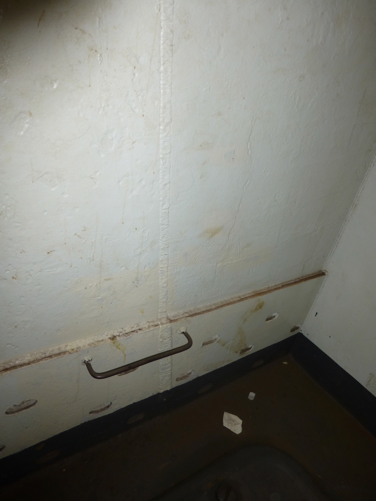

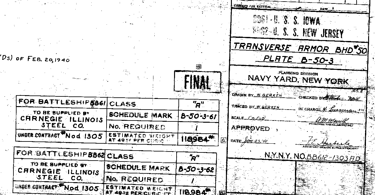

Third Deck to Transverse Armor
Because it has been dead here, I thought I'd share some more Iowa class construction details.
One of the myths that appears frequently is that Class A armor was not used structurally. While generally true, it is not totally true. One example is the transverse armor bulkheads.
The outside face of a Class A plate could not be welded because the heat would crack the hardened surface.
This image shows the inside face of the forward transverse armor (looking forward). The vertical lines are grooves for welding the class A plates together. A plate with holes was welded to the inside face. The holes provide additional welding surface. The Third Deck was welded directly to that plate. Unusually for the Iowa class there are no other supports at the attachment point.
The large deck opening is where turret no. 1 goes.
This shows the forward face of the transverse armor. The seams between the armor plates (angled but close to vertical) have slots in the them Vertical supports were inserted into the slots and a beam was welded between them. The beam supports the third deck.
An L-bar was welded to the the third deck on the upper side that butts up against the armor. The L-bar is not welded to the armor.
Note that the third deck takes a large step down at the armor. The step is not visible because there are no openings in the armor plate. The Third deck shelf runs outside the citadel on both sides. At its forward end, the shelf joints the third deck flush. As it moves aft, the shelves descend below the third deck.
- chuck
- Posts: 3384
I think the armored transverse bulkheads at the ends of the citadel are made from class B armor. Class A armor is typically used where armor piercing shells have a good chance of striking at a high angle of 60 degrees or more.
bigjimslade
- Posts: 463
They are definitely Class A.chuck wrote:I think the armored transverse bulkheads at the ends of the citadel are made from class B armor. Class A armor is typically used where armor piercing shells have a good chance of striking at a high angle of 60 degrees or more.
I climbed down there today for the first time. Different from the plans (and my rendering), the openings are staggered and oval shaped.

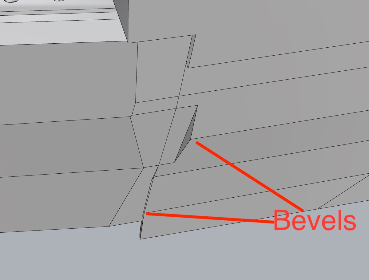

Armor Over-engineering
There are a number of places where the engineers went crazy with unnecessary complexity in the Iowa class. Here's one that took me a couple of months to sort out.
The Upper Belt ends at FR166. The Lower Belt plates have a different configuration aft of FR166 than forward. Aft they are 13-inches at the top. Forward they are 12.1". Due to their configuration, the aft plates are thicker than the forward plates at their top and bottom while the forward plates are thicker in the middle.
The plates were welded together using scalloped straps on both sides. It was felt the joint needed to be flattened. This illustration shows what they did. At the top, the aft plate was planed even with the forward plate.
In the middle, both plates were planed down (it would have been simplle to just have planed the forward plate). The edge created on the forward plate was beveled.
At the bottom the aft plate was planed then beveled down to the forward plate.
In the middle area the strap welded over the joint is forward of the bevel. In the bottom area, the strap has to be shimmed.
A) They could have welded the two plates together directly (which would have been stronger than what they did).
B) They could have shimmed the entire joint and skipped all the planing.
C) They could have done a lot less planing to even things out.

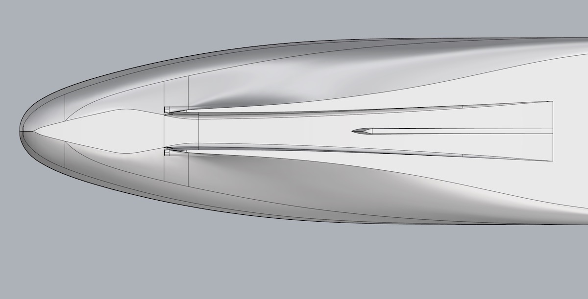

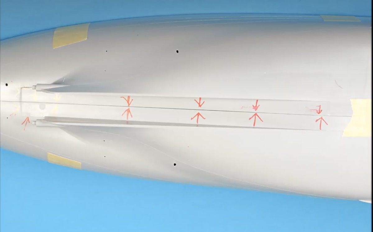

I saw a video review of the Blue Ridge 1:350 Missouri. Here is a screen capture from the review showing the stern bottom and above is my computer rendering based off the original blueprints.
- chuck
- Posts: 3384
Yes, the tunnel widens near its front, and there is a docking keel along the midline.
Another often missed subtlety is the real hull has two clear chines, one about 1 strakes below the deck The other just below waterline.

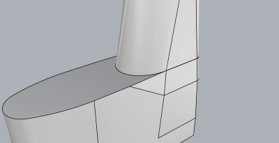

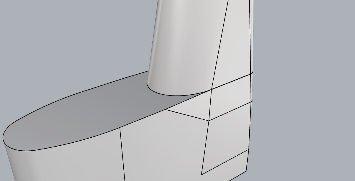

Here is another error that appears in every Iowa class kit I have seen. This is the forward director tower at the 08 level with the rarely used conn position. I have reproduced the kit error by extruding the stack base shape up to that level.
In reality, it starts to bend inward at the 07 level. The yellow lines show where the structure should cut in. This creates a triangular facet that is visible in photographs. The tower is shown in red. There should be a continuous taper with the red surface; not a step.

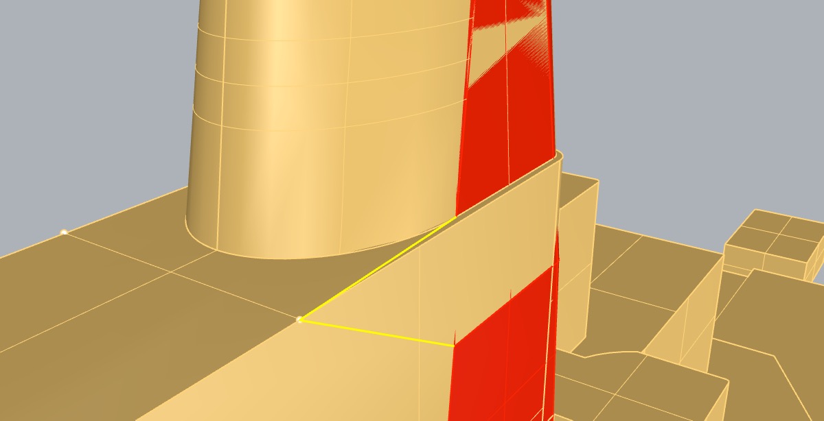

bigjimslade
- Posts: 463
Here is what the tower should look like�but never does in kits.
