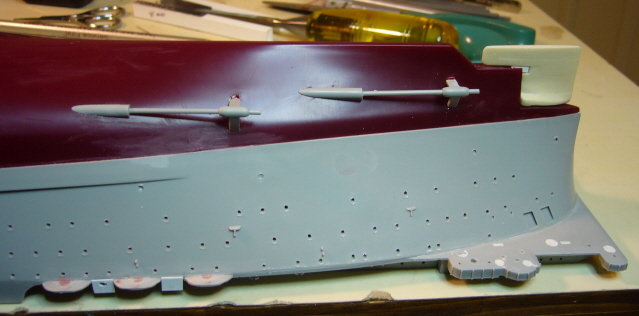

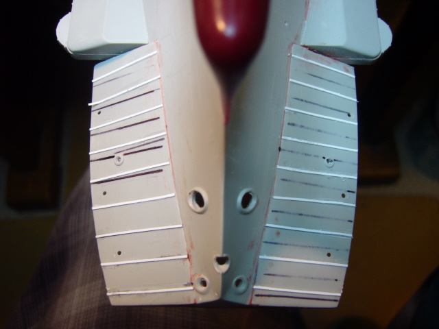

I've been piddling and trying to get some things at least to the point where I can say "that part is done!" Hah!!!
I got the PE grills on the stack and painted the insides, also the inside of the lower piece it mounts on, a flat black. So there is at least one thing I can look at and say done.
I'm pretty much satisfied, after much filling, sanding, fine finisihng and wet sanding, with the hull to get ready to apply the red paint on the lower section. Trouble is I'm not satisfied with the propeller shafts, they have a slight sag. So later today it's off to the hobby shop for the correct size of brass rod to replace that part. After the shafts are cut out, the supports drilled and glued on, I can remove the shafts and then paint the bottom.
After comparing the splinter shielding on the gun mounts with what I found in the info yesterday I think I have enough to at least make an educated guess as to how they were done and will proceed along that line.
As for the guns themselves I haven't quite decided yet how I'll do that but I do like the way Chris's quads came out. Having said that I guess I'll now have to get some more PE, this time from WEM, but that gives me a chance to again talk to Randy so I guess it's not all bad.
My paints arrived also but that now means I have to get my airbrush operational and learn to use it so there is quite a bit on my plate for now. Fortunately I have a couple of friends who are into that part of it, they do cars mostly so do a lot of it, and of course are willing to tutor the new guy.
Back to the salt mines.

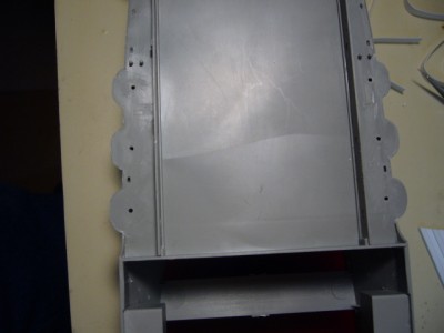

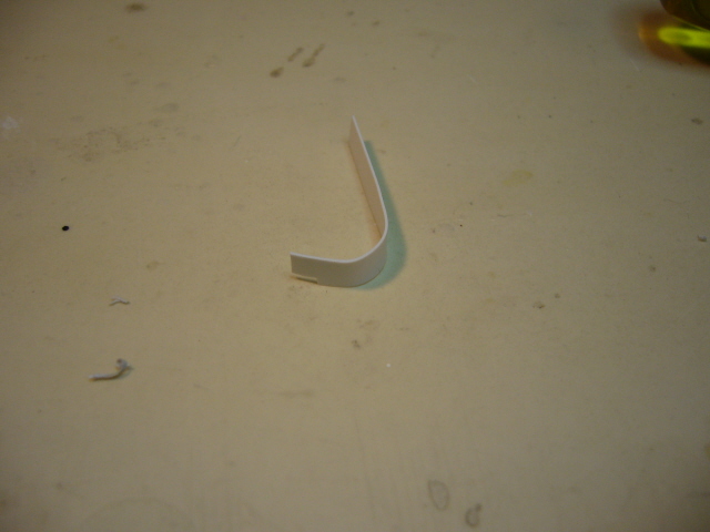

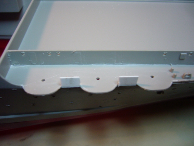

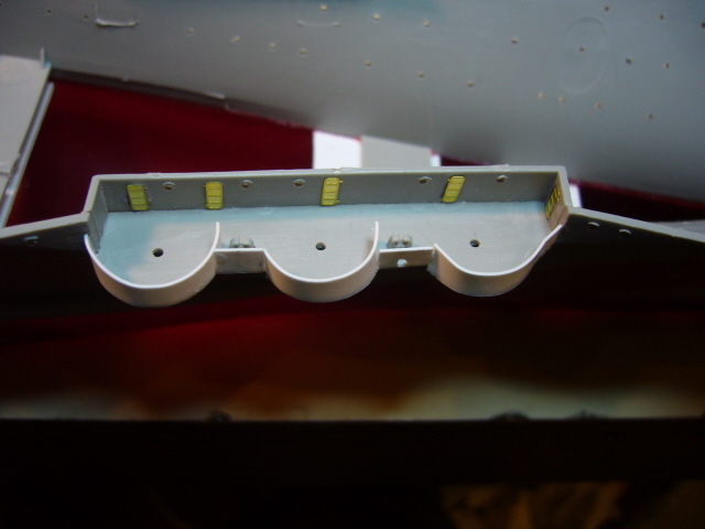

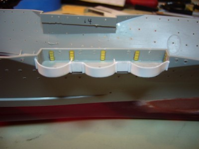

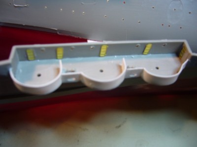

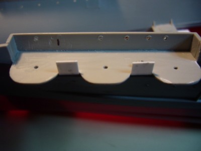

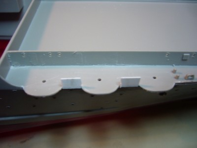

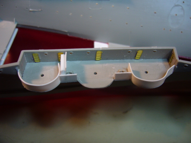

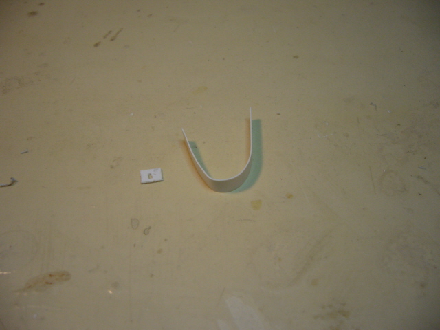

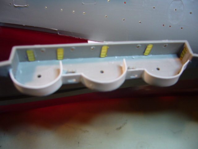

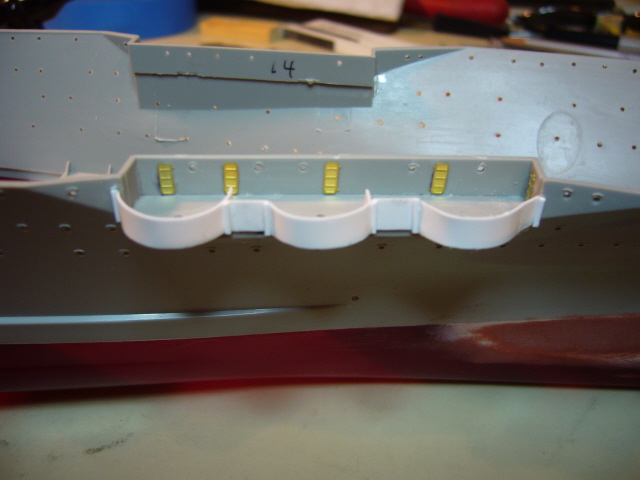

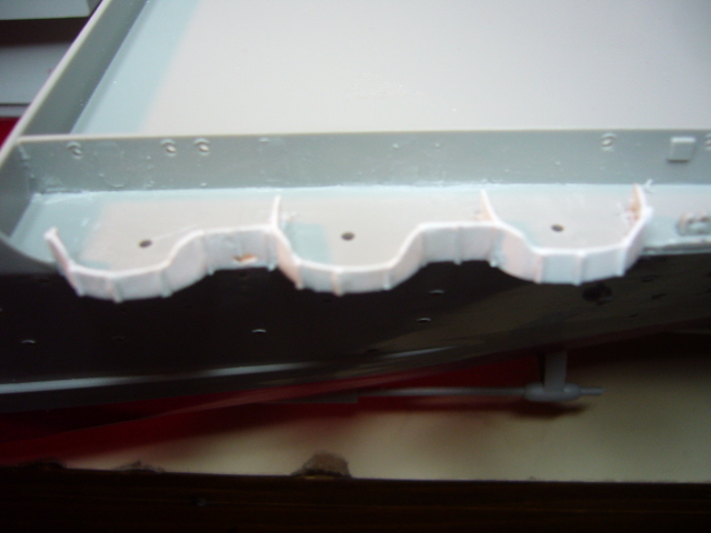

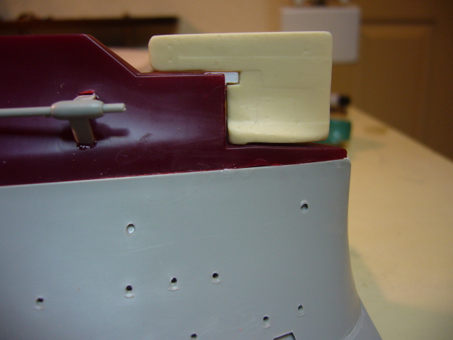

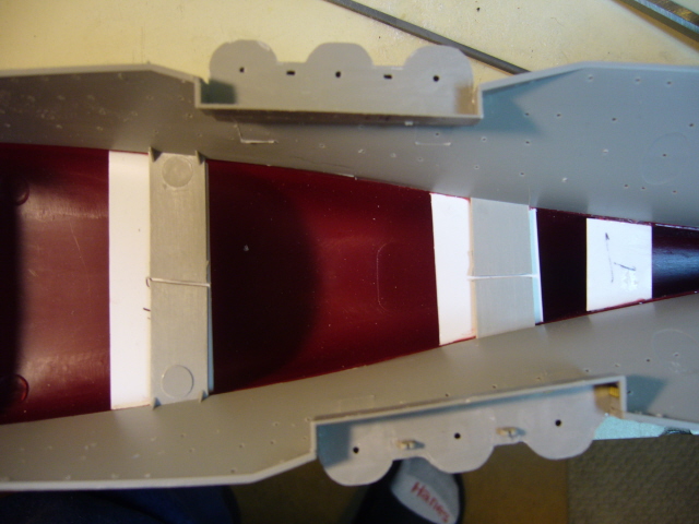

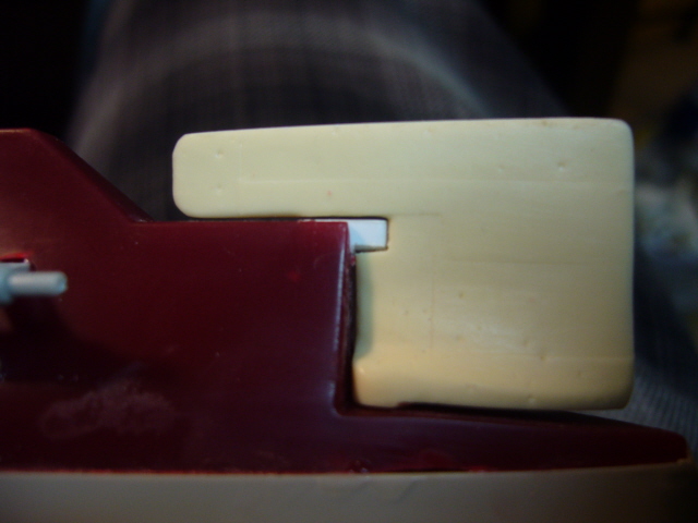

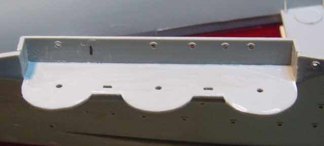

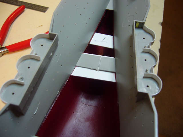

Still haven't made it to the hobby store but I have been busy. After puttering with the hull I think I'm satisfied with it overall. So I made a command decision and decided to redo the splinter shields on the 5" guns.
The first thing was to cut out all the existing ones and have a clear place to start. Then came the problem of making the new ones and getting the curves right and glueing them in place. Not an easy task as there is no way I could see to clamp them other than fingers! I was using stryrene strips, and they are flexible but do not hold a shape if you just bend them so I used heat, from a handy hair dryer, to accomplish that task.
I started by clamping the strip around an appropiate sized dowel and using that so my pinkies didn't get singed. It worked, sort of. It wasted a lot of strip because the clamps distorted the strip beyond the dowel. By accident I found I could just set the clamp to the correct distance, bend a piece of strip in there, heat it and let it cool, and voila! I have curved plastic!!
Now to get the little bugger to fit!
I made a small notch on one side so it could slide back on the deck. This located one end and made it a little easier to hold the whole slippery thing in place until the glue got a little bit of a set. Then it was on to making the cut at the other end and getting it right. Trying to measure around the curve was more than I could do so it was make it long and slowly creep up on the correct size then glue it in. Because it takes so long for the pieces to set, even the next day they are still a little wobbly, I could only do so much and then had to let it sit.
I am putting them all in at the same height, approximately where I think the high points are and will then cut down the lower sections, getting in the sloped and curved parts, when it is solid. I didn't see any way to do this before they were on the model.
The pics show how the sponsons are cleared and then how I proceeded. You can see in some of the pics that the rounded shield goes back where it is not needed. I did this to help in the glueing and then cut them off when they were set.
Then there are the fairleads to deal with. There had to be holes in the shields to allow lines acces to the bollards behind. I decided to put holes where I thought appropiate. There are a couple of them visible in one photo of bomb damage but since I am going totally off the wall with this I'm doing it as I think it was and so it is , until something definitive comes out of the woodwork anyway!
In the final sequence of pics I show how the last one was formed and glued in place. Starting with the rough strip, then the different stages of cutting and forming, and then in place.
Enjoy

Jim -
Good work! I've been poking around getting some ideas for how I'd deal with those splinter shields and came up with pretty much what you've done. A few days back, Tracy posted an item on the General Forum showing SAN FRANCISCO's Guadalcanal damage report with photos. Toward the bottom of that very extensive number of photos was a picture of one of her 5" / 25 cal guns taken head-on and from several feet above it. It shows the notched out areas to allow the gun barrel to depress for close-in targets as well as the raised sections between the adjoining 5" mounts. I am sure the raised sections are to protect crews from enfilading splinters so that you wouldn't get all three crews with a single set of splinters. The picture in your 5" / 25 cal link shows this same protection on NEW MEXICO with good effect. I think the NM photo is a near perfect duplicate of the LEX arrangement, though the LEX shields appear to be perfectly circular whereas the NM ones are more elongated as found on pre-war heavy and light cruisers (NORTHAMPTON, BROOKLYN, SAN FRANCISCO as examples).
As a quick note, the holes in the splinter shields through which the lines are passed to the bollards are horizontal slots with the ends rounded. Basically shaped like a link of an anchor chain. I'll see if I can find a photo reference to help you.
Ship models are the product of lots of small details. My hat's off to you for tackling this detail - one often overlooked. Be sure to ask me about the spreaders on the main mast - they're lattice work (similar to those on ARIZONA), not solid as on the kit . . . (psst - I know what PE fret has the right sized parts that can be used) . . .

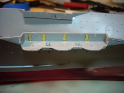

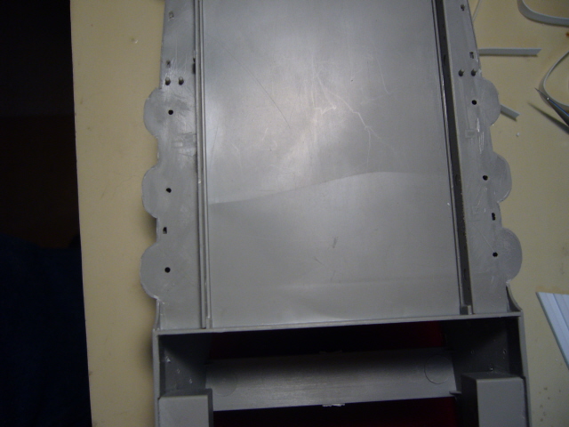

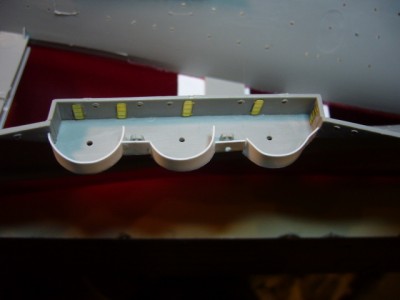

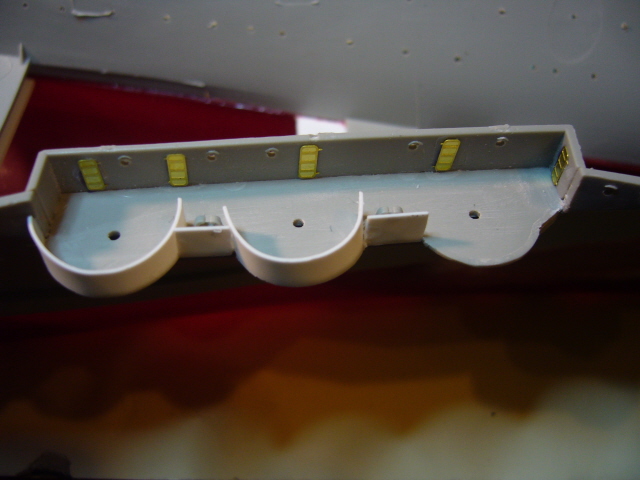

After all my hard work I got a private attaboy and also a heads up that I was just a smidgen off. It seems the platforms were not exactly circular but slightly elliptical! After looking at the appropiate pics I had to agree.
So it's back to square one, almost. At least now I have a system that works, it just has to do some that I already thought were done.
Oh well, I manned up and removed what I had already done, filed and sanded the platforms to the correct shape, and now it's time to begin anew.
Hopefully this time it stays.

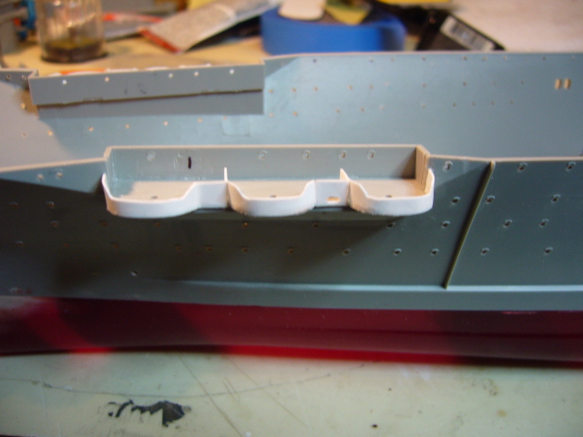

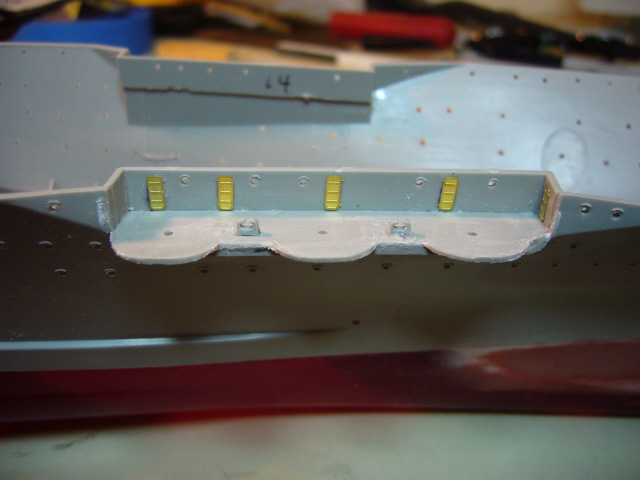

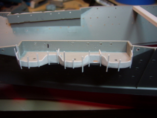

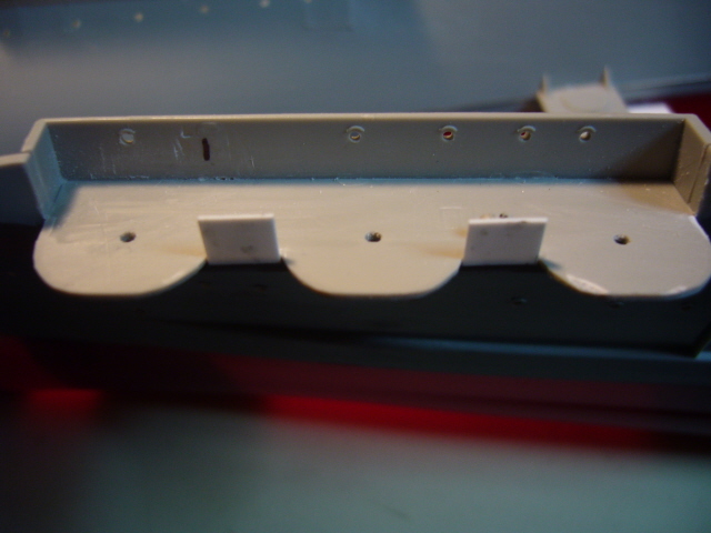

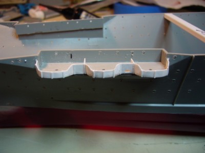

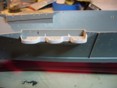

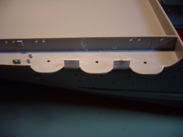

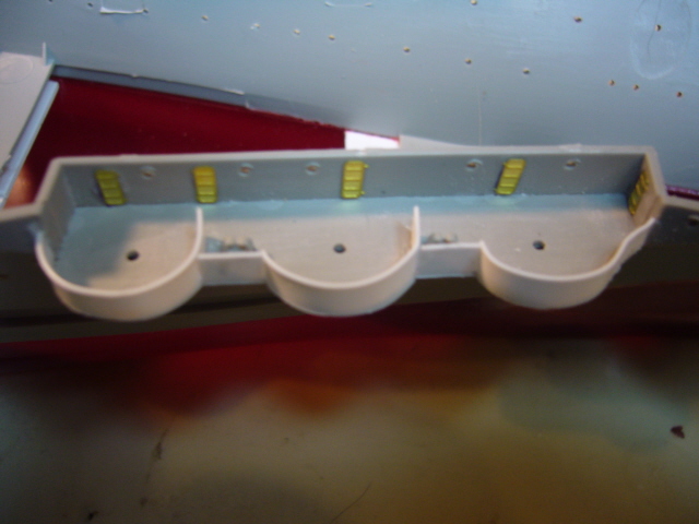

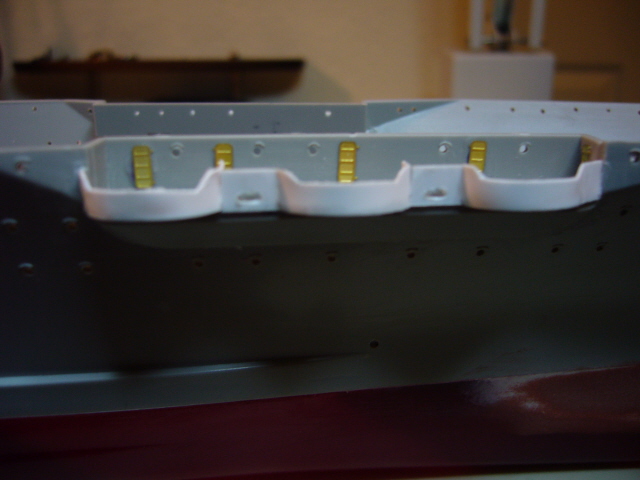

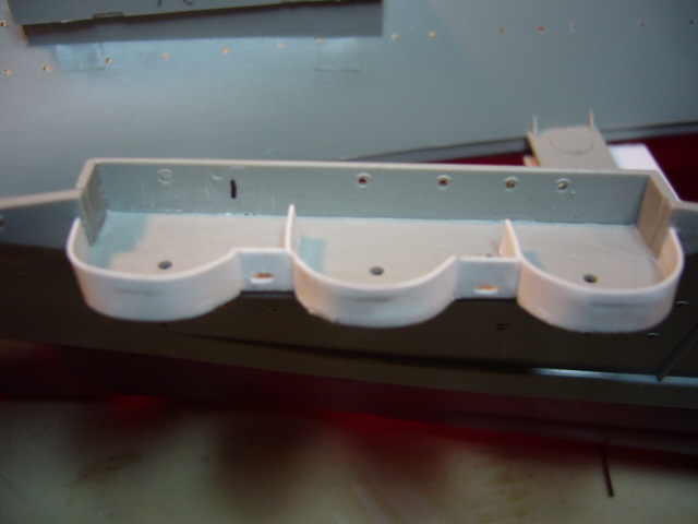

So I removed the splinter shields I had put on, flattened the platforms, and then started installing the shields again.
I first put the small pieces on the flats between the gun positions as this gave something solid to work against as I put the curved pieces on. I would put a long section on one side to divide the sections and then one side just long enough to go by the flat piece already installed. I put glue under the one that would stay and not under the short one that would later be cut off. I had to let the flat pieces set for a day so they would be solid. Then it was on to the round pieces.
In one pic you can see the pieces I used as a wedge against the fairlead to hold it's shape while the glue set. I learned I could avoid this by bending a crease into the styrene. This let the straight section line up and it only took a little time holding it till the glue got some grab.
This morning I cut the holes for the lines to access the fairleads but haven't fabricated the bollards the lines would go to through the fairleads.
Also I filed and sanded the shields to make sure the joints were square and crisp. Once the supports, I really don't know what to call them but they are pieces of steel that stick out from the shield in a regular pattern, are in place it will all look crisp.
The line holes are a little bigger than I like but I haven't anyway to make them smaller. If I use a smaller drill bit I can't clean up the hole and it's really ragged so I guess I'll live with it as is.

OK, I lied, or at least fibbed a little. I couldn't just let it be so I tried a little different way to make the holes.
I first sized a drill to match the space in the fairleads, figured this was an easy way to scale it, chucked it in my cordless Dremel, and proceed to clean up the existing holes, and also replaced 3 different sections and then redrilled them.
Also cut the shields down as I thought they should be.

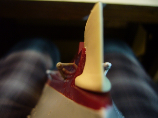

While waiting for the shields to set I also mounted the rudder and shafts. I intend to remove the plastic shafts and replace them with brass rod, not because they are out of alignment or shape but just because that's the way I want it to look when done.
The rudder came to me as a one off, resin casting of what the rudder actually was, so I accepted it and here it is. It only has a place for one hinge. I glued up three small strips of styrene to get the thickness then cut out a groove in the hull and mounted it. After it had set I cut and filed it to shape and then mounted the rudder. Then it was each of the shafts. One other reason for using brass rod is the PE props have a hole slightly smaller than the plastic.

Well I finally made it to the hobby store and ended up going to both of the ones I use here. It seems that one didn't have every little thing I need, and some of the styrene strips are really little and thin, and I still had to have them order in some tube. These are pics of the shielding as it gets to finish stage. Having the small strips I could now get the stiffeners on. This is only one side and the other will come soon, but no more pics of that as these are enough.
I also added the seams that show on the sponsons for the flight deck widening. Ignore the dark lines, they were the first way I tried to get all those fine wispy lines to align but it didn't work quite right so I removed them and started with the front one in place and then using a spacer, a strip of styrene, to align the next one. The strips seemed to want to glue to the spacer and not the ship so that was tossed as non-effective. Then I clamped the spacer in place, used the point of a #11 exacto to scribe the line, and then carefully laid the strip on after dragging it lightly through some glue. This seemed to solve the problem but be aware it was like handling a hair in the wind and a real pita. But it's done so now there's one less thing to do. Of course fifty more pop up but that's part of the fun.
The actual pic I used as reference came in about 3 pixels aver the limit here on the forum so had to shrink it even more but it's the best I can do.
- The rough form on the port forward sponson
- Splinter shields redux 020a.jpg (37.15 KiB) Viewed 5304 times
- What I am depicting
- scan0001b.jpg (39.61 KiB) Viewed 5293 times
