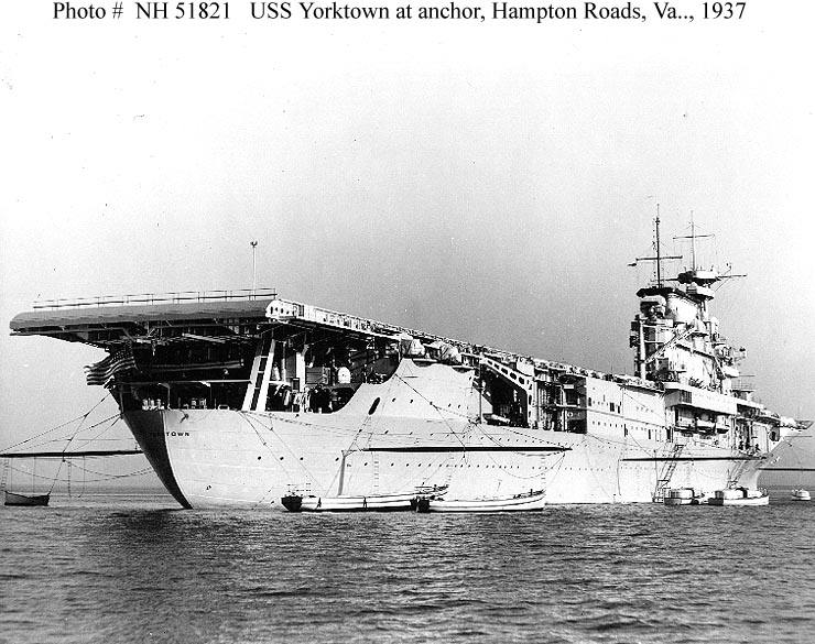

Question, for the rear flight deck supports, are they on the edge of the stern, or a couple feet away on both side? Im having a hard time with the above plans...
If I understand your question, you are referring to the vertical beams supporting the fore / aft girders under the flight deck. Here are pictures that should answer your question. The rearmost pair of supports are angled outward, the forward pair are completely vertical. There is a picture of HORNET in drydock taken from directly astern of her that shows the angle of the supports very well. It is too big to attach here, but you can find it in the navsource photo index under HORNET CV-8.

JTninja wrote:^Thanks, great reference!
The two flat outer panels run flush with the hull and have a twist to them. This should help:

Thanks for the help guys! It was about the rear supports, I have last 2 pictures, but I couldnt tell if there was any walking space between the beams and the side of the stern. Im scratch building these, since my Revell kit isnt by any means accurate in this area. Ive seen models go both ways (lol), so I thought Id ask :thumbs_up_1:

Check the shadow on Mike's upper photo. The shadow of the flightdeck covers the extreme stern and angles up along the hull. Note where it crosses the deckline and catches a corner of the forward support. The shadow edges line up perfectly. The support is not inset from the deckedge.

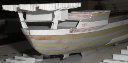

Okay, I did a mock-up. Stills needs a bit more detailing, like the horizontal bars, but so far it fits well. Hard to tell, but towards the top, the main bars change direction and go straight up.
Comments? Good enough?

Bump so all the Yorktown carriers are at the top :woo_hoo: :big_grin:
I circled in red the forward rear supports. I can't find any more clear pictures of them, perhaps someone can help me figure out what they look like? Its hard for me to tell, so I dont know how to produce them...
JTninja, go to the online CV-5 plans http://www.hnsa.org/doc/plans/cv5.pdf and flip to pages 8 and 9, zoom in of the fantail. You will see the locations and cross sections of all of these support beams.

Thanks, Ive been using it a lot, but was wondering if there was a picture of it. The drawings show the farthest rear beams as straight lines, but in the above pictures you can see the differnt angles they have. Ive since gone back and somewhat correct these beams...
