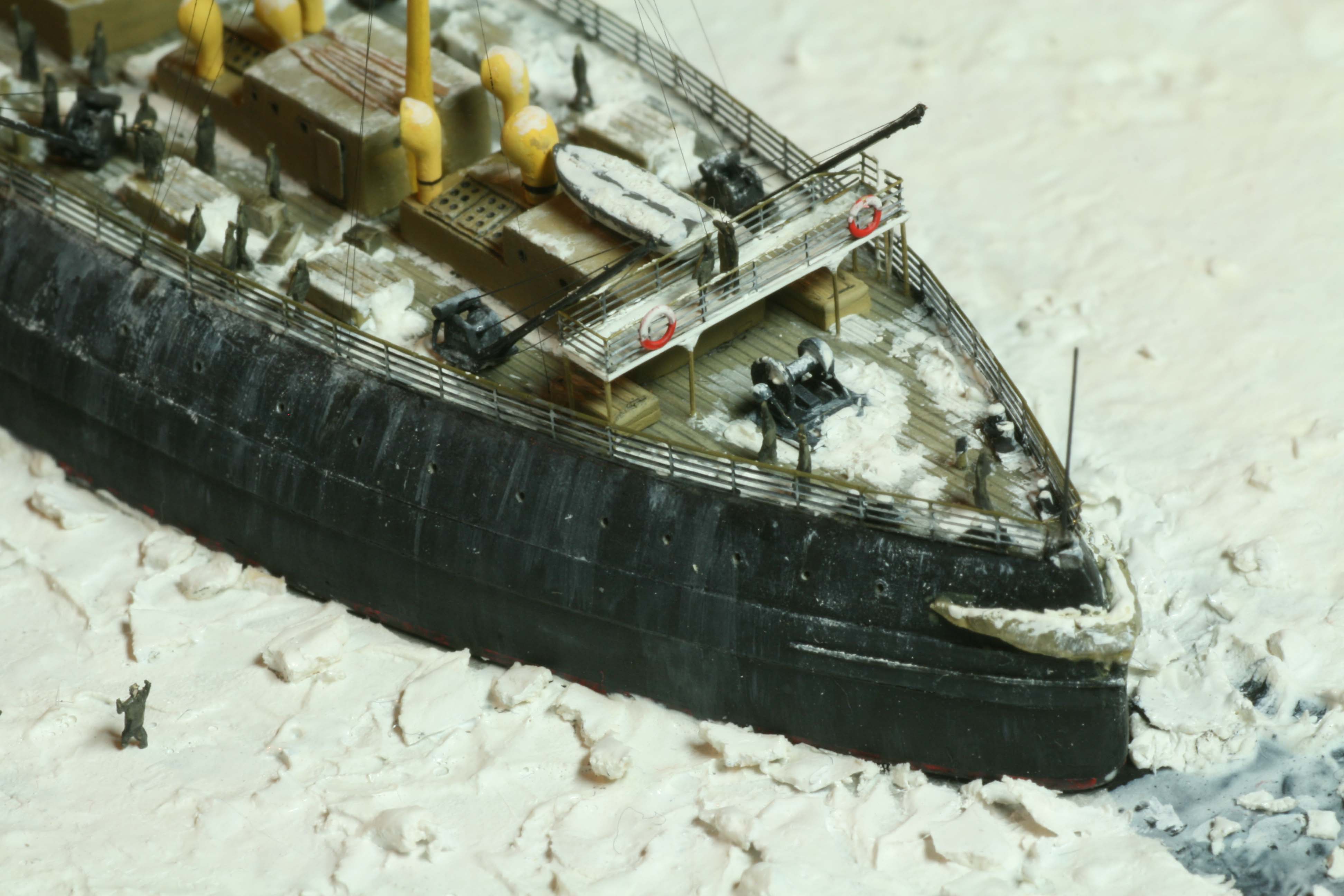

- JIM BAUMANN
- Posts: 5689
Re: Making Snow??
Hi Carl!
sorry to weigh in late....
I used in my Krassin Icebreaker =- 1/700 scale-- Windsor and newton acrylic white medium matt fine ground
all images here:
here is a brutally large ( remember its 1/700!!!
) photo showing a really close up of the snow effects...
on boat-covers, swept and cleared walkways on deck etc etc
click below on link
and then click on the image again to enlarge biiig!
http://www.modelshipgallery.com/galler ... in_018.jpg
hope it is of help or interest.

Re: Making Snow??
Jim,
that is some mighty fine looking snow!!!

Thank you, Jim, for this great example! I'd like mine to turn out as realistic as your Krassin. The suttle effect of the snow, here and there, on the ship's surface is what I'll be trying to depct, as well.JIM BAUMANN wrote:Hi Carl!
all images here:
here is a brutally large ( remember its 1/700!!!) photo showing a really close up of the snow effects...
click below on link
What exactly is Windsor and newton acrylic white medium matt fine ground? At first it sounds like a brand of acrylic medium gel but, you mention "fine ground". What is it intended for originally? What type of place would I find it, here?
