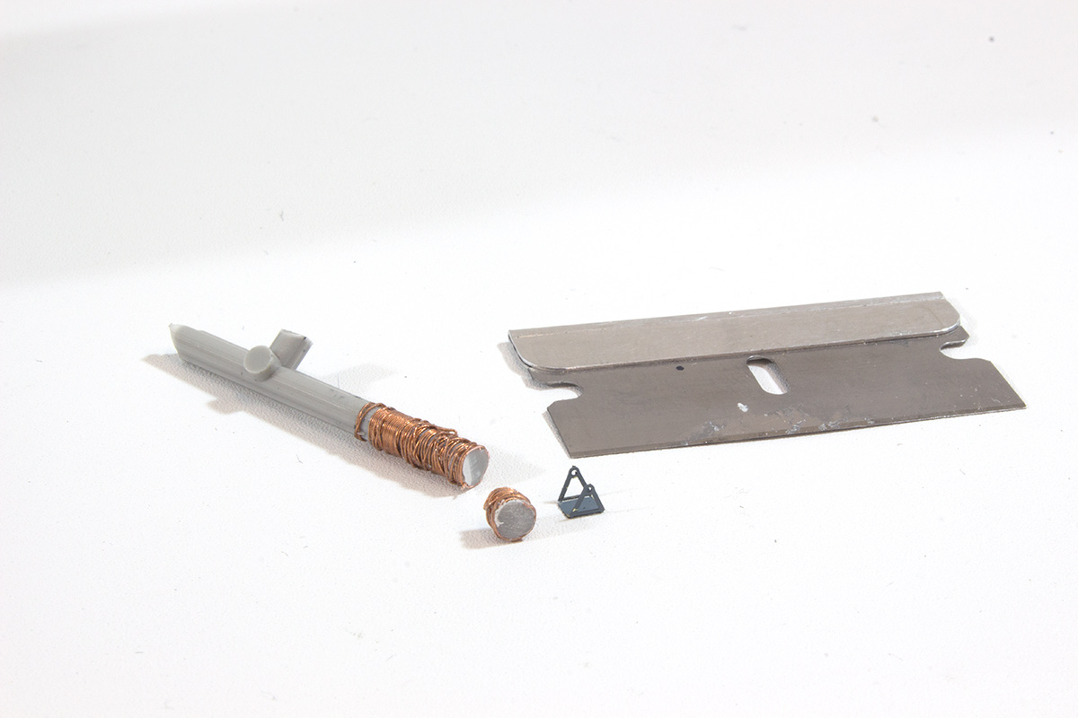

Just a quick little solution many of us use for making cable reels.

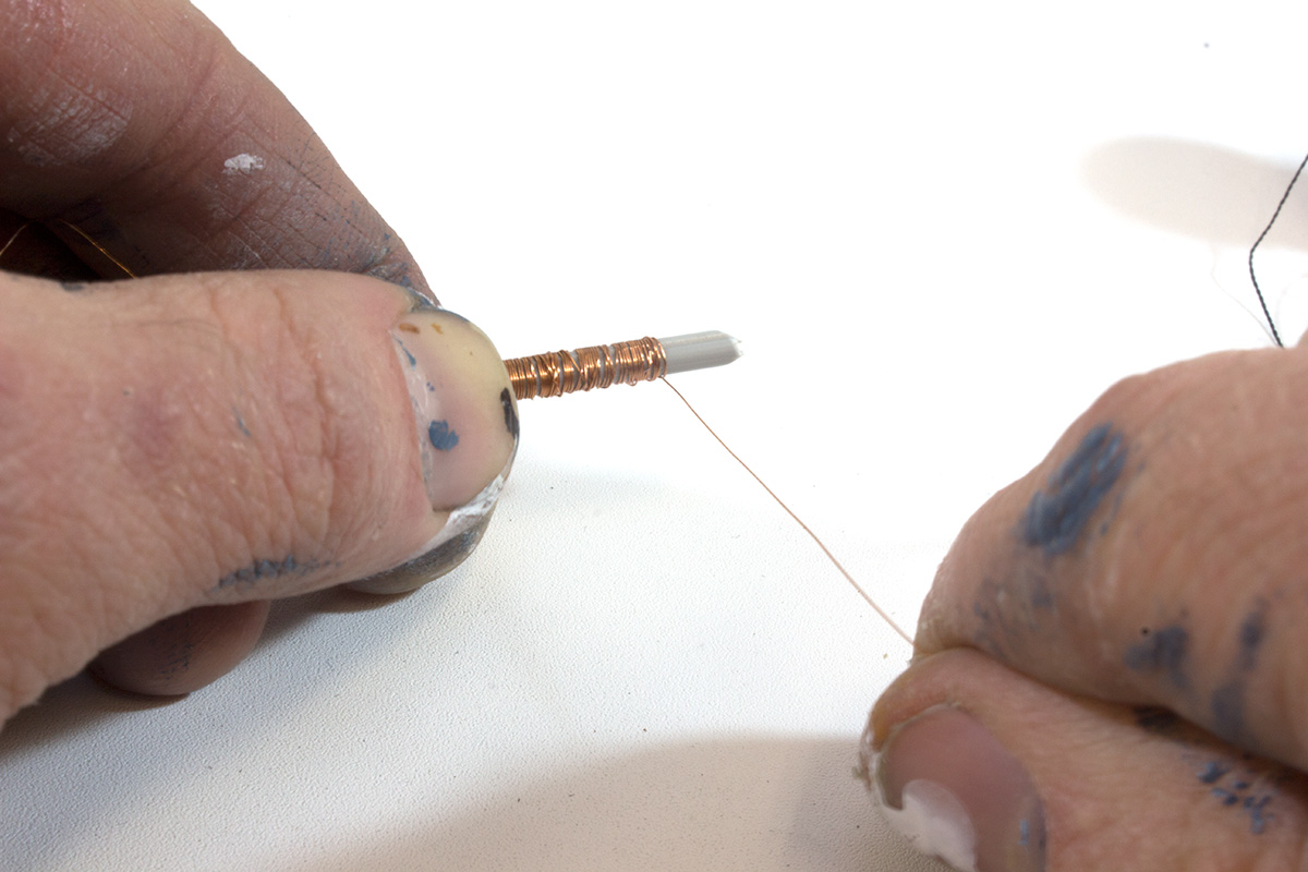

First wrap some sprue with fine copper wire.

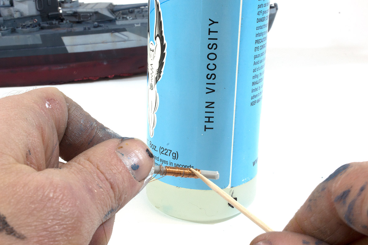

While holding the wire, touch it with some thin CA glue.  This will bond everything in place.
It's now easy to cut of slices of 'cable' at the right width.

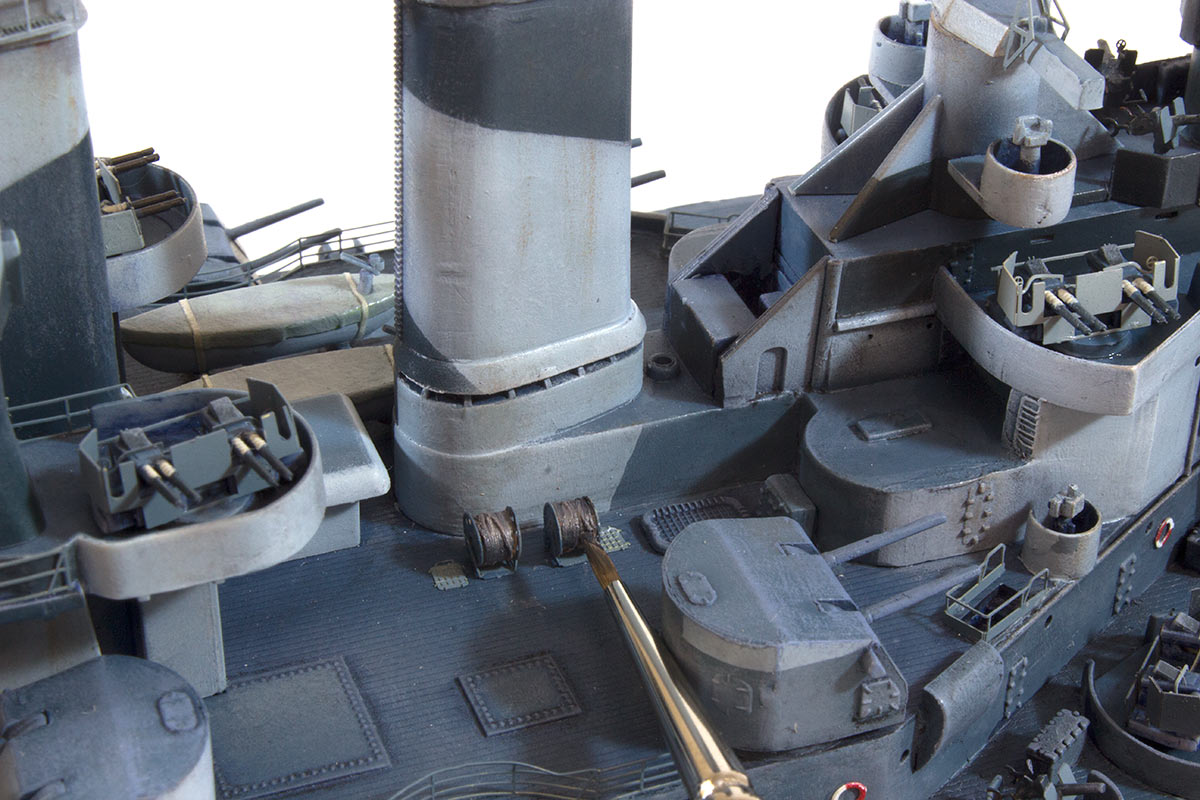

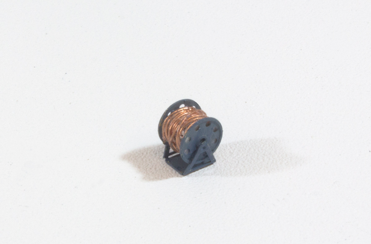

The side plates and brackets are easily attached to the cable 'puck'.
I attach the reels first before painting the cable.
