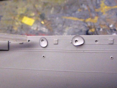

Maybe this is an old-school trick, but I don't recall seeing it anywhere. I was actually pretty irritated that I had not thought of this long ago.
Anyways, as we all know, that for drilling out portholes, you either take hours and use a hand-held pin vise with an appropriate sized drill bitt, or you use a rotary tool drill, and risk melting the plastic and having differently sized holes.

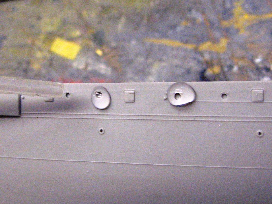

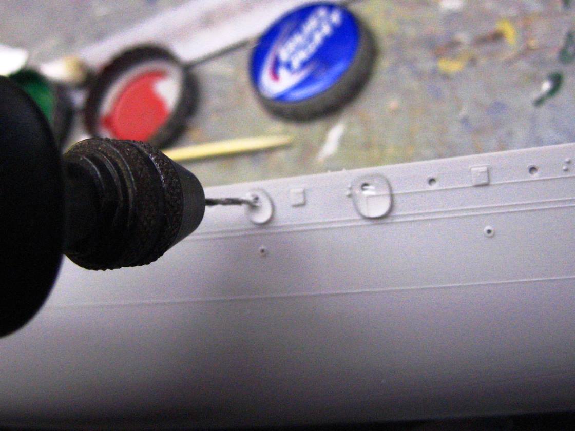

The super simple solution I came up with is just put a drop of water over each porthole, and then use a dremel (rotory tool) to quickly drill out each porthole. That tiny drop of water is enough to keep the drill bitt cool, and not melt any plastic.
I did this on the several hundred portholes on a 1/350 Dreadnought, and it took me about 10 minutes, with no melted plastic, and each hole perfectly centered and the same size as the rest.
Make drilling your portholes fast and hassle-free!

Old-school or not, it's a great tip. Although I don't like opened portholes (old-school as well, eh?), since I think it doesn't add realism...
Anyway, happy drilling ~ Olaf!

The simplest solutions.... Thanks man!
